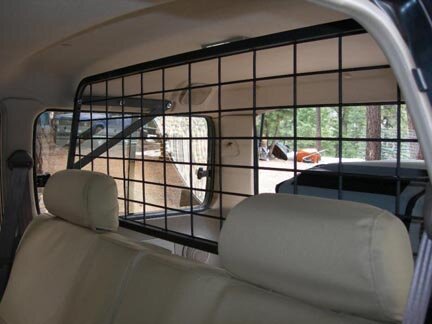

To mount it I'd do something like this which looks like it is using the handle screw holes for the 3rd row seats.

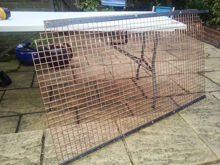

Everything laid out ready to cut the mesh.

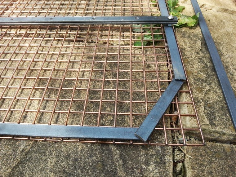

Mesh cut to size and some of the flat bar bolted on.

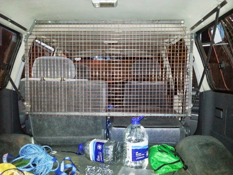

In the end I broke a few drill bits last night rushing trying to get it to a place where I can start packing the car tonight for this weekend away. Frustrating and stressful but got there in the end. Still have to take it back out to paint and clean up all the rough edges with a grinder but over all I'm very happy. The 5mm bar bolted together is proving to be very rigid and I'm happy put a-lot of trust in it.

Loads of loose ends to be cleaned up from the square cut to an angled cut.

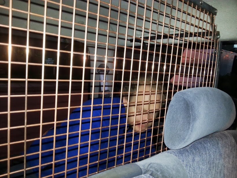

Sitting in place quite securely. The flat bar holding it up is only 3mm and is holding it in there much more secure than I thought it would be. Currently just using the existing holes from the third row grab handles. I plan to drill those out and put an 3 M8 rivnuts and bolts per side in there to make it stronger.
