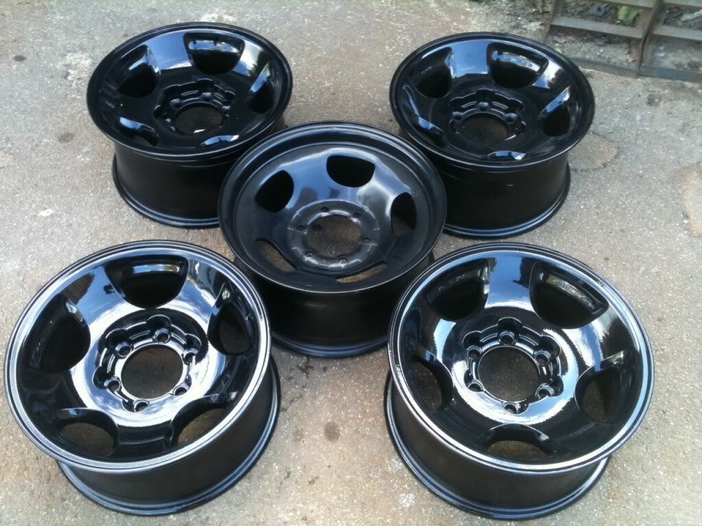

Thought that would make you look. Seriously though, wheels arrived back today after a VERY long saga. Pretty pleased with them. I reckon Judge Dredd would be happy with these!
Even the steel spare looks tidy. They have lacquered them too which I didn't ask for which makes them look very bling. I think that this will probably haze up after a bit.

hmmmmmmm :drool:
They do look nice...
What colour is that? Black or anthracite? I wanted to do mine recently and they offered the two colours in satin finish. I ended up thinking black wheels on a black car would be too much so opted to just refurb them silver.
Ooh, black on black, now that would have looked really stealth bomber!

I find the plastikote spray paint cans good and have done my wheels with satin black. It's not as hard wearing as powder coat and also I think the powder coaters shot blast and filler prime the wheels to help get the good finish which you'll have to do a lot of prep work to match doing it yourself. I started with wheels that had a good finish so very little prep work was needed. As they got scratched badly in France I'm glad I took the cheap option on this occasion.

Gotcha Dave. White logo. Paint has just reacted with the lacquer so I shall have to start over. Arrgghh.
Chris
Are you using paint or cans? I used the acrylic grey primer (suitable for bumpers and other plastic items) in a can, gloss black (not sure of the make up but compatible in a can), Red enamel model paint for the hat and clear cellulose in a can to cover. All from Halfords except the model paint.
Exactly what I used. Several coats, no problem, then just sprayed again and in seconds parts of it just bubbled up. Looks terrible. Going to have to flat it all off and start again. Will I ever get this done. Just heard that rack isn't coming today after all.
