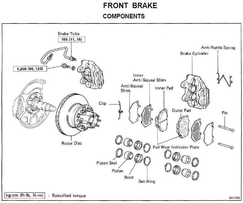

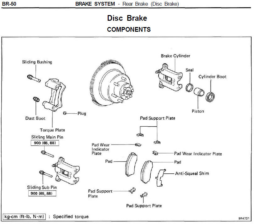

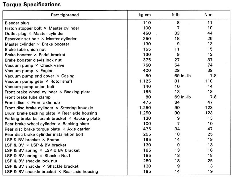

I've got the manuals for the early 80. I'll upload them to my site and post the links. In the meantime here is the torque settings for the brakes...
Brake Torque Settings.jpg Front Brake Components.jpg Rear Brake Components.jpg
Am I missing it but I cannot see front calliper to axle casing on there?
Are you referring to the bolt on the diagram going into the calliper at a torque of 90 ft-lb (123 N-m)?
I copper slip every bolt that comes off. Bolts this size I allways nip up with the 18" bar. Never had a problem.
It doesn't seem to be in the list, but it's there on the exploded view.
