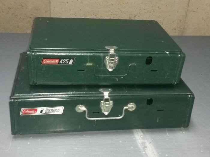

Hmmmmm......Just had a look at my Coleman and it has a higher BTU rating than either if those. 11500 main burner and 9500 secondary burner. The overall size is slightly smaller than the 'standard' version in the link but the burners are huge. It must be well over 10 years old now. It's this one...http://www.touring-gear.com/products/Coleman-2-Burner-Dual-Fuel-Stove.html The chromed grid glows red hot when the burner(s) is on full blast and melted an aluminium pan on it the second time I used it.
Yes there does seem to be some confusing data here. But, they're all good. So no worries.
