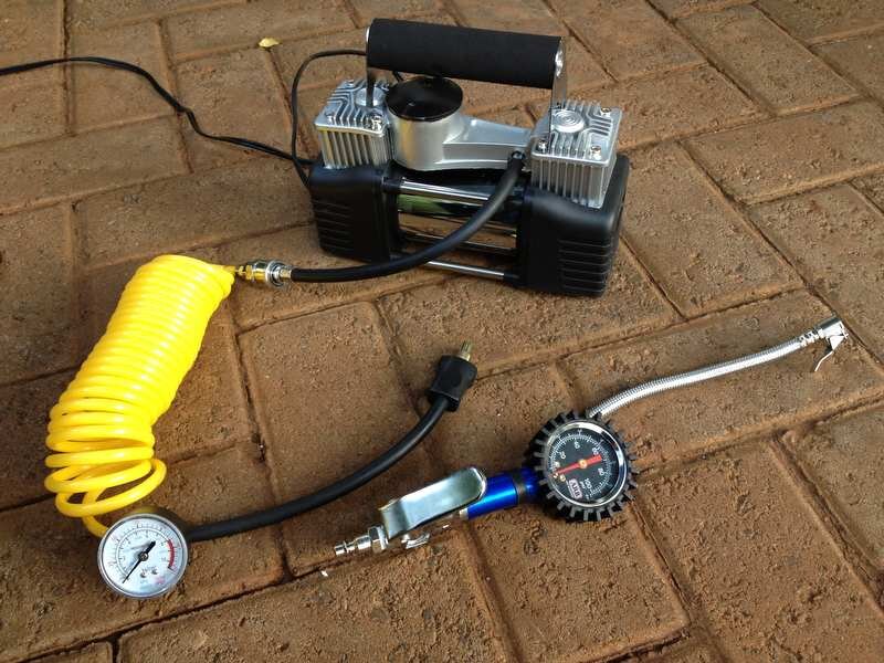

Hi,
So I bought a cheap chinese-made compressor. It's a dual-cylinder type and the specs are quite good (150lpm). I don't expect it to last forever but it's quiet and fast and I'm fairly happy with it.
http://www.alhariri-dxb.net/uploadedFiles/1319527867046-3995.jpg
However I didn't like the gauge and tyre attachment, so I bought an ARB gauge hoping to add it to the compressor line:
http://store.arbusa.com/ARB-TIRE-INFLATOR-WITH-GAUGE-ARB605US-P21342C9.aspx
The ARB gauge only releases air when you depress the lever, which is fine, except now I've learned a bit more I realise that my compressor doesn't have a pressure-release valve. Which means, I think, that if I attach the ARB and have the compressor ON but don't have the lever depressed, then pressure will build up until something blows, which is obviously not good.
The difference between the inbuilt gauge and the ARB is about 5 PSI (!!) and I think the ARB is correct, so I don't really want to use the inbuilt gauge. What are my options?
1. Ditch the ARB and use the inbuilt gauge, compensating for the difference.

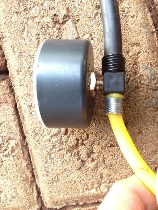

2. Cut the line in the yellow part before the old gauge and attach the ARB.
3. Cut the line after the old gauge and attach the ARB, having two gauges.

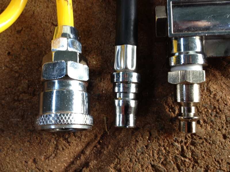

Whatever way I attach the ARB, I have the problem of pressure building up. Is it feasible or worth it to try to add a third-party pressure release release valve to make this setup workable? Anyone know a source for these? Could I add it inline to the line itself, or how would it attach? I don't know what fittings they are - the ARB came from USA so is I presume a US fitting. Or could the pressure release valve somehow screw in to where the old gauge is?
Have attached some pictures to illustrate.
Part of me wishes I'd got something like the TMAX, but where I am the TMAX 72lpm (50 quid in UK) costs over $200 and the 150lpm model over $300, and I didn't want to spend that much, while the compressor I got was around $70.
Thanks,
Ben

Don't put in a release valve, put in a pressure switch and connect that to the power source so that the compressor clicks on and off. Screw that directly into the compressor. Then control the power with a relay.

VIAIR are 1/4" NPT fittings. Not to be confused with BSPT, but very similar.
You can do it on a portable, yes. No more wires really than you have now, other than a couple of thin ones to a relay that you'd mount on there somewhere. I have done this on mine. One switch controls twin pumps into a tank. You'd still be relying on pressurising the line to trigger the switch though. Not really the best. But it'd work.
Cut the live feed to the motor, insert a relay. Put the pressure switch in a Tee on the compressor and use the pressure switch to control a small live feed to the relay. I just slave one off the main live to the motor seeing as it needs to be portable.

I've converted all of my gauges and fittings that came with my T-Max to PCL closed ones and just allow the mechanical pressure release to lift and blow off when the pressure in the pipe and fittings gets to high. The fittings that are supplied with most of the cheaper portable compressors as my T-Max and your one there Ben are an Ozy standard fitting called Nitto. Due to the current that my compressor pulls it all ready has a relay built into it to enable the operation of the ON/Off switch and I would not be surprised if the same wasn't true for yours. Matt Savage do a good range of pressure switches http://www.mattsavage.co.uk/acatalog/Heavy-Duty-Pressure-Switch-90217.html and fittings http://www.mattsavage.co.uk/acatalog/copy_of_copy_of_Compressor_Fittings.html if you want the compressor to automatically turn on and off when in use.
