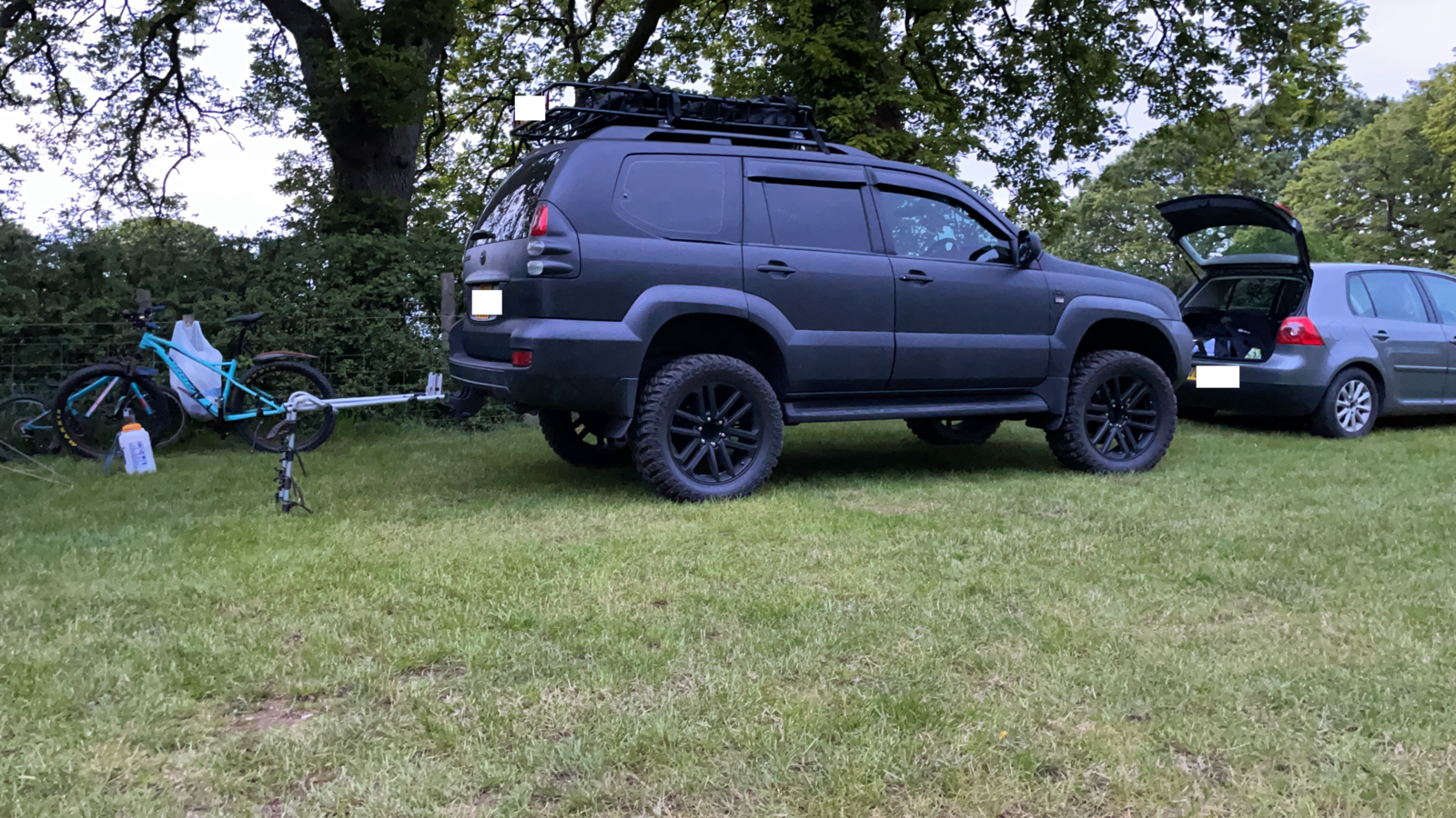

this is what I went with in the end, 305/50/20. I think they look fantastical lol. there's enough profile on the tyres for off road use. I dont like the atrac system, its just too slow to kick in when you need it and could benefit from a rear diff locker.

I had 265/65/17 J7.5 from stock and changed to 305/50/17 J8.0. Toyota make some 20inch alloys. I was fortunate to find a set. They work really well, i can drop pressure to 21psi when off roading without creating tyre roll.
