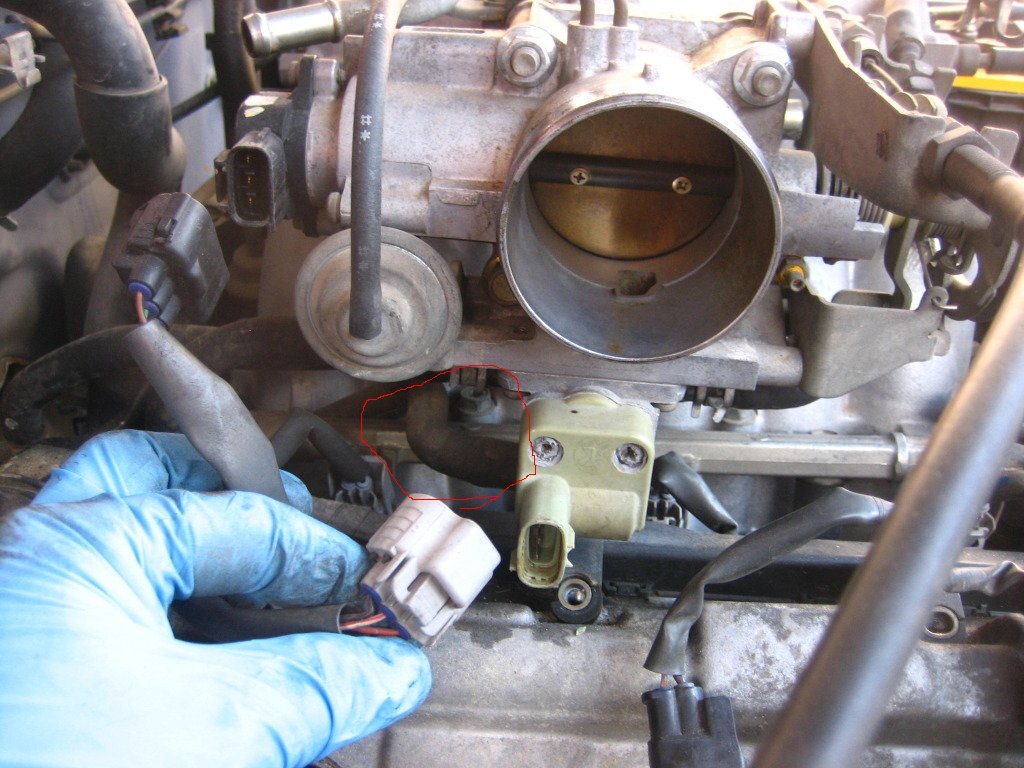

You can see the hose in the red circle. I inadvertently disconnected it while pulling out the throttle body and now I cannot find what its far side is supposed to connect to. Where does it end on your trucks, guys?
Very difficult to see on mine as there are so many pipes in close proximity. My best guess is the one that terminates above cyl 6 spark plug on the base of the lower intake plenum. Hope this is not a duff steer.
Its possibly the throttle body coolant hose, there should be two going to the throttle body one inlet and another outlet, its to warm the intake air in cold weather. to prevent the incoming air being to cold and not mixing so well with fuel.
