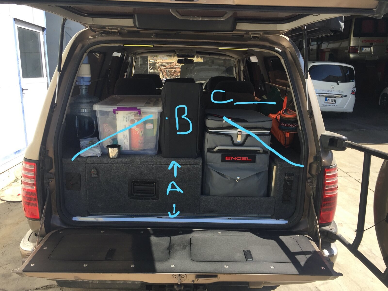

Hey not sure but are you asking for measurements up to the top of the tailgate when closed?
My draws as a reference are out now but this is how I get mine up.
Oh hi Mike. Nah the measurevent I need is if you sat in the back seats facing the inside of the upper tailgate. If you put a ruler at the top of the back seats roughly 75cm off the floor of the trunk would that measureme t be more than 93cm. It’s fine at the level of the lower tailgate but the upper one slopes so I’m worried it’s less than 93cm
so looking at your picture if you shut the trunk/boot and measured at the height of that white plastic box that’s on the left. Is there more than 93cm from the back of the seat to the glass.
Ok I’m trying to understand fully and work with you here. Here we go….
Firstly I measured labeled (A) the height of my draws. These are 34.5cm from the base in addiction to having 3mm lining on top of my carpet.
Secondly labeled (B) is a measurement from 34.5cm up to the rear seats from the inside floor metal strip is 102cm. Having had them in a few years and leaning on the draws slightly was a line to measure from.
Thirdly I measured from roughly the top of the plastic side panels line across rear seats to the front inside metal protective floor strip and it measured 95cm (7 cm less from the curvature of the rear seats).
Hope that help you out a little.
