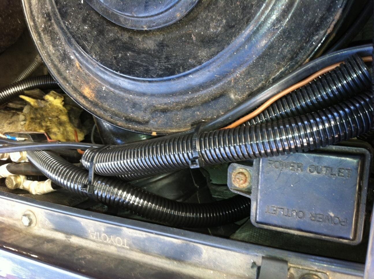

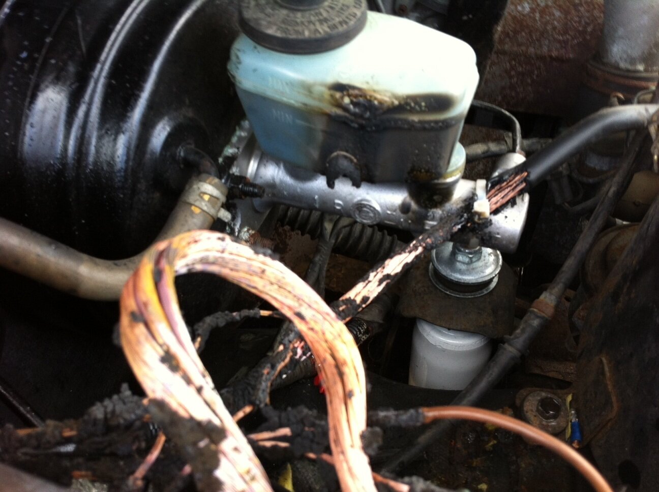

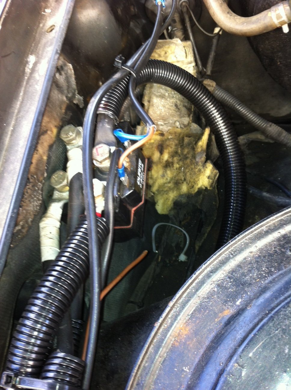

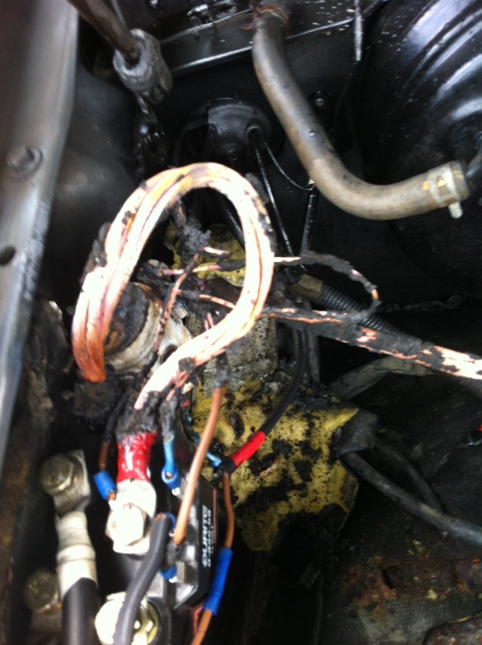

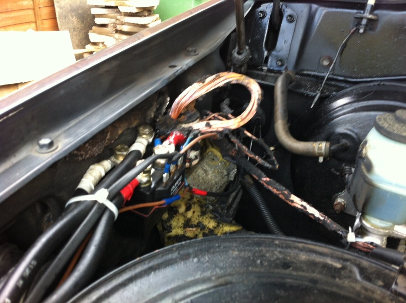

Hi all,
thought I post my Lc80 near death.
i refer back to last week whilst dozing in my favourite chair on Saturday afternoon I was awakened to a loud knock on my window, a very distraught virgin media man shouting your truck is on fire!!
Ran outside to find smoke pouring out of the bonnet, I checked to see how hot it was grabbed my fire putter out er, lifted the bonnet and put out the fire.
this is what I saw
i had made the mistake of cable tying the main power feed cable for the winch on the brake master cylinder so it was safe and out the way, can't believe that it rubbed through within 3 weeks.
I have learnt my lesson and belt and braced my second attempt
