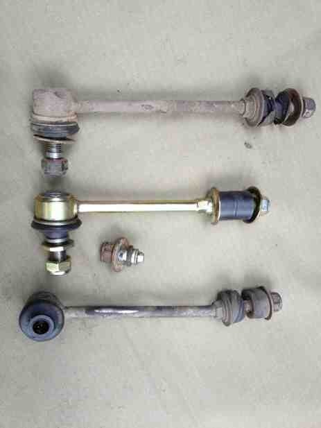

Yesterday I finally got round to replacing the front drop links and sway bar bushes. I got the poly bush kit and a set of drop links from Milners, as well as a set of longer Terrano drop links off ebay.
Milners drop link top, old toyo middle, and Terrano bottom. Poly bush kit on the left.
I wasn't sure about these particular Terrano drop links. They look a little cheaply made:
And the bottom bolt is quite a bit thinner than the proper LC piece.

I didn't want it to move around in the mounting hole, so I decided to use the Milners links with the poly bushes:
The right hand link came out without too much fuss, but the left hand bottom bolt was a bit of a challenge. Lots of heat, WD40 and leverage used in various combinations together with much grunting and swearing had absolutely no impact. I started wondering if brute force and violence was the answer... and fetched the angle grinder.
There was no mention in the full service history that I got with the truck about one of the links being replaced at some point - see pic below:
I suspect that the one that I had to cut off was an original.
On the very right of the first pic you will see a square(ish) flange - none of the replacement links came with this flange so I had to remove it from the old link with some vice-grips.
The replacement link did not have this flange. Whoever had replaced it before had not transferred it onto the new link. I ended up using one of the spare top bush washers (see the first pic, top left below the bushes) instead thinking that it would couldn't hurt and was better than nothing.

I thought I would give an update on the Milners Terrano drop links that I fitted 2 years ago.
I originally swapped to the longer Terrano links to get a bit of extra articulation with the 2" suspension lift. As per my original post, I was a bit concerned about the quality. They ended up ladting 2 years and they have had a pretty easy life until the start of this year, and even then I don't do big articulations everyday. Also, the original items lasted MUCH longer.
I've noticed an occasional knocking sound at low speeds on the brakes and turning (usually left), but couldn't ID the source. A couple of days ago I was about to pull out of a services and pulled up turning left before joining the traffic. There was quite a loud metal sound followed by my wife's "oh oh!". At first I was worried that the top ball joint had broken (everything else in that area is less than 2 years old) but it was still steering too well. What actually happened is that the right drop link had snapped at the ball joint. If you look at the pic below you will see that it bent at the top too. The drop link on the other side is still straight, but the bushes are pretty chewed up (also see pic). I've replaced them with std length Pedders items (middle of pic) which come with a 2 year guarantee.
