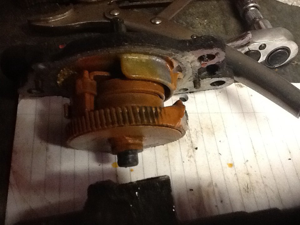

I did a little bit of off-roading a couple of weeks ago to give the old girl a workout and she was performing as expected until I needed the front locker.
i test my cdiff and lockers on a regular bais to make sure they don't become sized through lack of use and tryed all only a week ago and all was fine..
Not any more front has packed up.

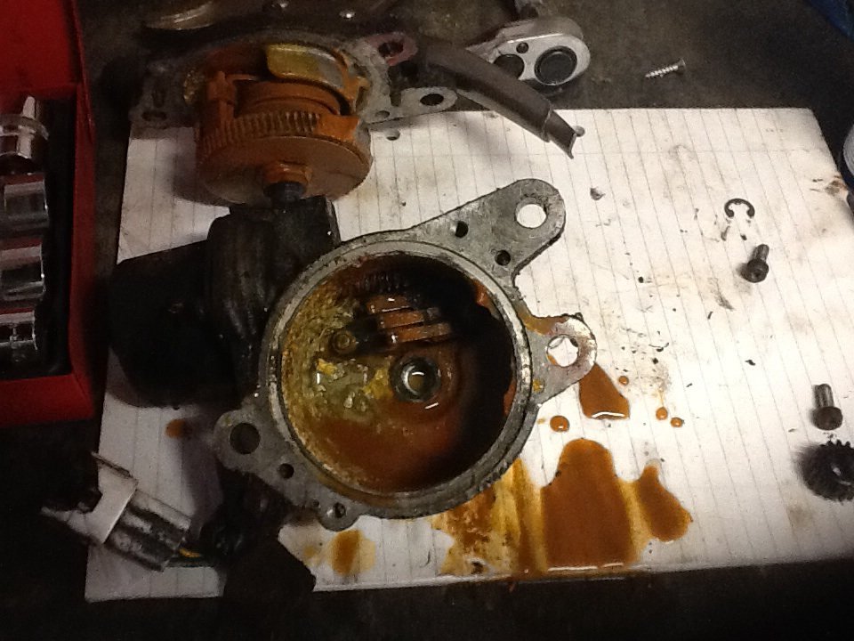

i returned home to strip down and found this
I found out that the o ring seal had gone hence the water ingress
anyway all stripped down and rebuilt works perfect now.
