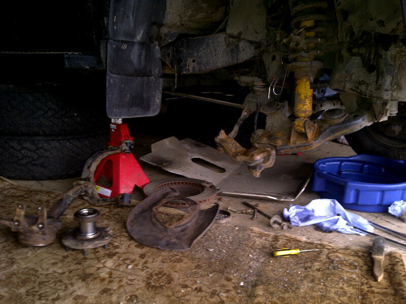

drivers side CV joint was clicking underload on hairpins. Discovered this morning the wheel was pretty loose at least 1mm of play, so wheel bearing need replacing, i already have a spare and seals.
my question could the CV clicking simply be due to the loose wheel bearing?
or is it likely the CV is fubar too?
going to remove the steering knuckle and take down to garage to press the hub and bearing out and fit the new one.
