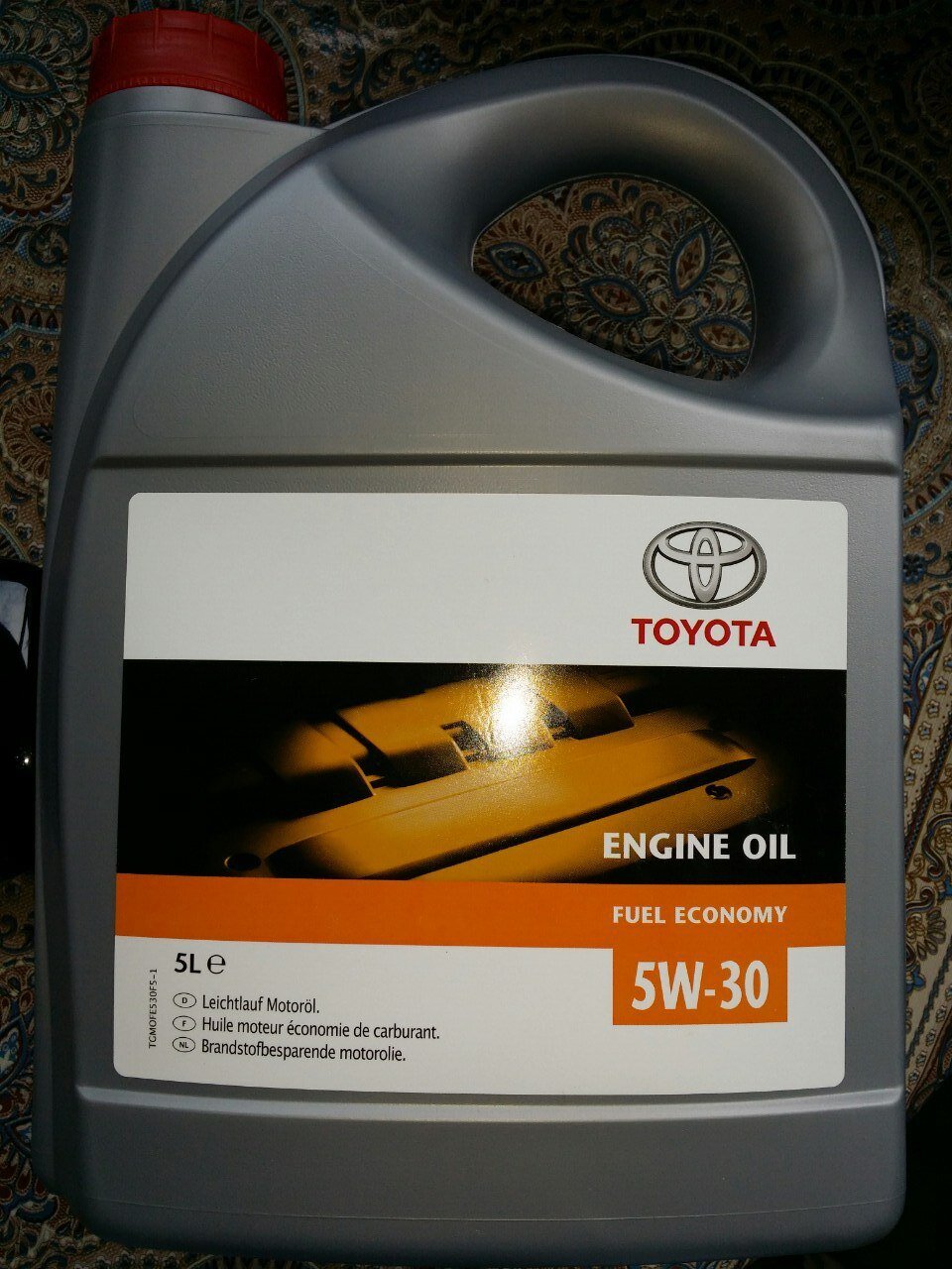

3 - In the first week the oil indicator on the dashboard turned on so I checked the oil level and it was under that minimum mark so I bought the same oil (5W40) and refilled with about 0.5L
