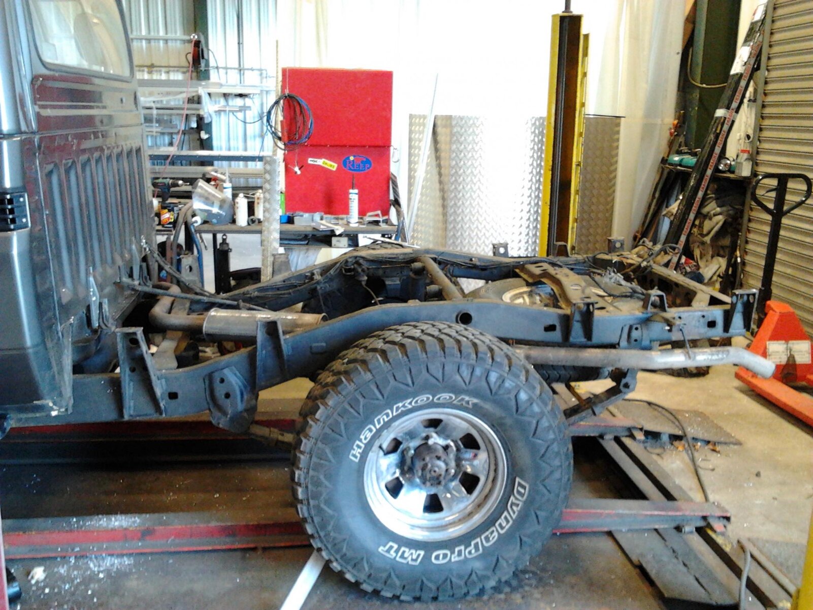

Looking a bit naked with the tray removed....

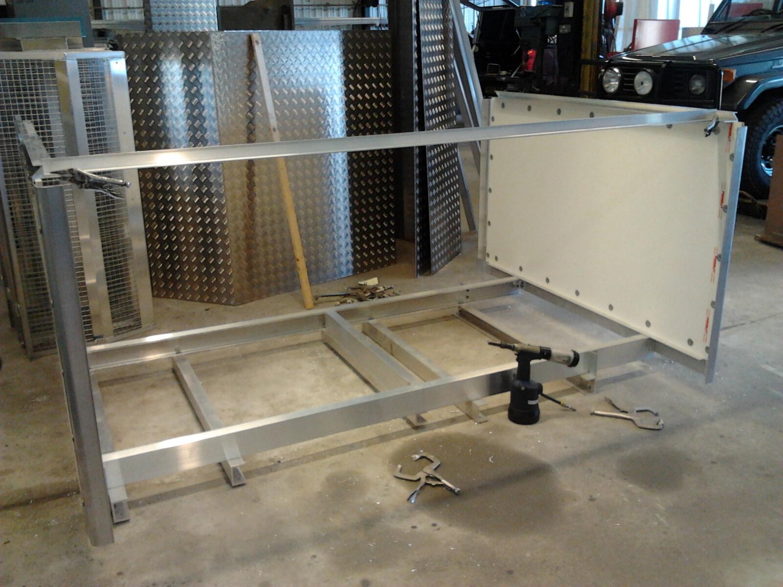

An aluminium frame is built to hold the GRP panels that will make up the walls and doors...

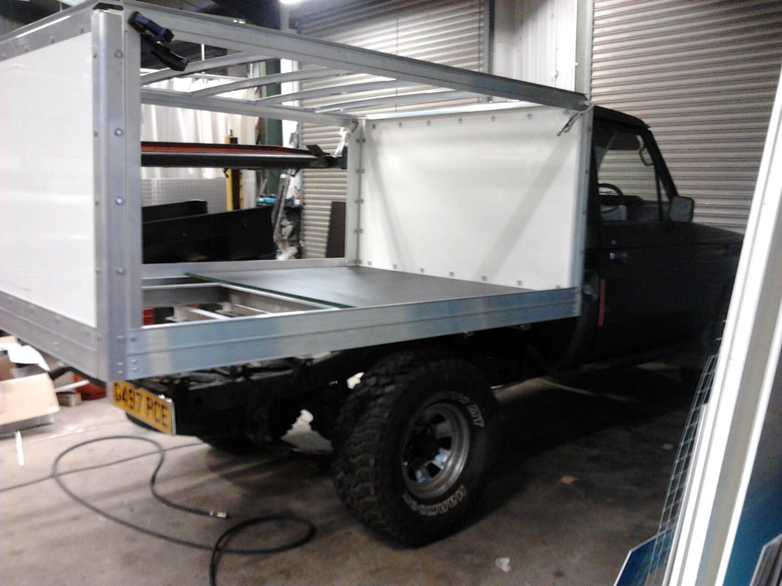

And then it's onto the truck!...

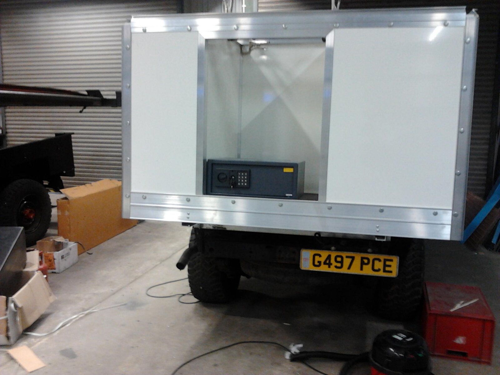

A rear storage cupboard will hold a 12V socket and 2 x 22 litre tanks for the shower, and some luggage. This area at the back of the truck will be inside the rear "room" of the Howling Moon Stargazer roof tent that is going on the top...

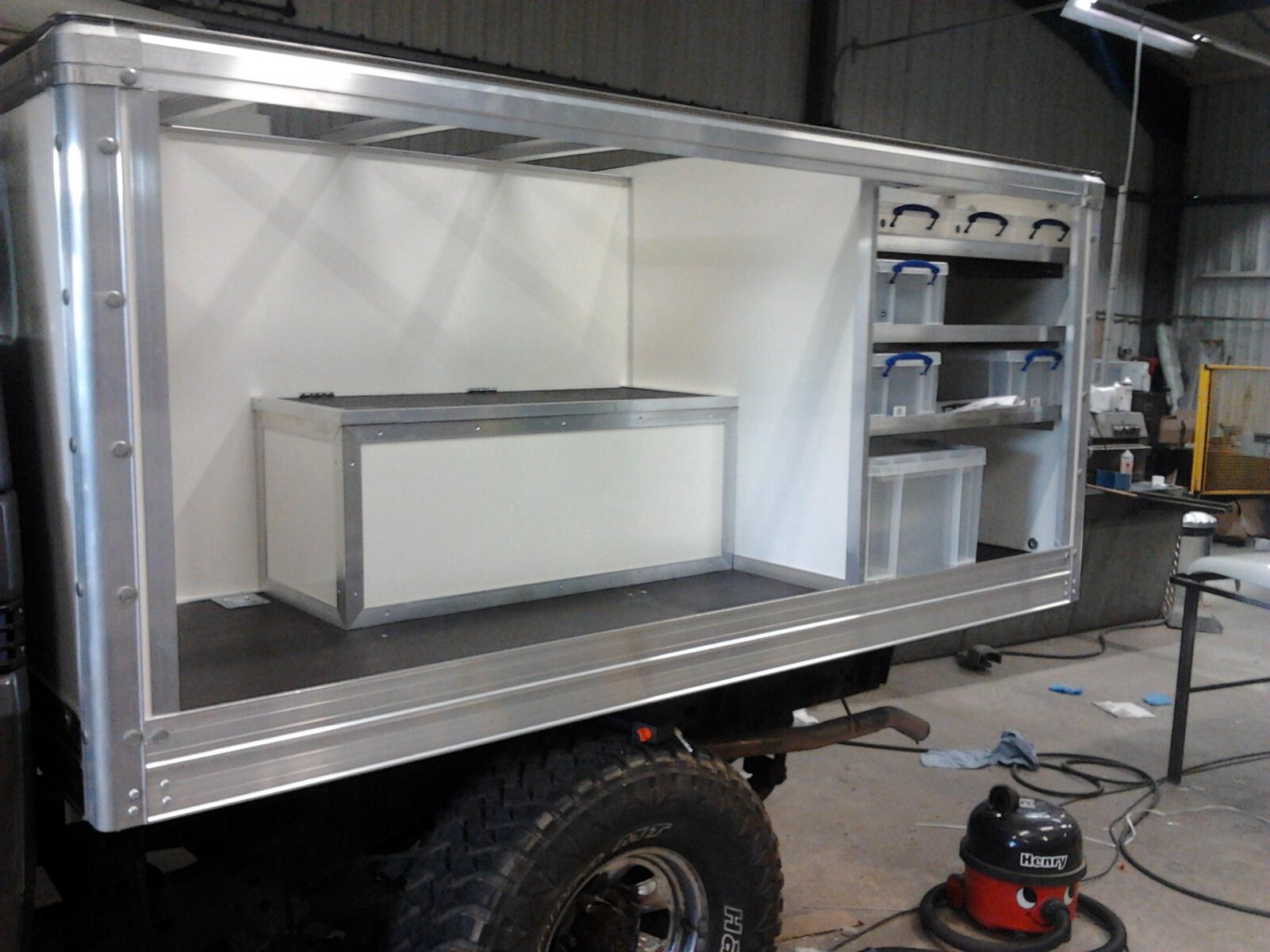

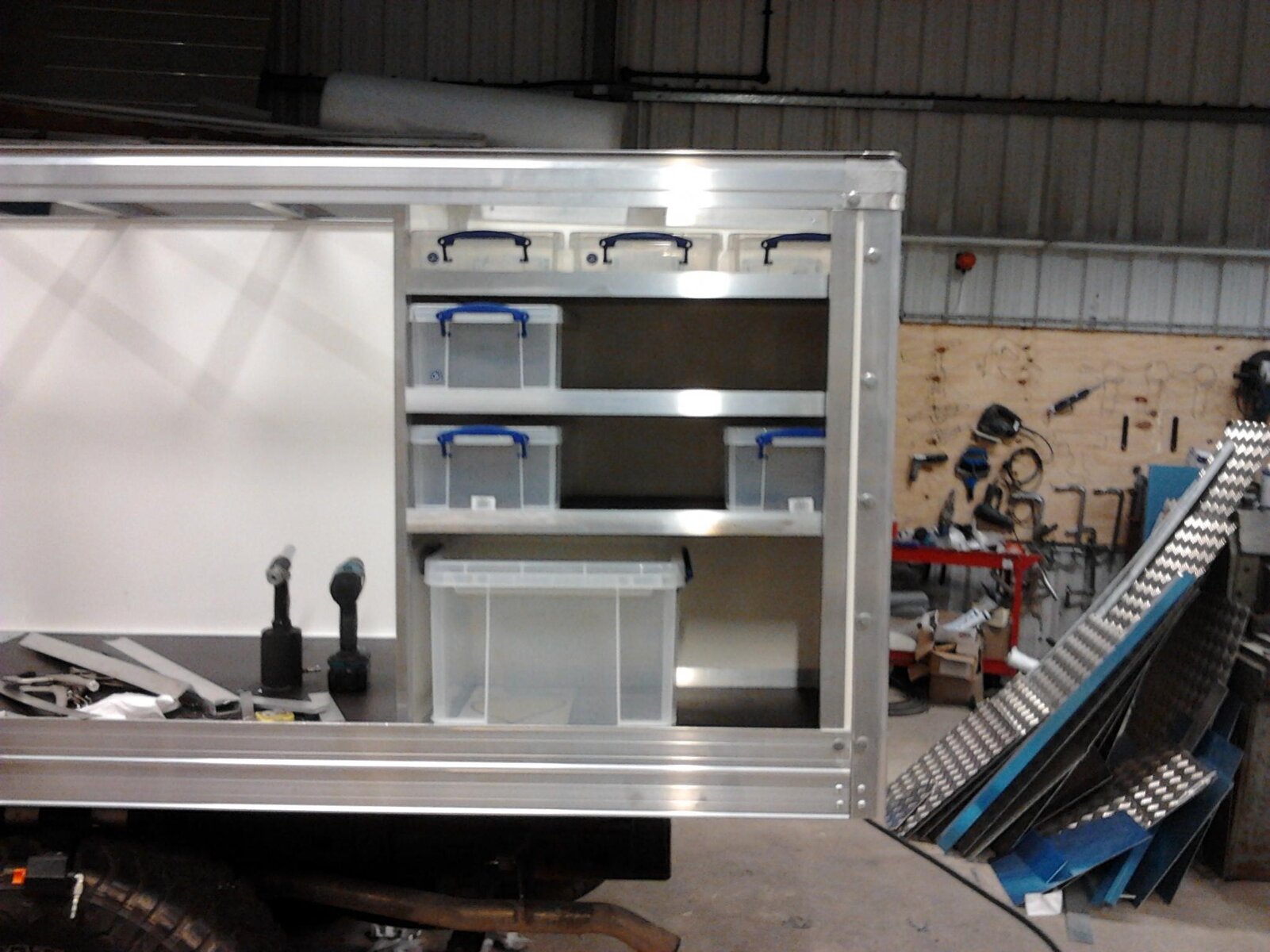

Lots of storage space including shelving made to fit the Really Useful Boxes...

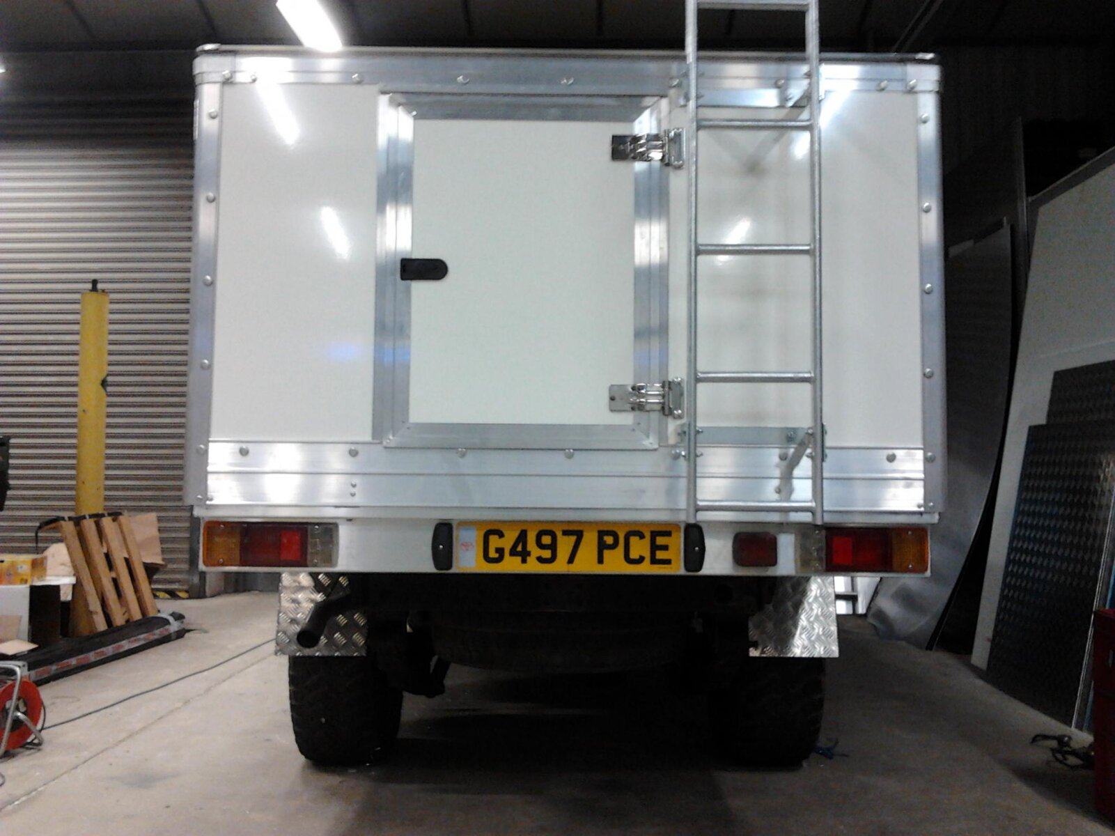

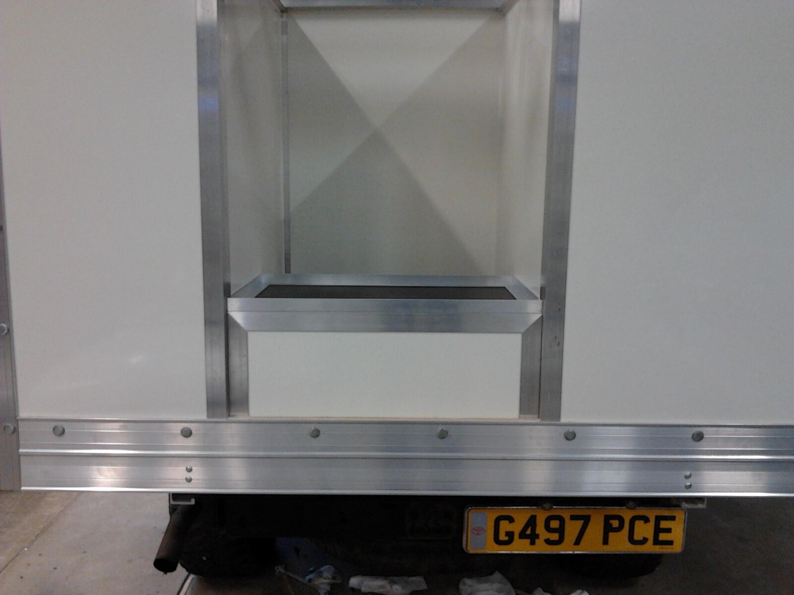

The all important ladder on the back - this will be very handy for putting the tent up and down...

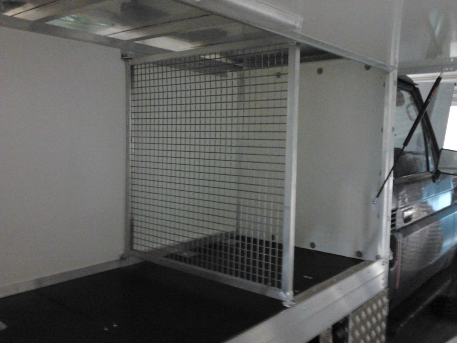

A handy sliding grill partition will keep the space for the spare wheel separate from the other gear...

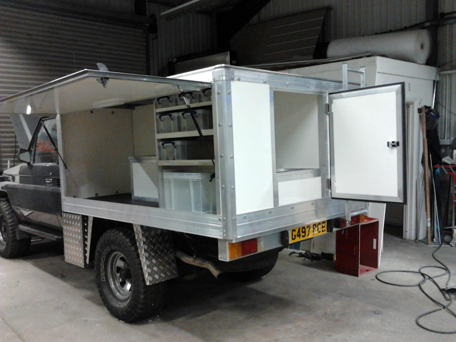

And the finished result with the pop up doors. The only thing that needs to be changed are the aluminium jerry can holders that fit in front of the rear wheels. These come down way to far, so I'm instead going to mount them horizontally behind the rear wheels. The mud guards also need shortening.
