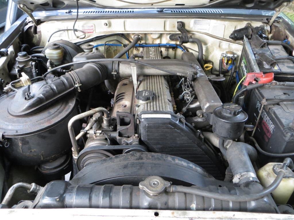

Looking good so far, John! Looking forward to more! Does it have a turbo or straight?
Thanks. It's just straight, no turbo. It aint quick, but it gets there! I'll be getting all the overlanding bits fitted in the back in the next couple of weeks, so will upload some pics as it comes together. John

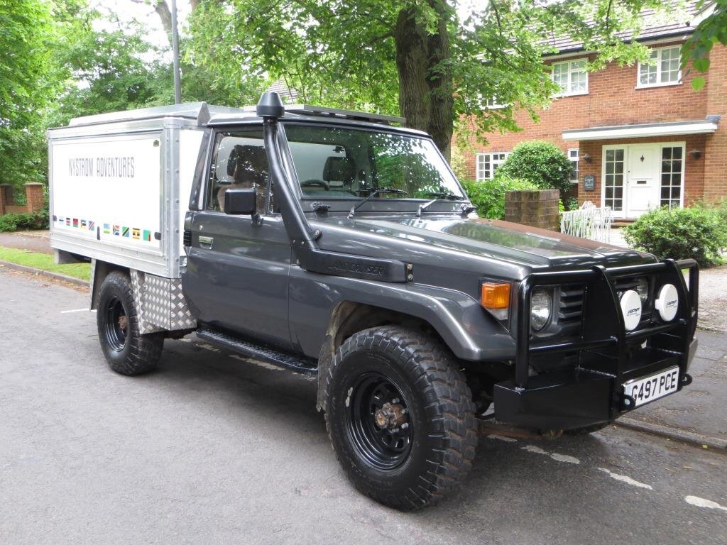

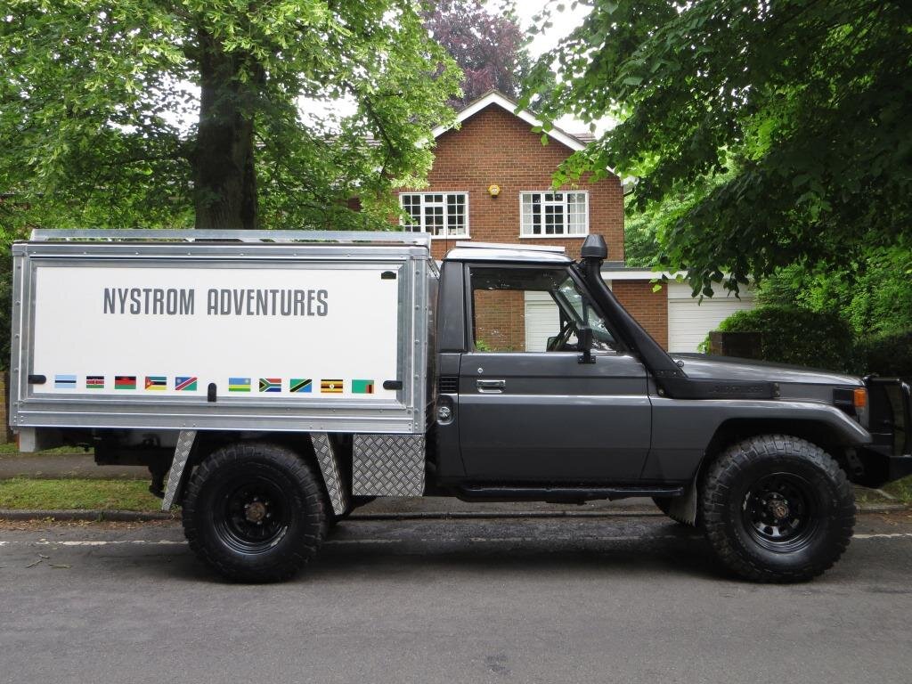

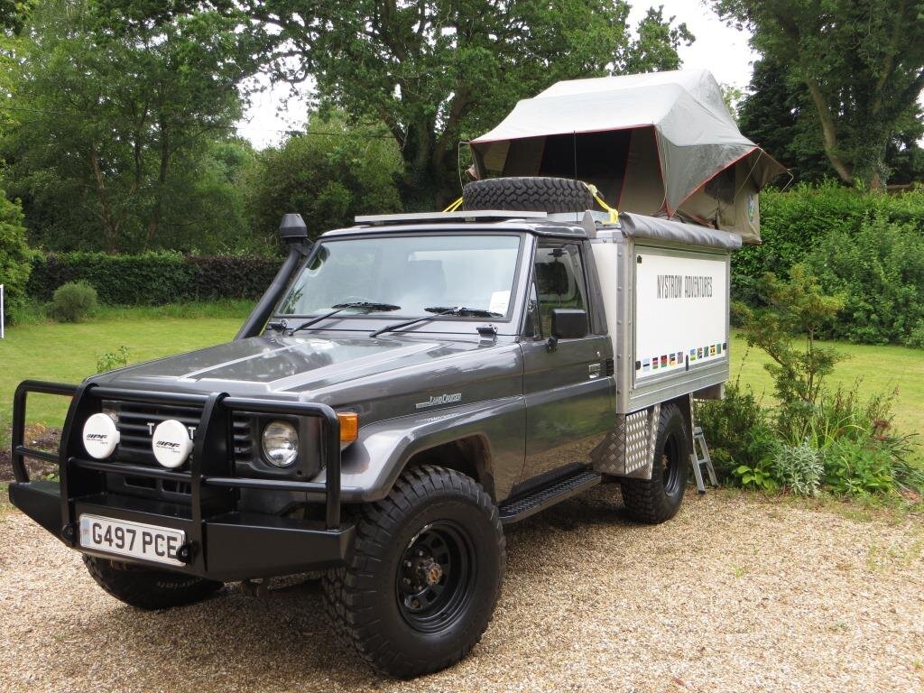

Well it all took longer than planned, but finally the truck is ready for loading and packing - it heads off to Namibia next week. Here are some pictures now that it's all done. We were pretty happy with the stick on graphics, which, in case you were wondering, shows the name of our blog. The only thing I've done since these pictures was to add two TracMat sand ladders to the roof, which may come in handy in the Kalahari...
I think this must be one of the cleanest 75's in the country. It shows only 100,000 miles on the clock, and although it was converted from kms to miles on arrival in the UK, the guy I bought it from only did about 6,000 miles with it in 5 years. So the mileage might be genuine - when the baseline service was done I was told that the condition of the joints/shafts/axles and other moving parts didn't look inconsistent with that mileage. It was resprayed grey (it was originally white) before export from Australia. The paintwork still polishes up really nicely and there are no scratches or dents. Hopefully that won't change too much in Africa...

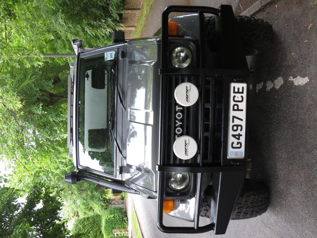

The 100w IPF spotlights are great, although during our test run up to the north of sweden to visit family last month it never got dark enough to try them out. 5,000 miles in 4 weeks with not a glitch...

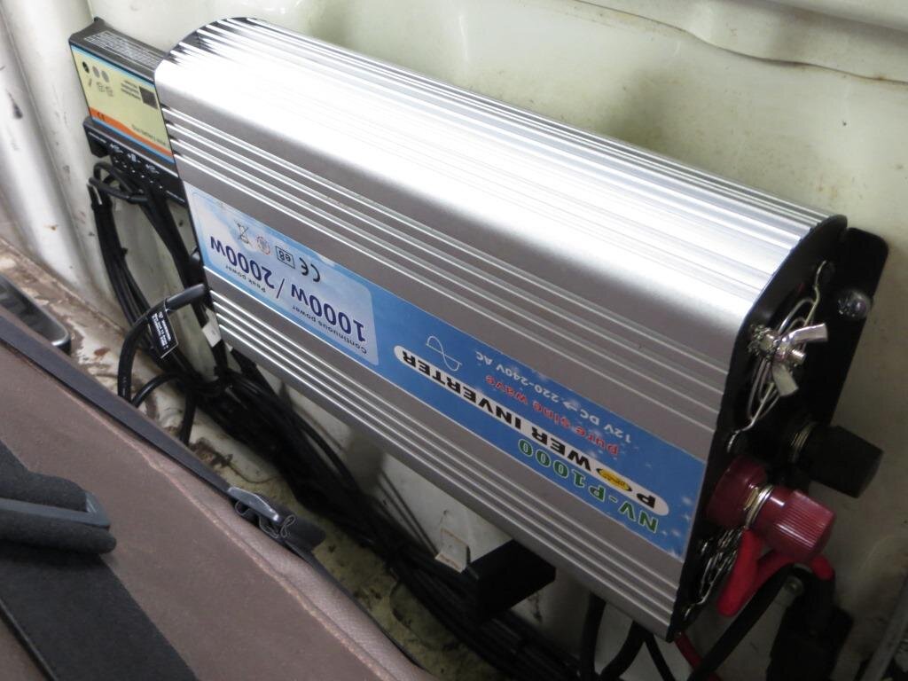

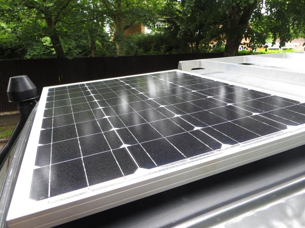

There is a split battery system, roof mounted solar panel and 1000w inverter for mains power...

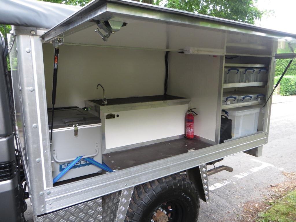

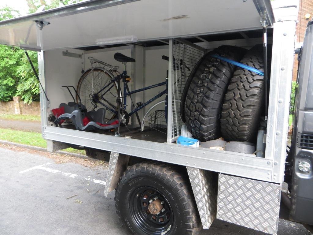

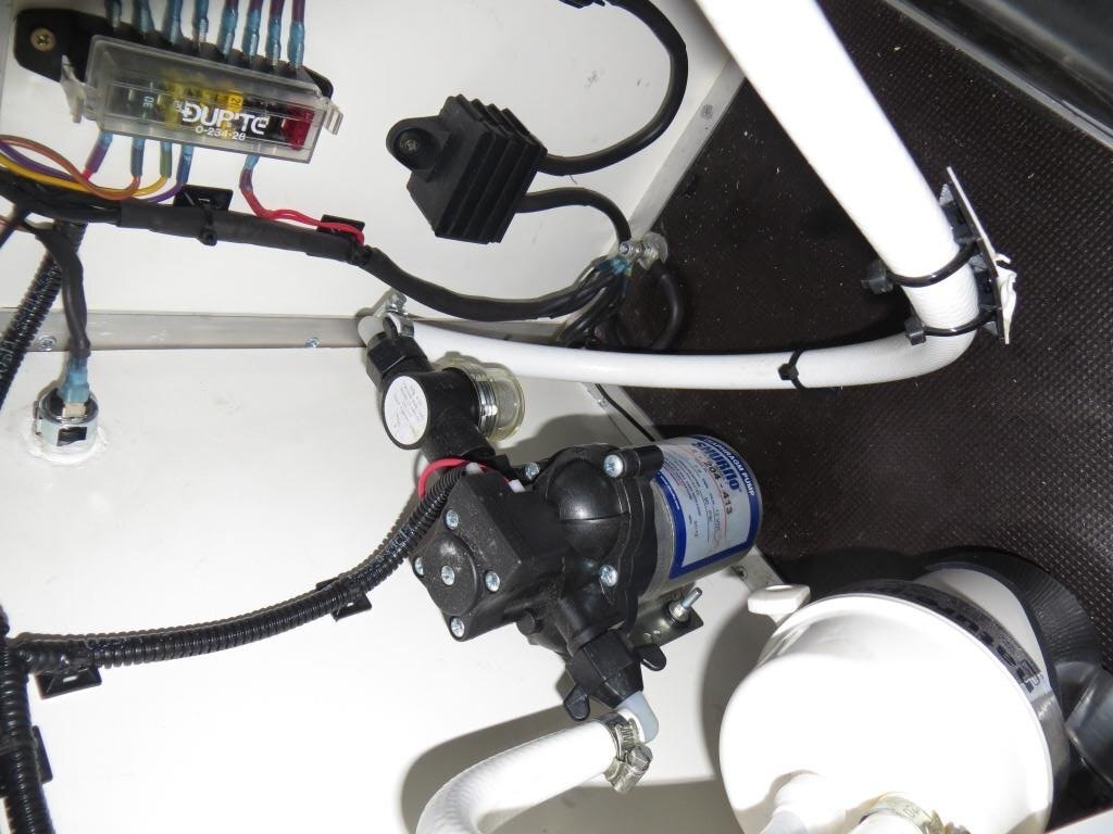

In the back there's a 35L Engel fridge and an 80l water tank. The water tank is connected to a General Ecology purification system, fed by a Shurflo pump and connected to a handy tap. On the other side it's mainly storage space for some boxes of supplies we're taking to a children's charity in Zambia that we support. But there is also room for two spare wheels - these do sit up straight, but were leaning over in the photo. The steel mesh divider also slides forwards and backwards so it holds them securely in place when they're upright...

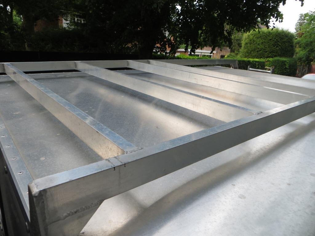

There is a custom built aluminium roof rack which will hold the roof tent (see below)...

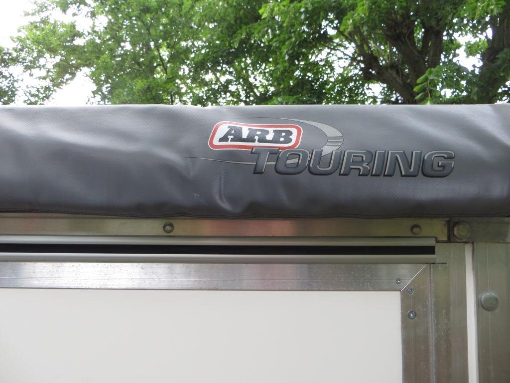

And an ARB awning from Devon 4x4...

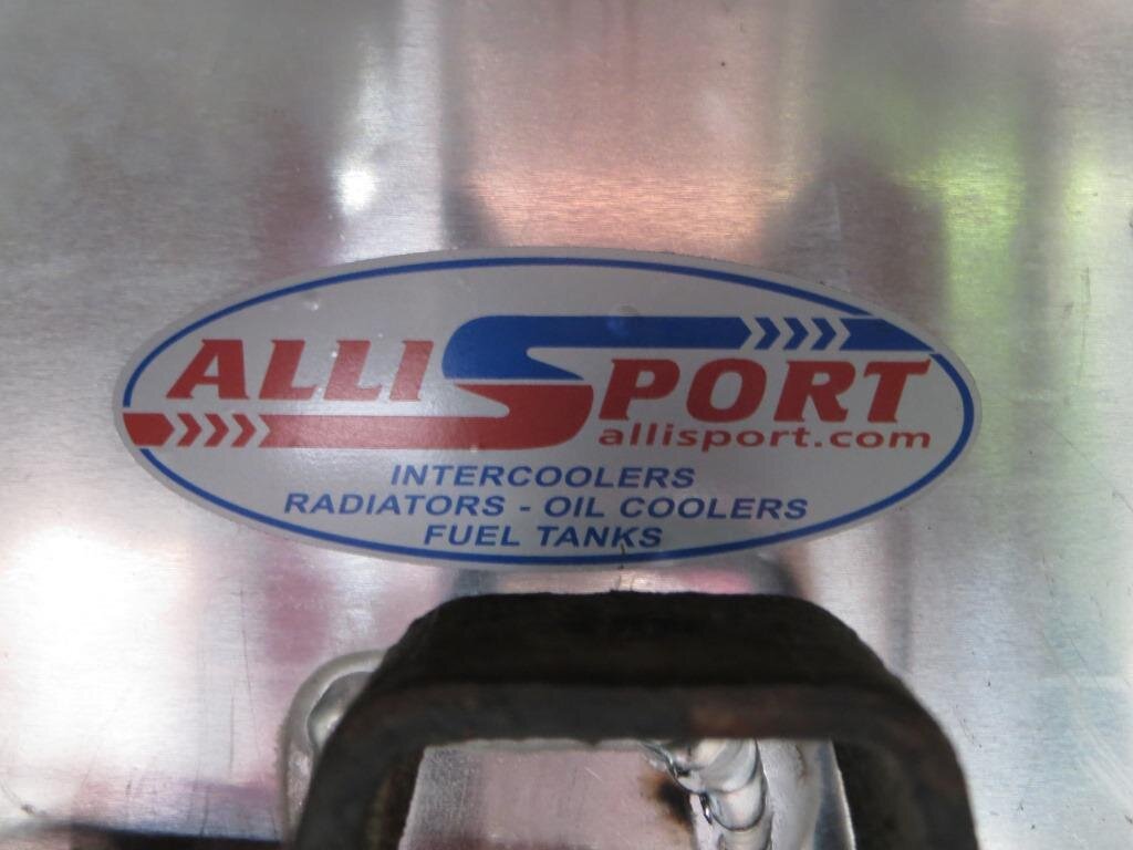

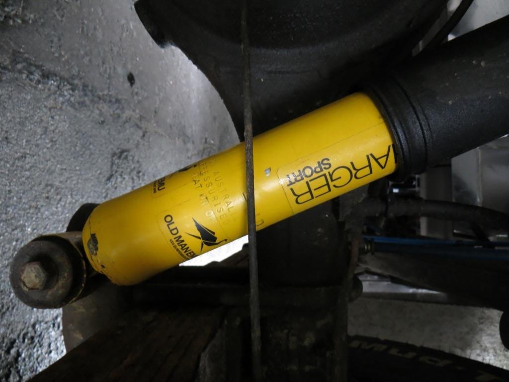

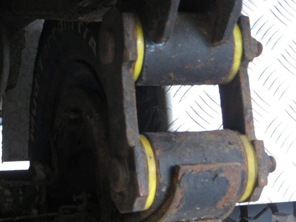

Underneath are twin long range fuel tanks made by Allisport, so total diesel capacity is now about 230 litres. We have fitted upgraded Old Man Emu shocks to cope with the extra weight (although the original leaf springs that are on there are pretty meaty), and there are poly bushes all round...

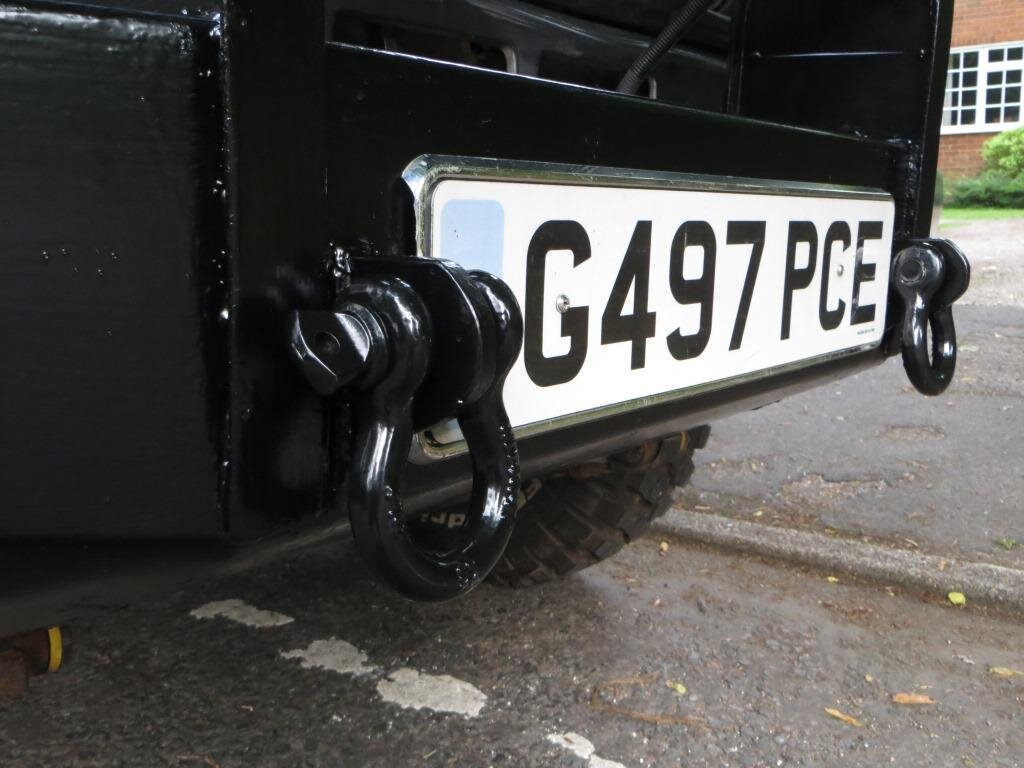

On the front there are some heavy duty towing shackles...

Be careful with any big river crossings. Those standard Toyota snorkels arnt water proof. Weve had a few troopies in work lately to have Safari snorkels fitted in place of the standard Toyota ones. :?
