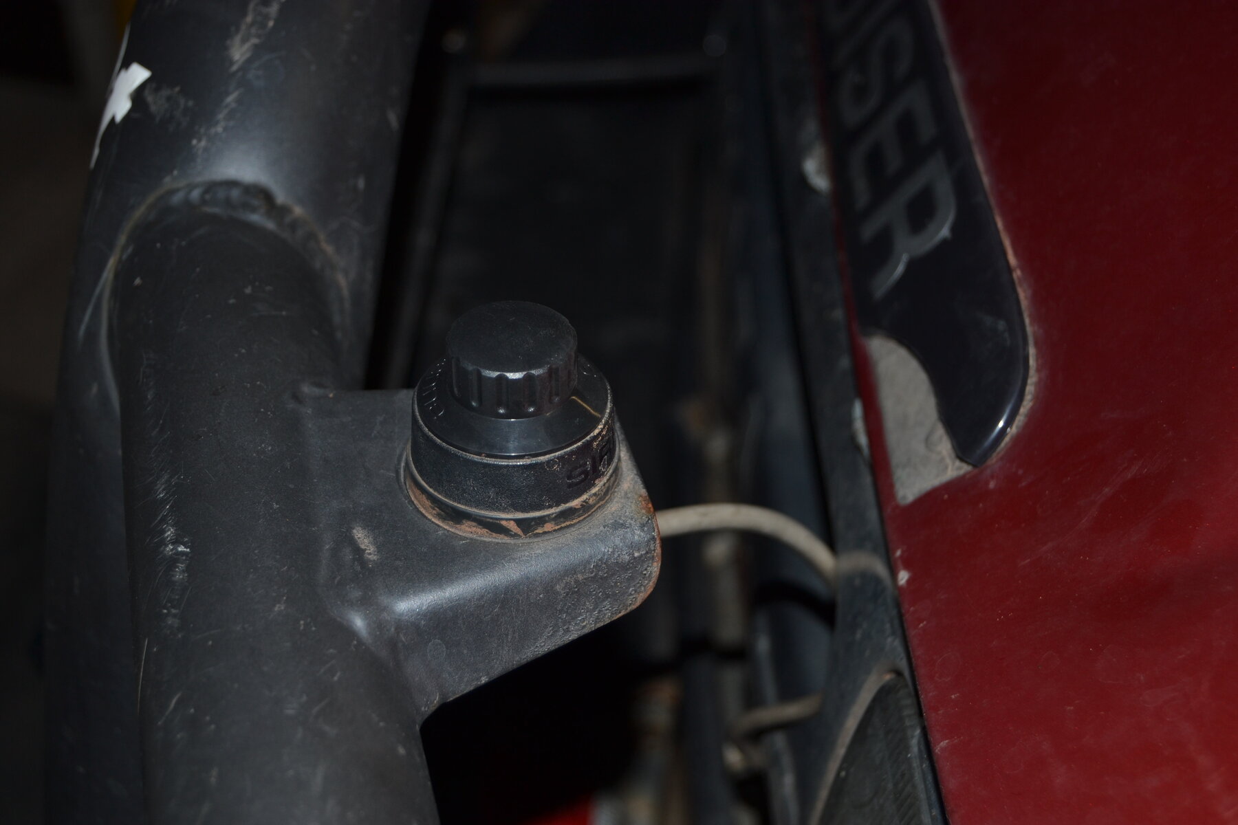

The mount is on my winch bumper Clive so should be OK for yours, the round mount is approx. 1.5" diameter. That is the protective cap on there, I don't screw the aerial on til needed.

That's useful Chas.
I presume the antenna detaches low down on the angled "ball" type fitting.
If it does, then when in use I take my chances, but when detached, I think the mount will be safe enough.
Yes Clive, when the whip is taken off there it unscrews complete with the angling bit. I put this on mine after it being recommended by Jim of 4x4CB.com as being one of the best.
