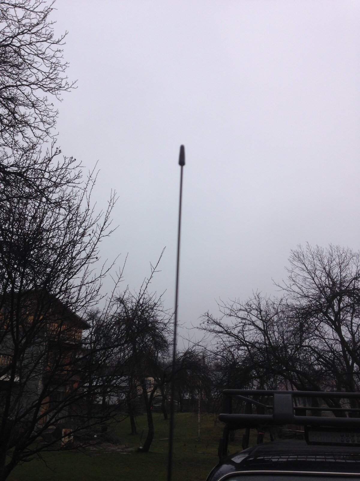

I seem to remember not receiving you Clive but I think you could hear me OK, I would make sure you are getting a good contact on the aerial base on the bull bar, could be a reason you were not transmitting well.

earthing the rig chassis can screw things up too, the aierial provides the earth, so two different potentials can throw it out.
