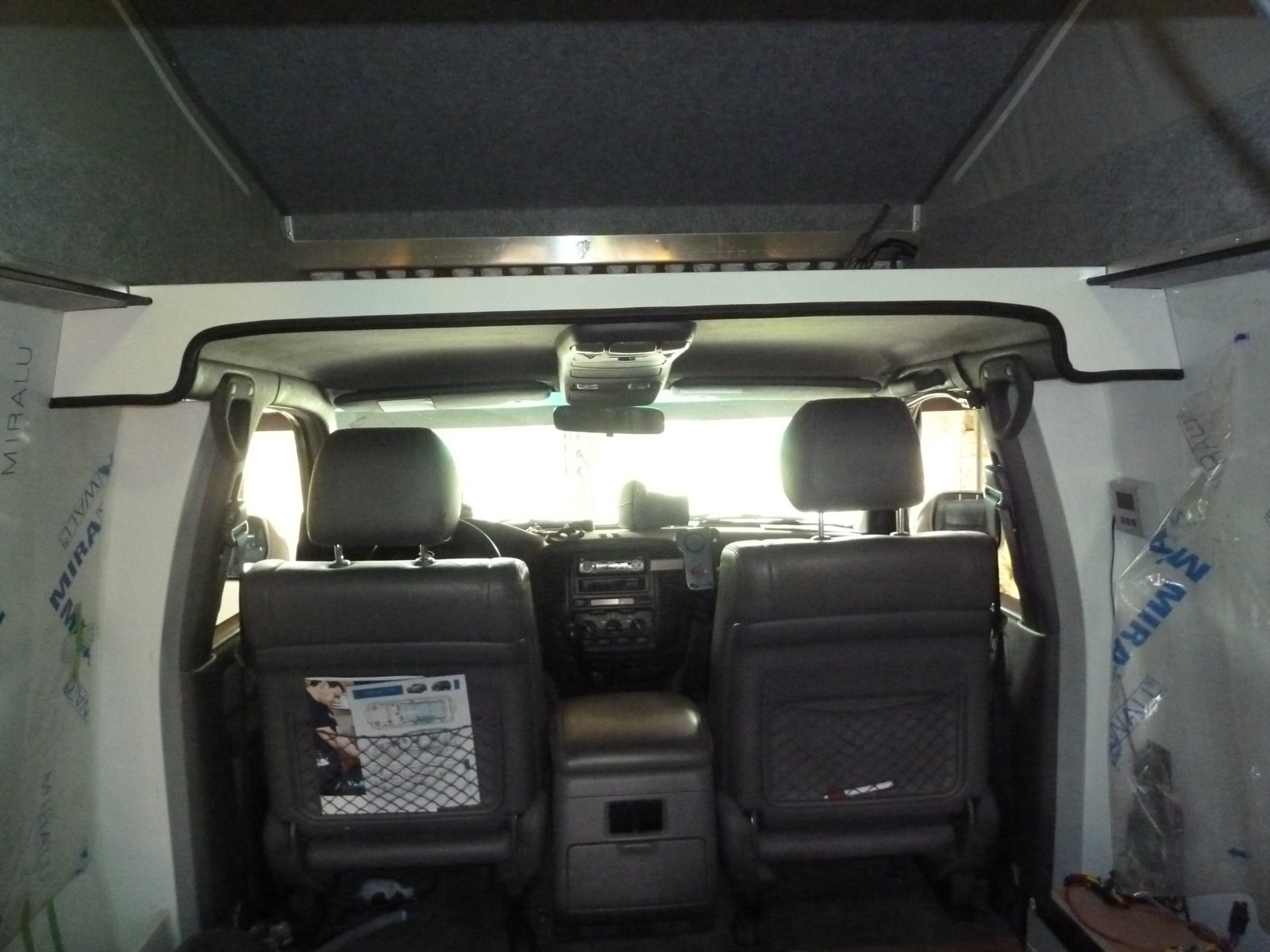

Hi I don't have the car at the moment as its is being transformed in Germany, the only picture I've found is this one.. hope it helps,
Theo
uHu
Mar 7, 2010
2,105
norway
Looks like you have a pre-2003 without navi. That's the easiest. Then it depends only on what amplifier you have -- is there a 5 channel amp under the passenger seat and a twin 4" sub at the back? Some versions have digital remote control of the amp, where you cannot use the same amp if you change the head unit.

it seems we miss a frame behind this and secondly we need 11, 2 cm and only have 10 cm available.. the person in Germany tells me that to order an original frame from Toyota could take 6-8 weeks - he proposes to make one himself
chapel gate
Promoted Company
May 26, 2014
4,119
england
You need the metal side pieces that held the original head unit in place.
