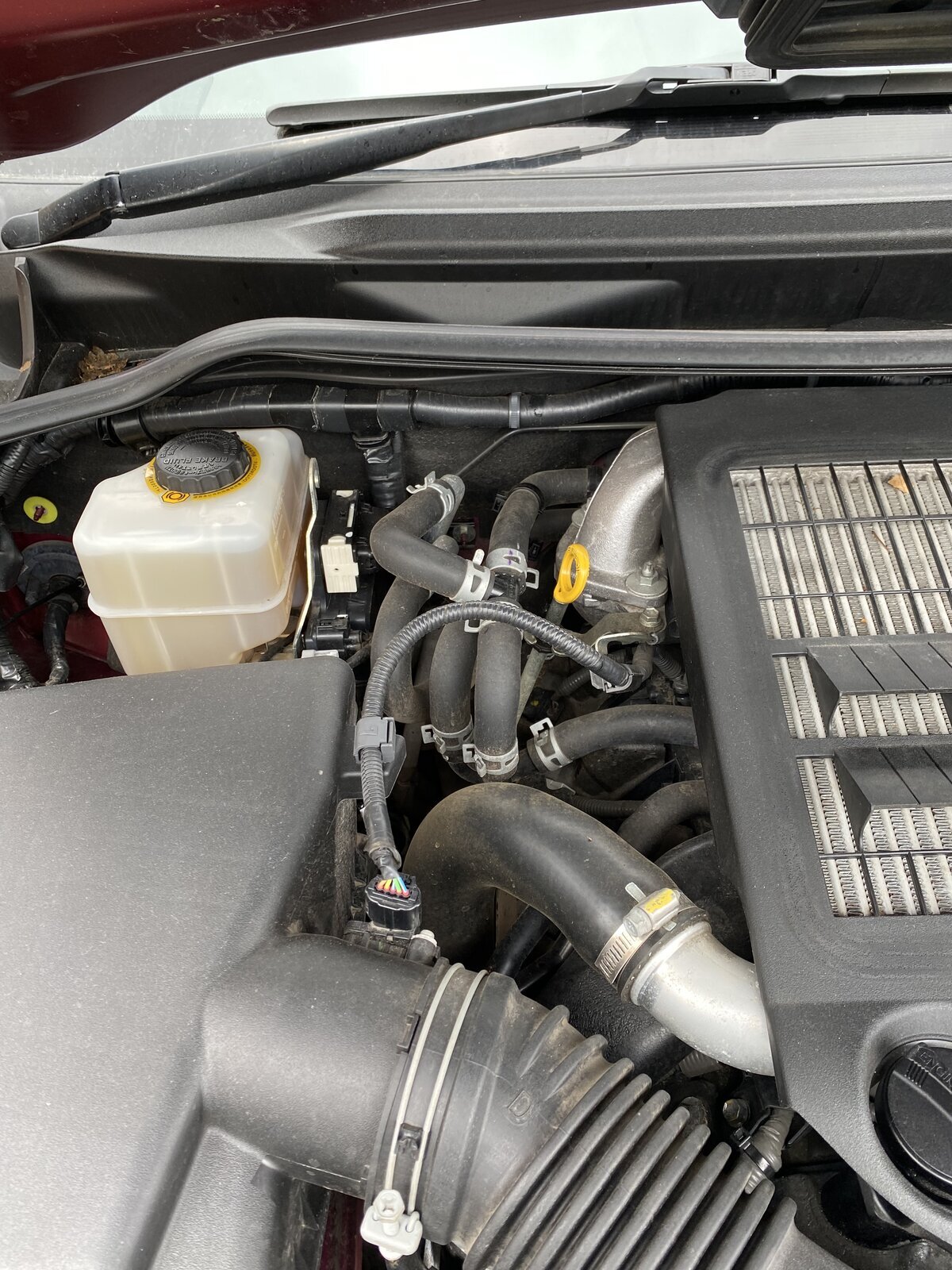

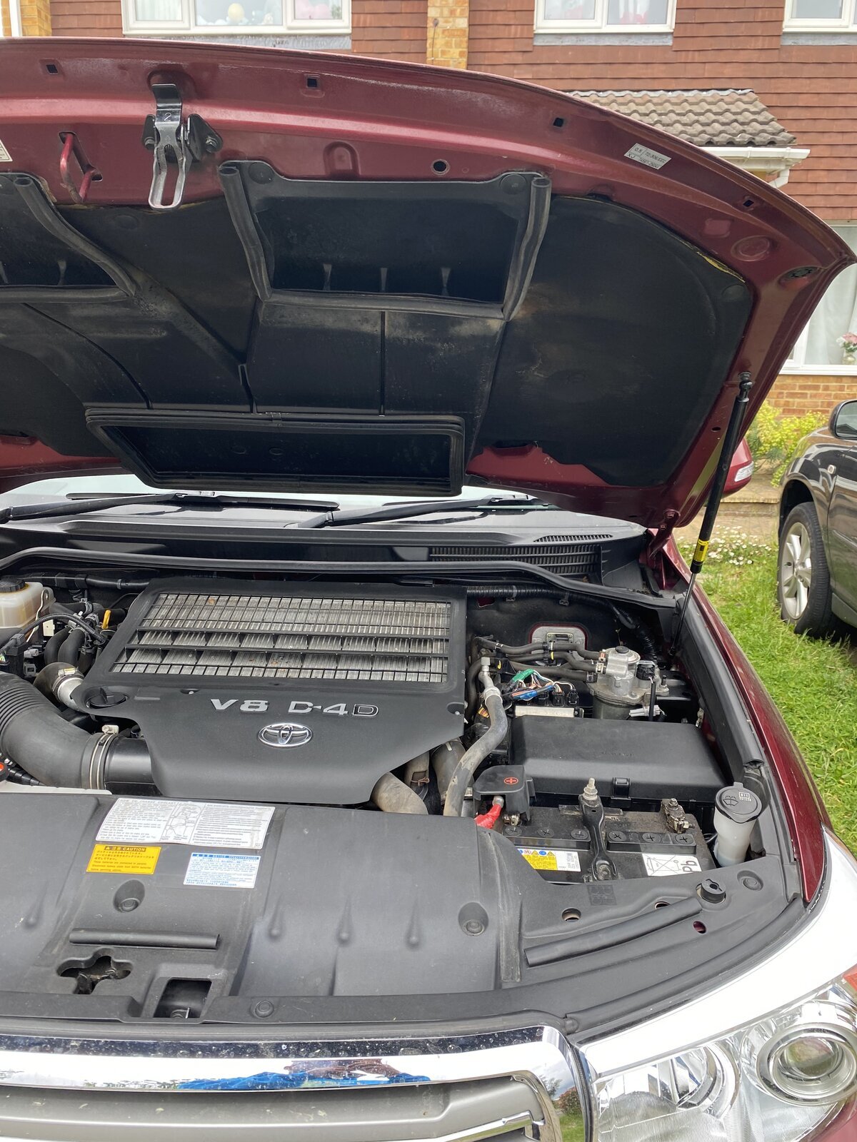

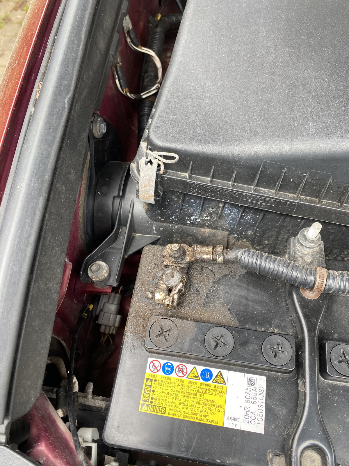

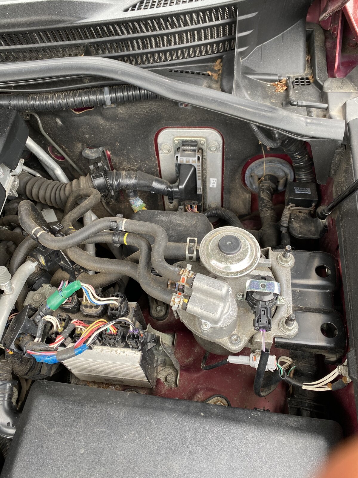

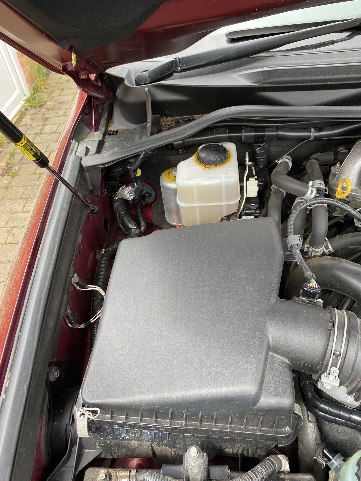

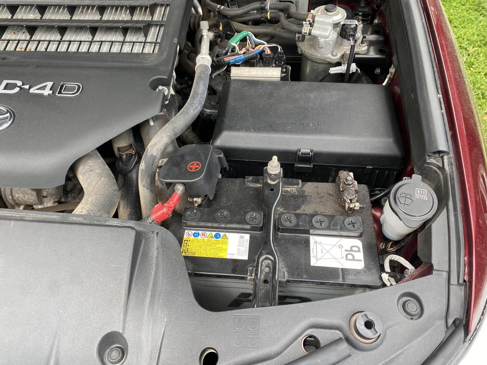

Below video of under bonnet. 90% of normal buyers won’t be able to spot anything wrong
Never buy any 4x4 without first looking underneath it , even Range Rovers are work horses to some people so they might look shiny on top despite having been driven through bogs and salt water on a daily basis for years .
