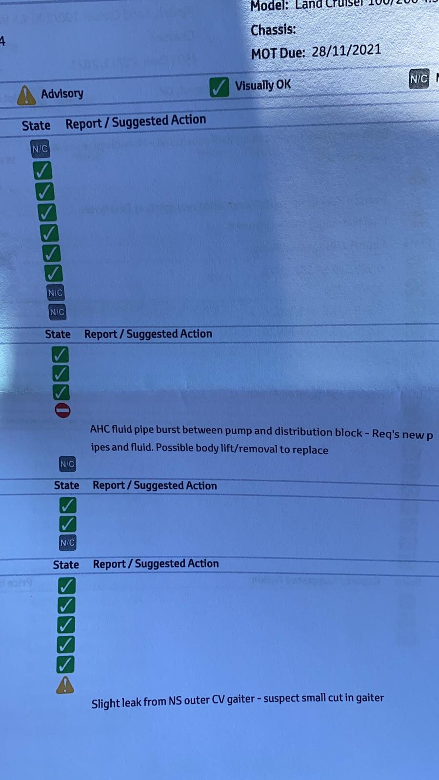

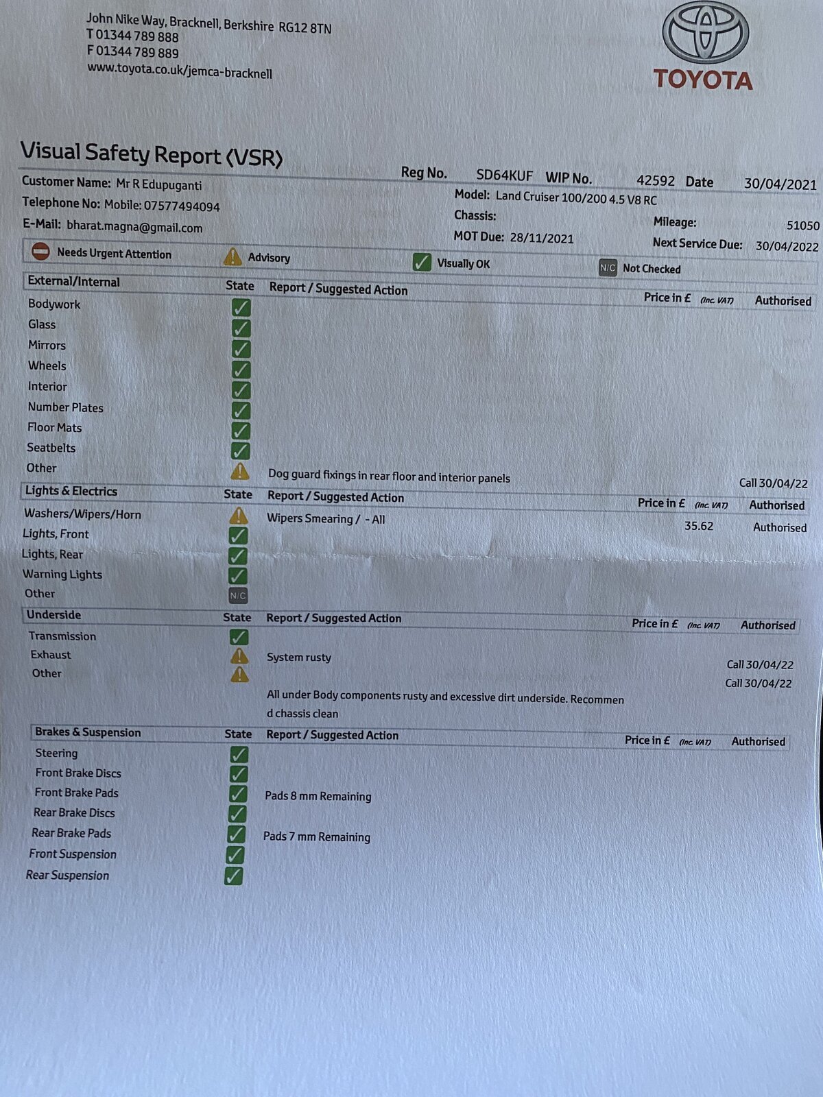

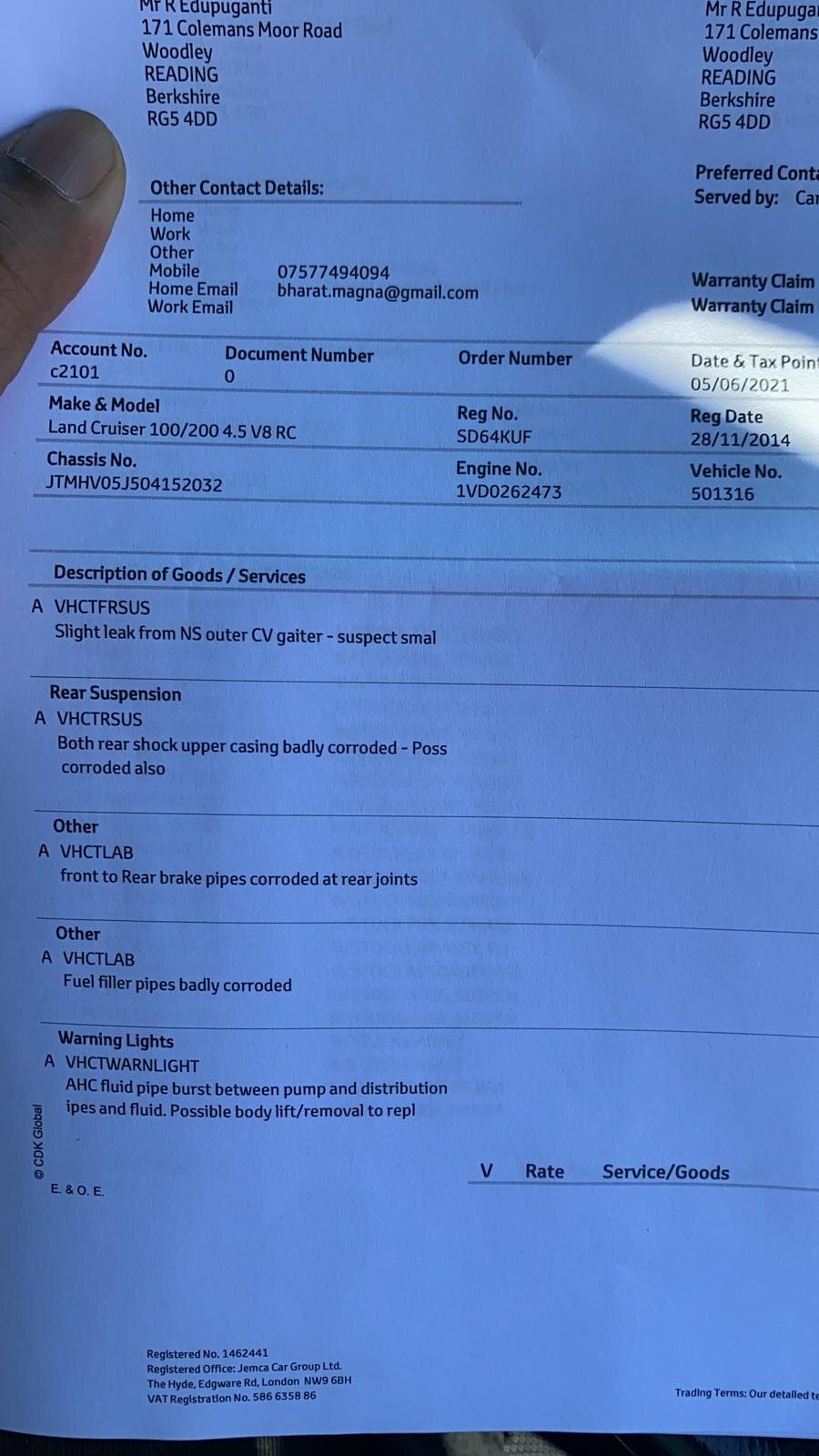

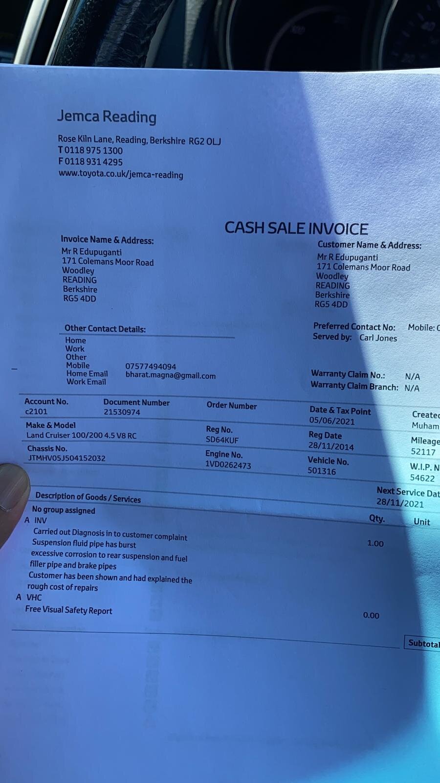

Just now got description of faults from Toyota. They informed it’s not even worth repairing n suggested to get money back. One must be the most unlucky person on planet to get such low mileage LC200 with this condition.

One Toyota felt its not expected for car of this age. However, they said this is expected for cars from coastal areas with bad maintenance.

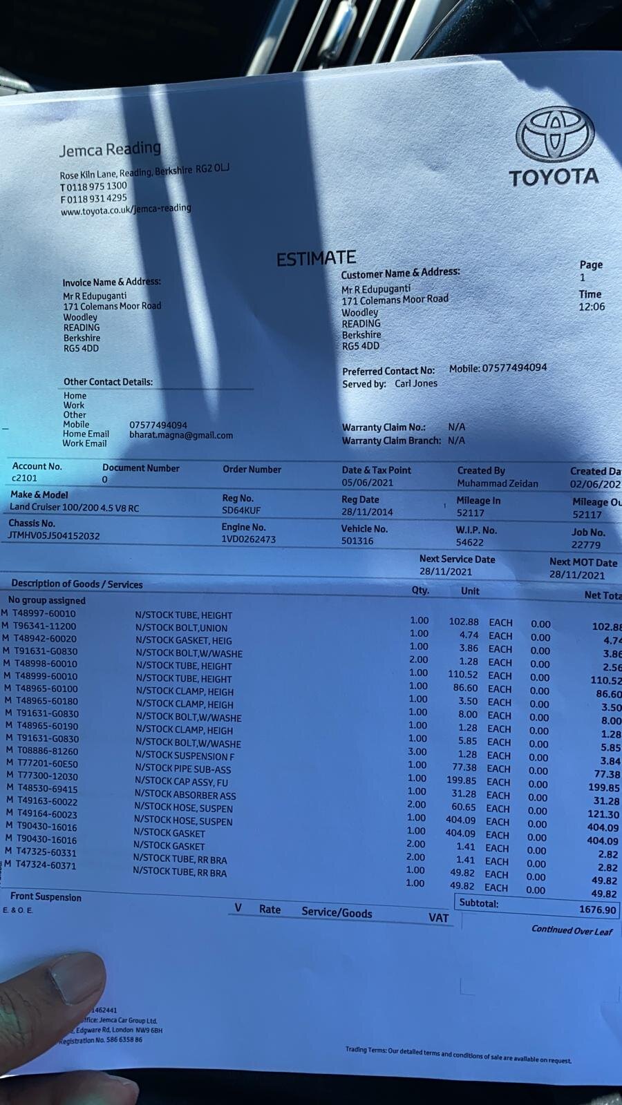

For the repairs, they said around 15000 would be rough start estimate and it ll go up as they open up the car and its not worth repairing as they cant guarantee that the car will stay good afterwards. Other mechanic from Toyota felt its expensive if done at dealer so check options outside if I still want to keep car.

Just today I got my diagnosis report from same Reading Toyota and he mentioned that its always better to buy LC200 from toyota dealer. Dont know if he remembered this car or he was just simply was not happy with independent dealers selling these cars with wrong info on condition. Bad Land Cruisers sold as very good condition ones will eventually damage Toyota image.

if it was only suspension, I would ve got it changed directly at Toyota or even gone for conventional one. T said body has to be lifted completely from frame and replace all the pipes, like suspension pipes, fuel pipes, break pipes. Don’t know if Toyota was blowing up the situation or it’s fact.
