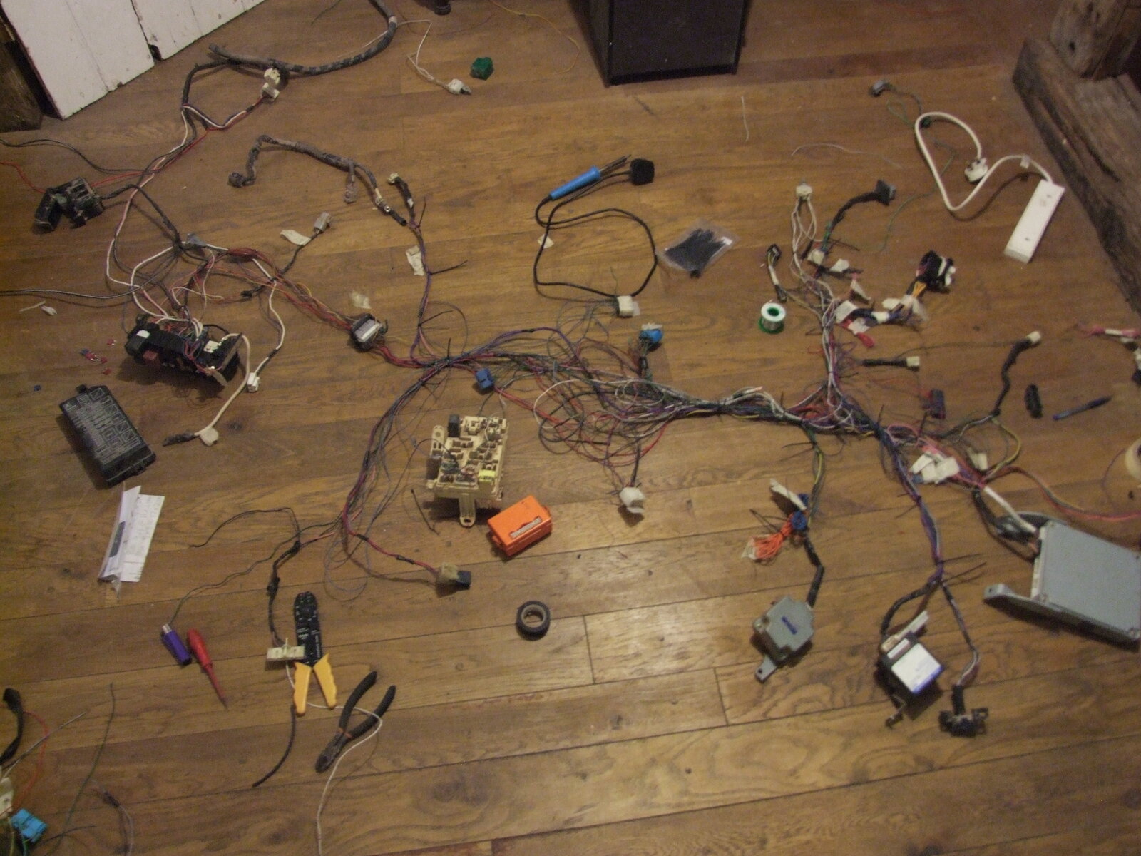

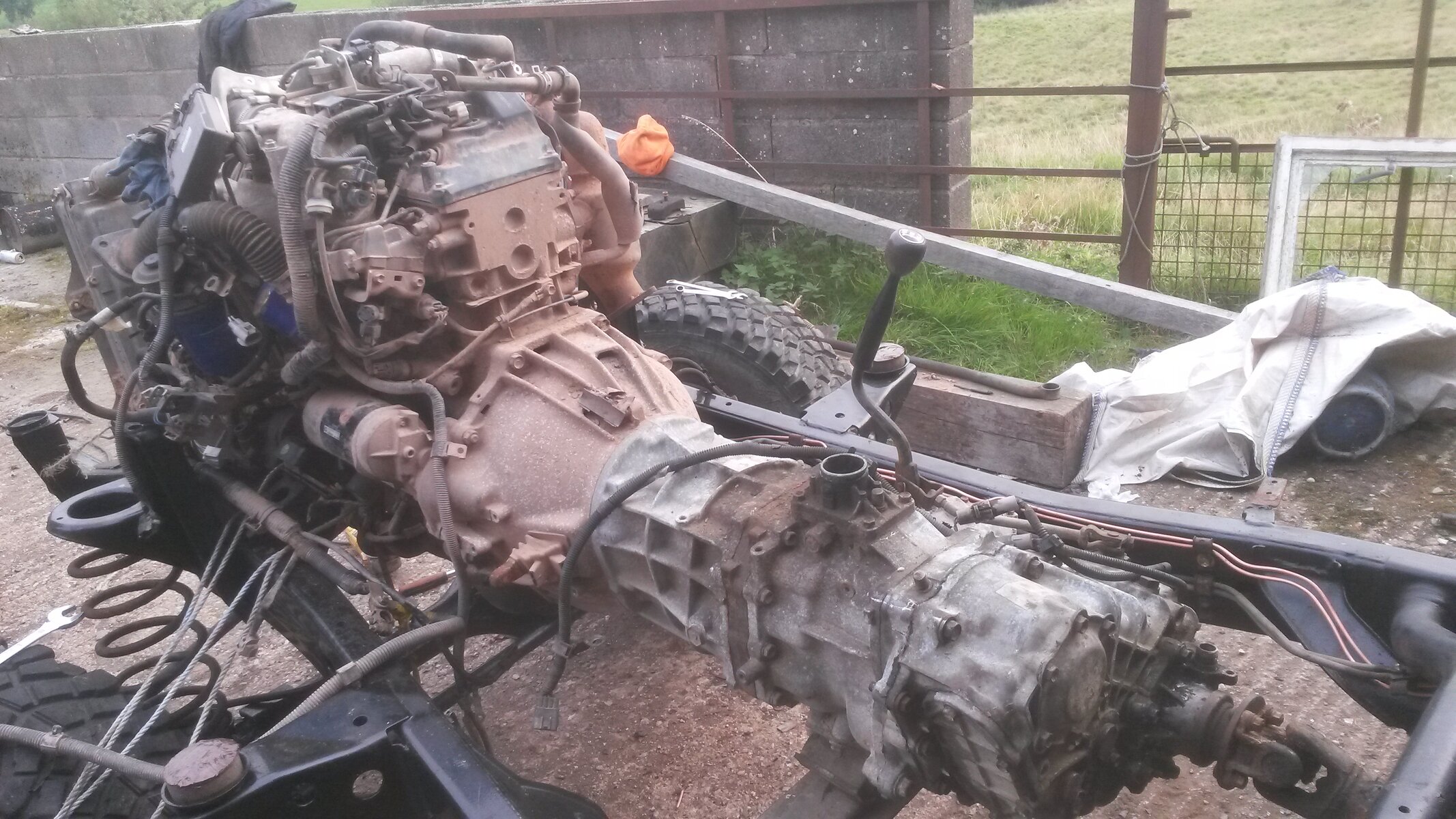

You could be correct there Beau.. from this setup and from what I've studied this weekend is that the ignition barrel, the ecu and the immobiliser ecu are paired and set uiquely.. the main imobilising wires are all purple and are well spread across the loom thats left over (pretty much whats left with it running in the youtube vid).
From the ecu (lower rhs) there's the obd diagnostic port, then the immobiliser ecu with unique bar code(matched, with purple wires) anti clockwise next condition relay this turns on the engine light, the oil change and cambelt light etc..
The orange box is the relay integrator which has the alarm for lights left on.. and is connected to the condition relay.. just above is where the ignition system runs through it powers the "ignition on" side of the truck (red wire with blue stripe+). The power from the key goes through here, no bar code on that so a standard part.
The small relay below the engine wount run without this. (thats all I know!)
Middle lh/s under bonnet relay and fuse box (mostly fuses for "on" whilst ignition off) handling main power in, wiring for key etc.. Just above to the left is the glow plug relay..
By the reel of soldering wire is the (white) main earth point and the 13 bit diagnostic port.. Just below is the non ecu under bonnet engine wiring connector with temp sender, oil pressure etc and more.. Out of shot is the fly by wire accelerator pedal above the ecu..
Just a breif not too technical description of whats left of the loom I have cut up.:icon-cool:
Had a try to get it going today, read afterwards that if you activate the immobiliser you have to get it reset accordingly by some one qualified, or more qualified than myself! Lol So am going to get my mate to remove the immobiliser off the ecu and test the loom... Dont want to have a dash fire from faulty wiring.

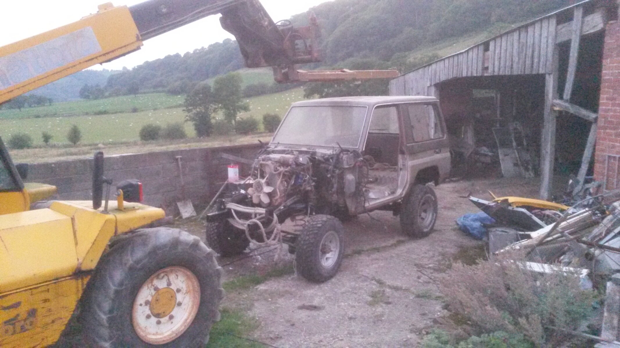

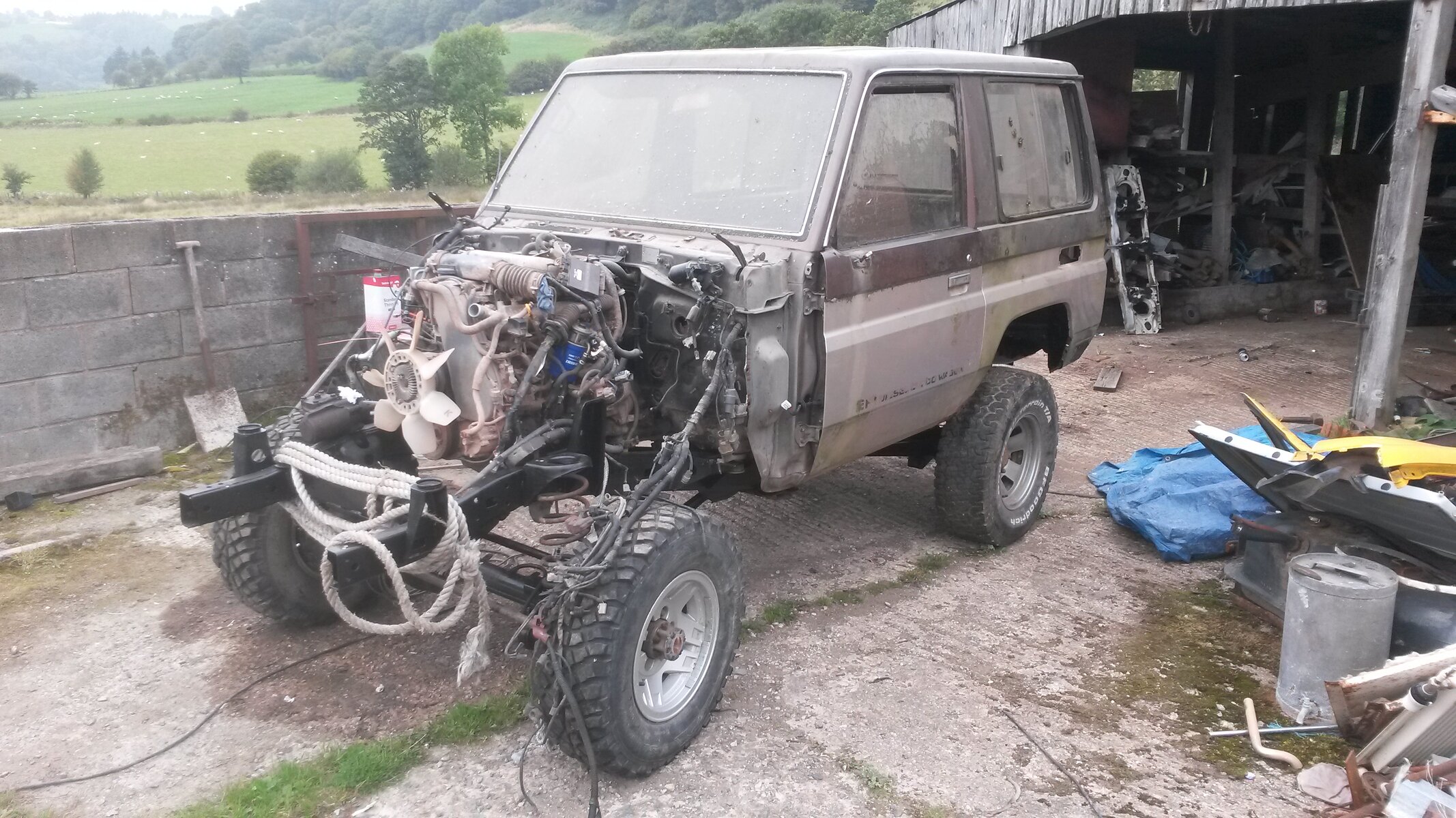

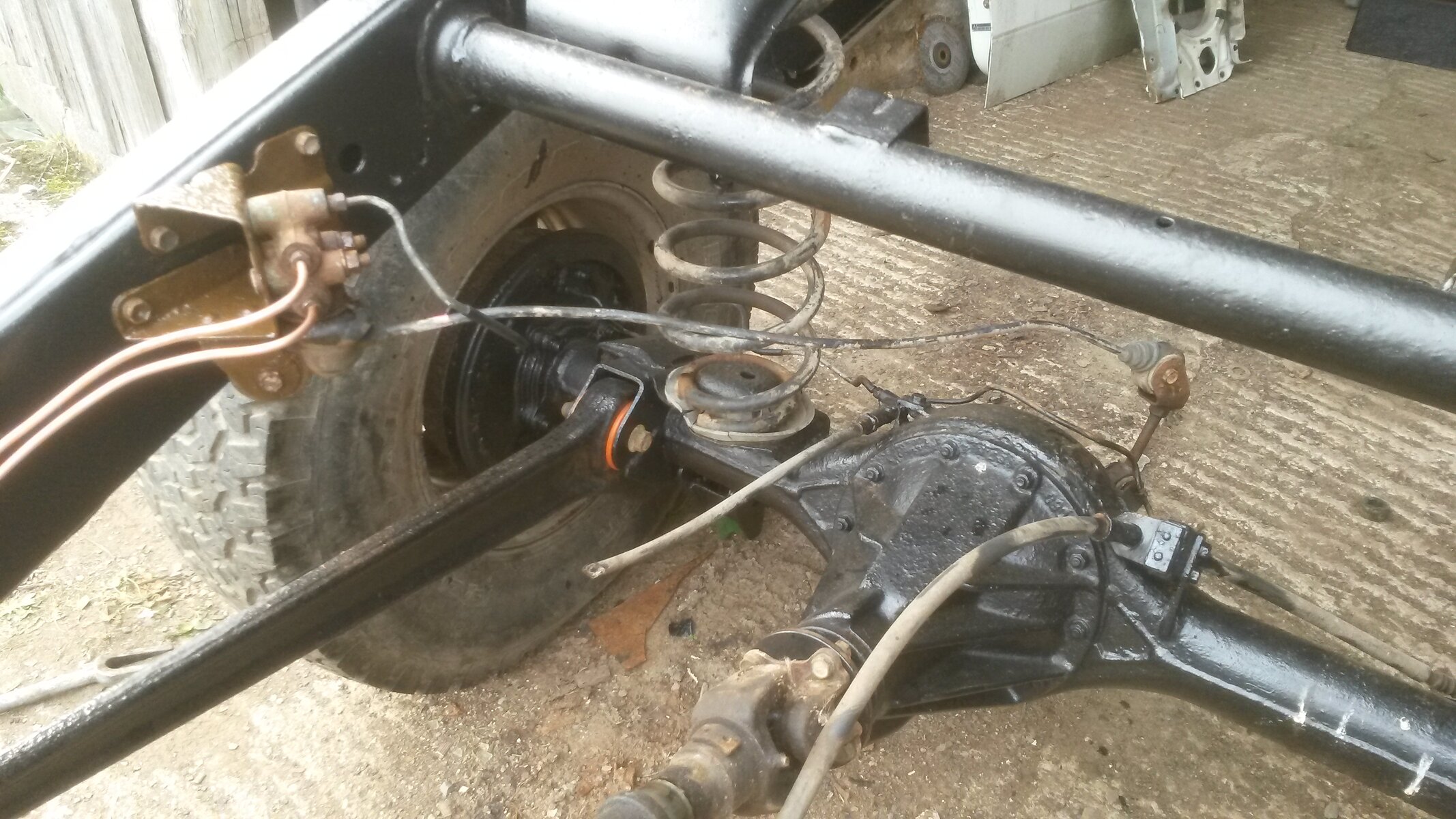

Had a 12 hour hit on the truck yesterday. .
I have most of the under body work done. Props on, checked over the original fuel lines and they were perfect condition. Have new front to rear brake pipes, I used the brake booster valve off the hilux.
Perfect fit and a good move to use a part that is 16 years newer.

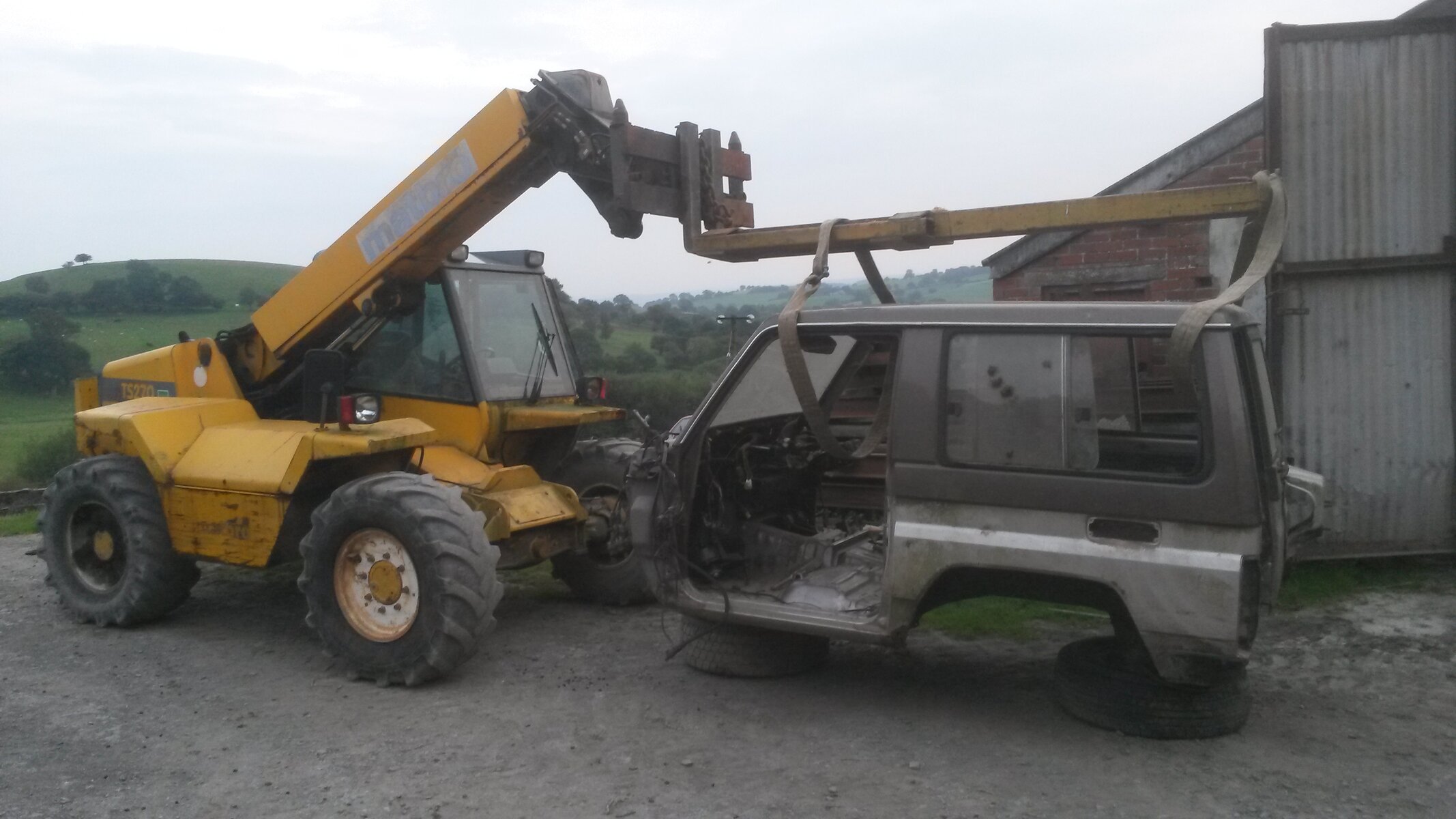

Then got the body out. .
Matt had a couple of spare hours to come and lend a hand thankfully!
Would have been a difficult task on my own. But looking real good now. Am really pleased with my new cruiser!!:icon-biggrin:
Was pretty much dark when we finished. . It also has the full set of original doors on it too. 8-)

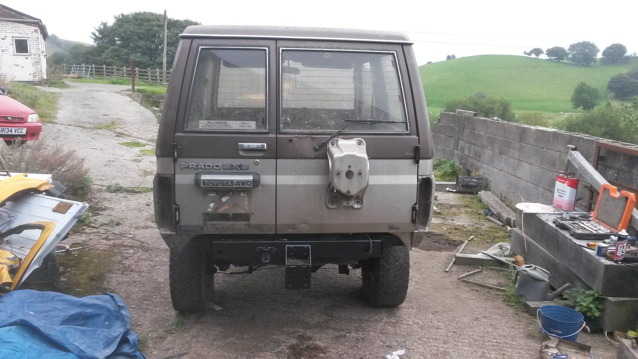

Lookin good Iwan , have to wonder why you didn't spray paint the body before fitting it though surely it would have made painting much easier .
Good point there mate.. it comes down to time really. The paint shop wanted the body for 3 weeks and said they needed the trailer it was on.. its needed for work.. then the body ended up in my works workshop and have a big job starting next week and it needed to be the hell out of there. The silver brown is growing on me. But it has to be white! But next year! Cheers Shayne:thumbup:

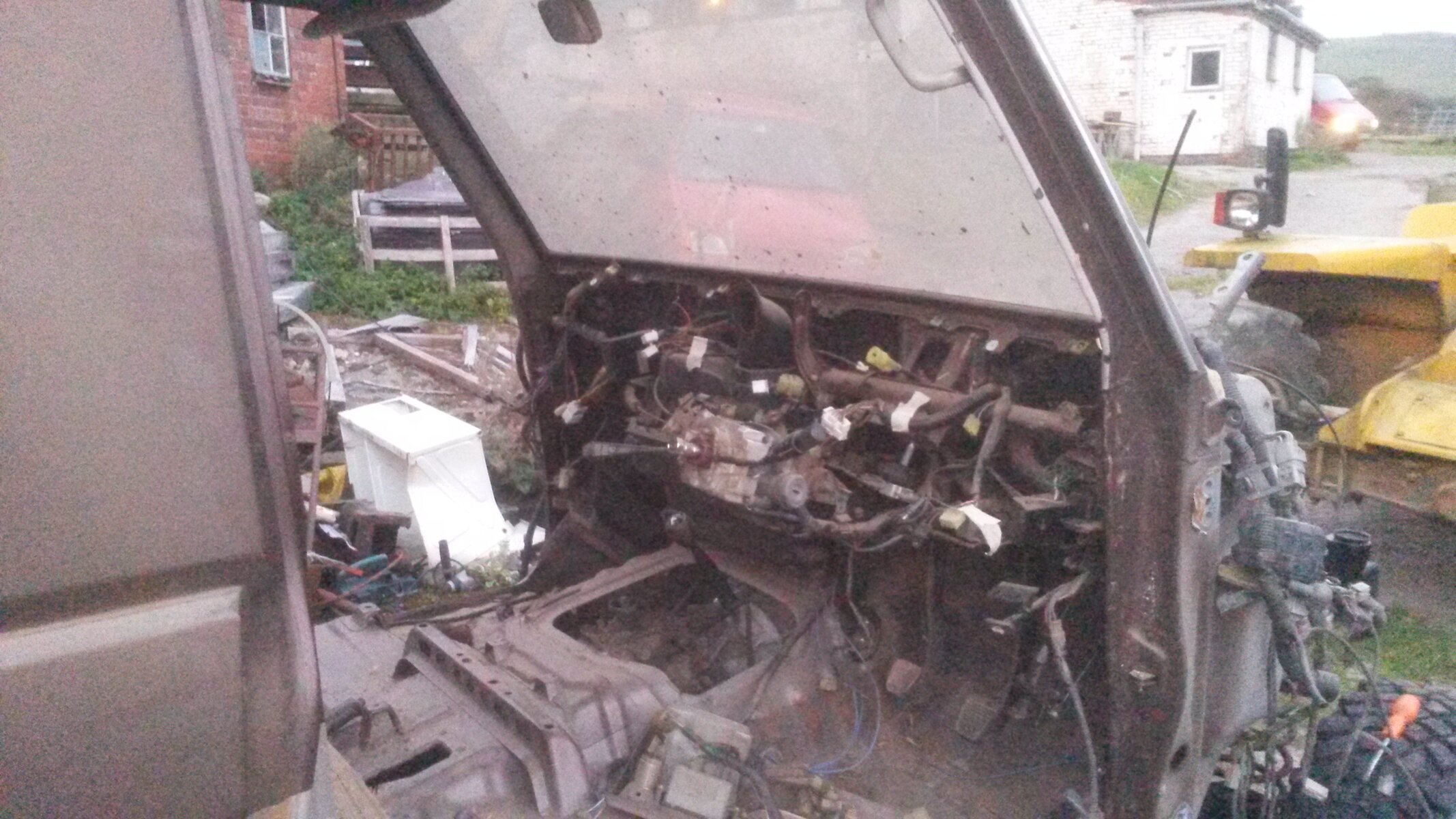

I have all the dash out ready for the D4D loom to go in.. There's a lot of cleaning needed to all the dash components.
Sweet with some doors.. rust free.
Looks like a 70 series to me now!!:icon-cool:

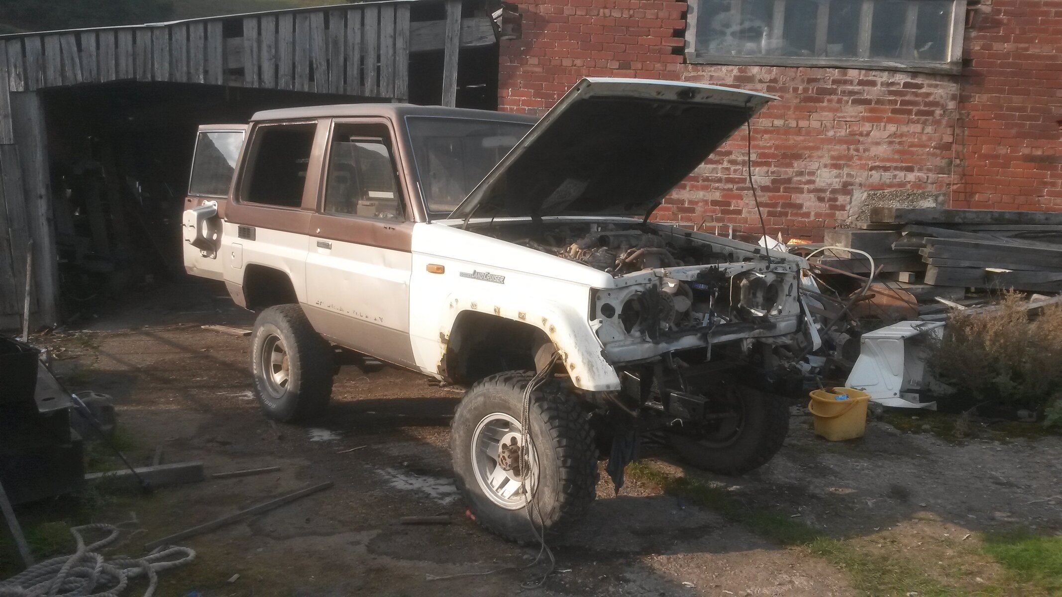

bonnet issue!

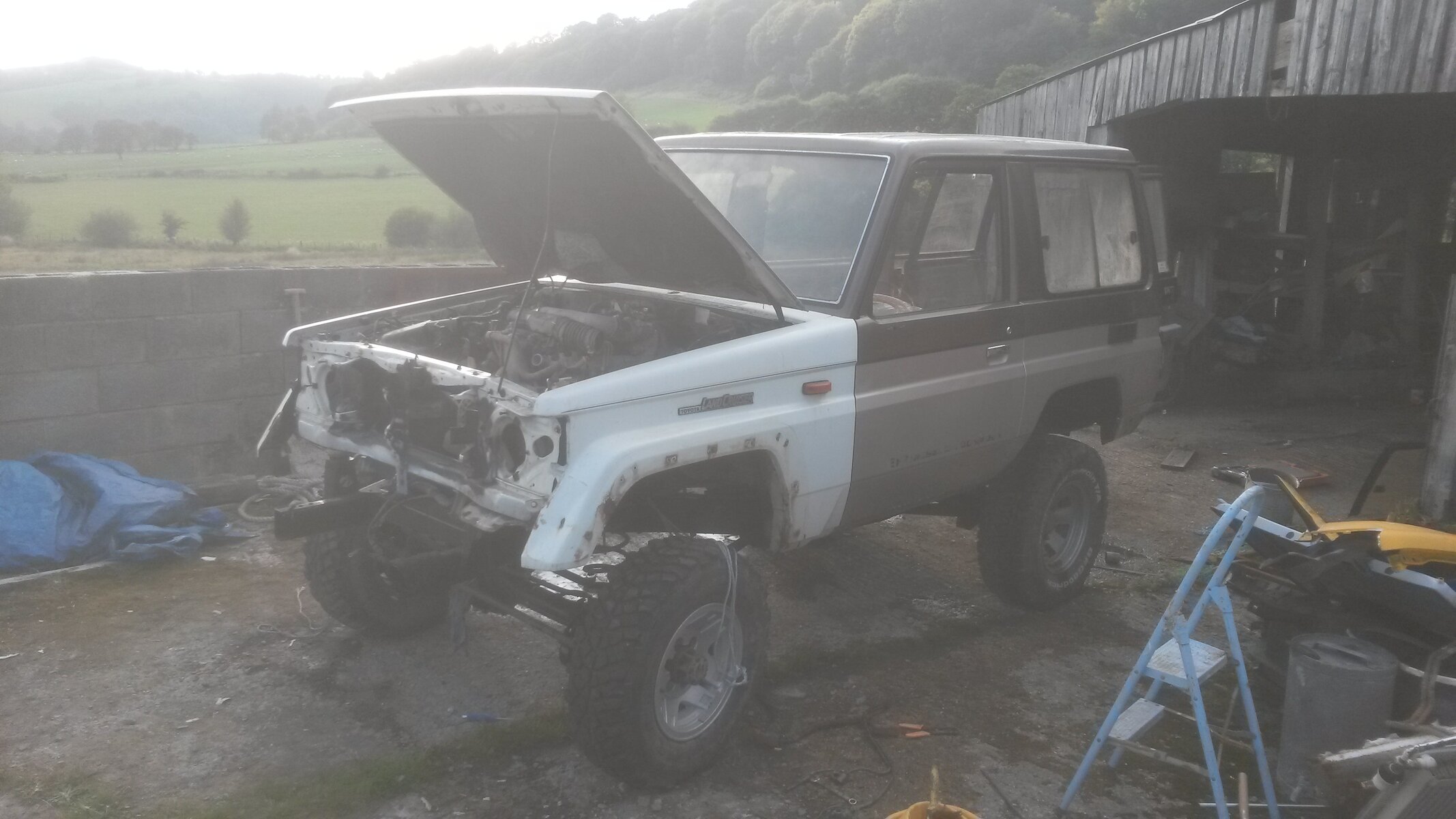

Had a pleasurable time fitting the front end... nice to see the white bodywork going back on..
Didnt have much time to take many pics. .
Am well pleased with the result. Showing great shape.. but...
As expected the bonnet is tight on the top of the engine. The turbo is set quite high up. So its looking like a body lift of 50mm is in order and to drop the engine mounts too.
