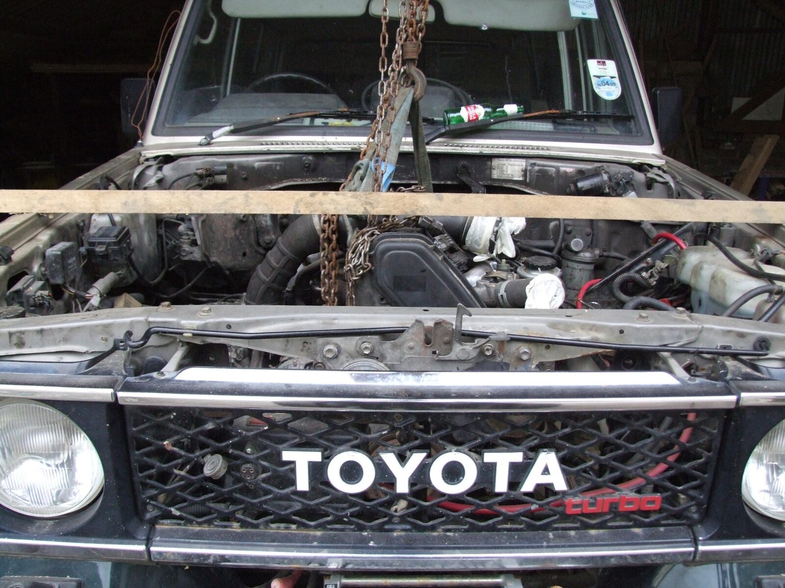

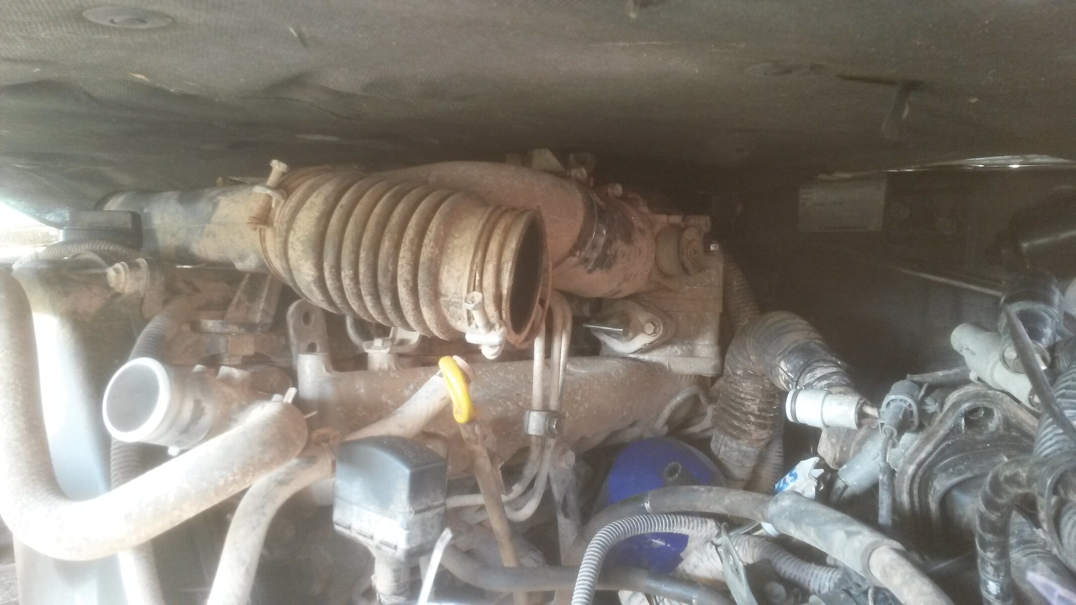

A couple of good points there lads. It's pretty tight in there!

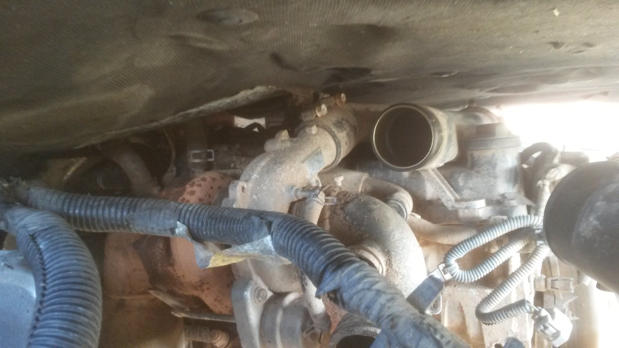

The turbo air feed alloy pipe is at the end closest to the hindges and the egr unit on the inlet manifold spaces it up quite a bit.
The turbo is set real high too. So worried that the bonnet will get too much heat and burn..

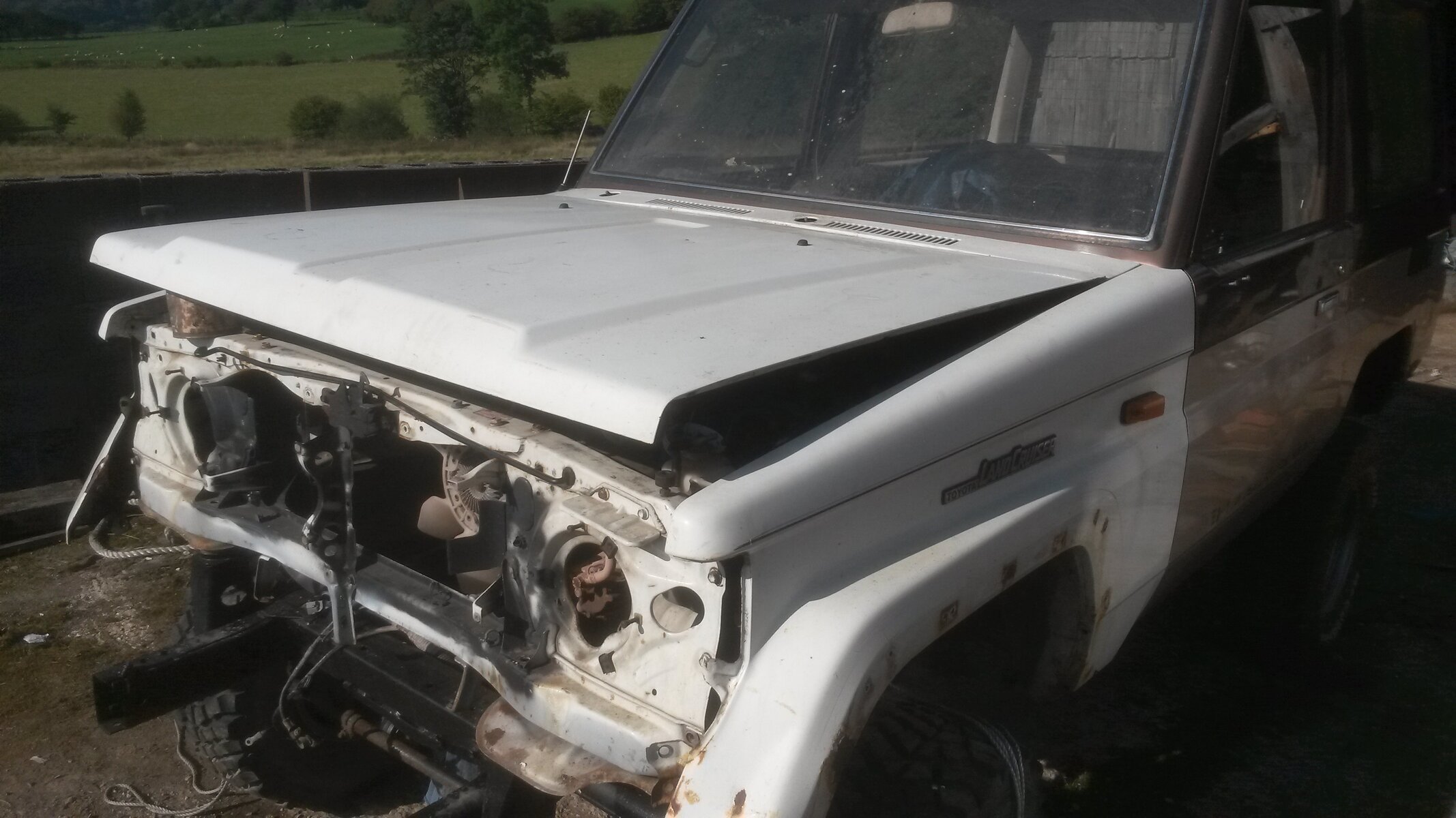

Really like the shape of the bonnet on these early 70's. They have the shape of the 40 series bonnet pressed into them. Old school! Kinda want to keep the standard look with it..it's all fun tho!!!:icon-biggrin:
I would go with Gavs suggestion of a scoop Iwan a 50mm lift would make the truck look out of proportion and dare i say top heavy , besides you just cut a hole and bolt it on , an hours work max , how long will it take you to add a body lift and alter engine mounts !
We crossed posts looking at your pic the bonnet doesn't really support the scoop idea , best i can think of is to cut out and raise the formed center of the bonnet but surely that would be time consuming .
50mm lift is fine if you run 30mm wheel spacers. Not sure a 50mm lift will give the gain you need for the bonnet. Reckon it's time for the lift, spacers and cut out the bonnet for a supercharger :lol:
Just run with out the bonnet simples. I ran my Defender without one a few times and its very strange. you end up watching the fan go around and crashing
Some great ideas going around guys! Much more interesting than work! Planning on running big tyres and have some 30mm wheel spacers here.
I will have to see if I can get the egr programmed out of the ecu then can loose the egr spacer block on the inlet then reroute the turbo pipework away from the top. Would help I think.
Was thinking of using a water to air intercooler.... if it will fit in! Still got the air conditioning rad to fit in the front too. Its filling up under that bonnet lol!:think: Thanks guys!:thumbup:

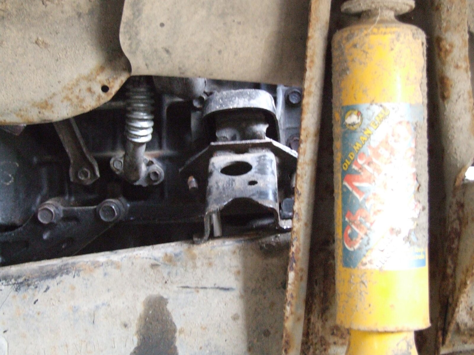

Personally, I think if you can drop the engine in the bay you should work on that rather than any lift/bonnet scoop. And by the looks of it it'll be more than 50mm clearance you need, I would estimate near double.

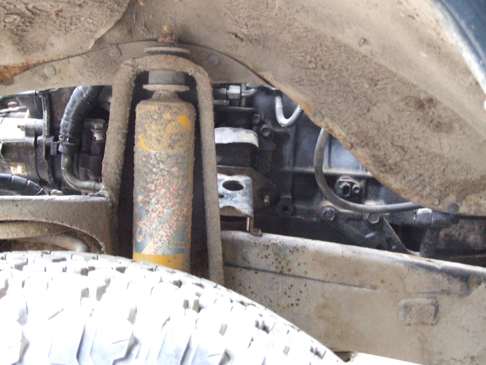

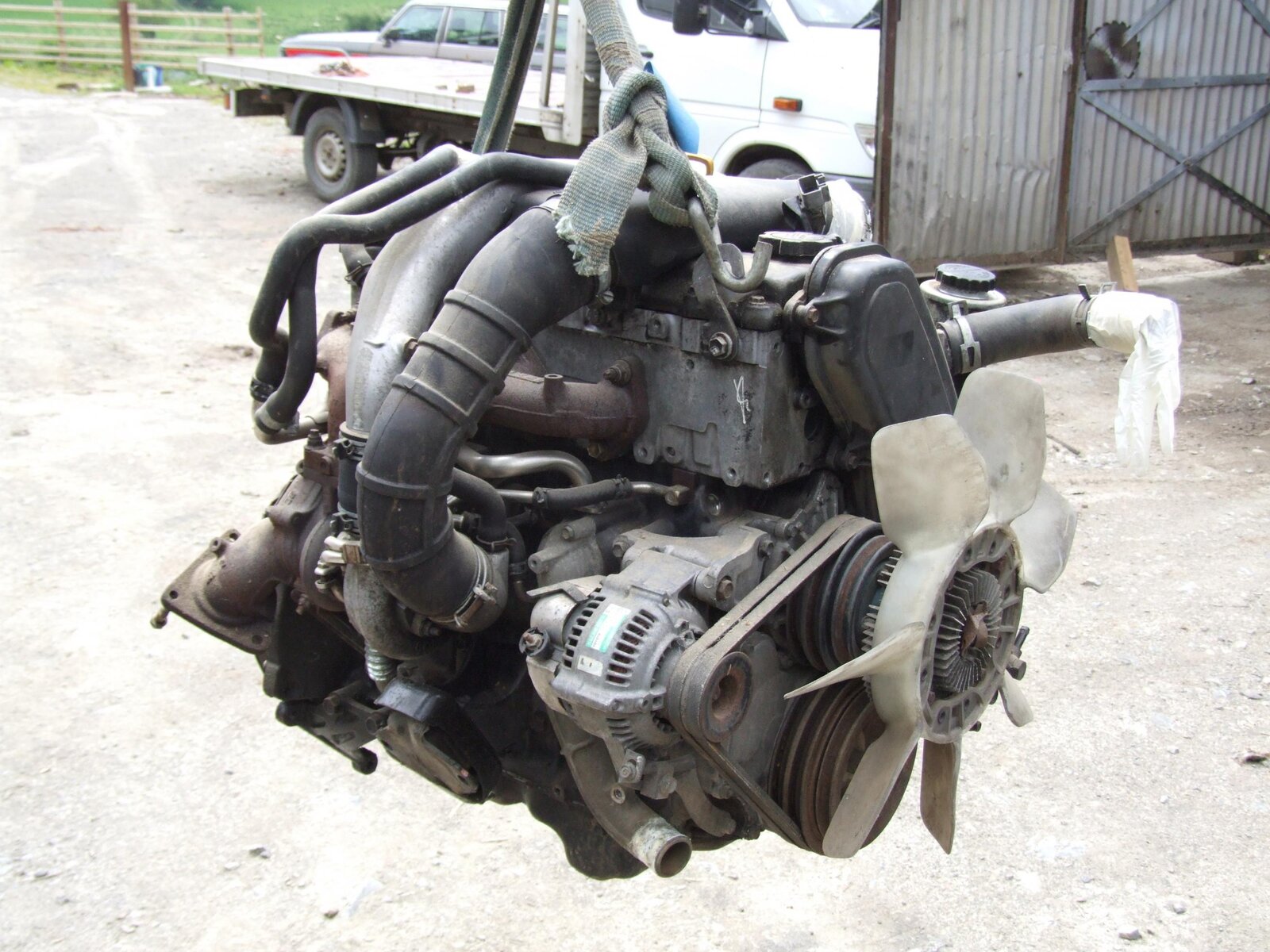

I agree with the setting of the engine mount heights. But there's an air of caution with how low you go as the IFS sump will come into contact with the front axle if dropped too much. This is the 1kzt that I fitted to my 1st lj70 in 2010 ish.
The trouble here was less of an issue that I have on the current 70 project. Cambelt cover was stopping the bonnet from closing! Or too close for comfort! Looking here the 1kzt is a hell of a lot leaner on the top side! In comparison:think:

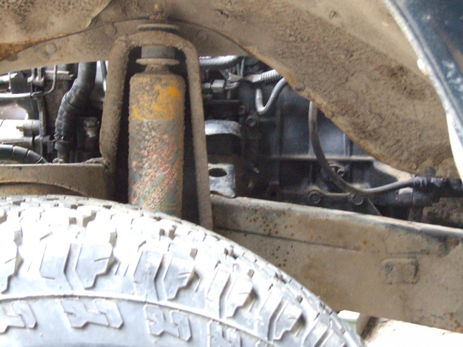

So with the mount loose and the 1kzt sat at the same height as the D4D is.
I believe the senario is identical to the current, height wise upto the top of the block.
So I scribed the mount down untill the rocker cover was level about 25mm. You can also tell from the casting line on the block there now that it is much more level.
I didnt go any lower as didnt want it to look wrong with the engine sloping downwards on the cambelt end.
