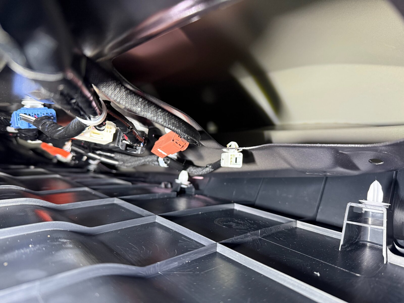

Finally, I resolved this one: the power tailgate on the LC300 has two finger entrapment pressure strips on the side of the tailgate itself. They plug in behind the plastic trim attached to the inside of the tailgate. You can only access these plugs by dropping down the internal trim mounted to the inside of the tailgate. They are not accessible through the switch holes or blanking plate hole on the edge of the tailgate.

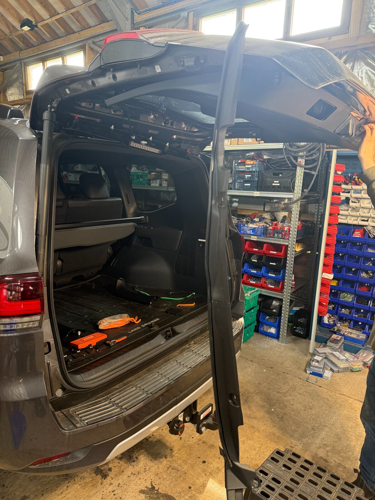

I have attached a photo of the pressure-sensitive strip which I have removed and left hanging on its cable so its easy to identify. I have also attached a photo of one of the receiver connector plugs inside the rear tailgate.
