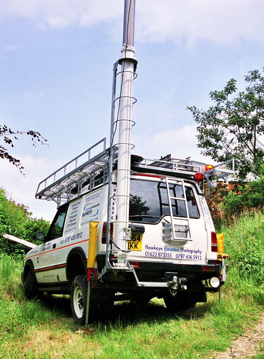

    Prospeed Rear Exhaust section
    I assume one could also get Prospeed to make just that back angled section and cut off existing tail pipe nr. wheel arch and clamp-on new section.
    I need for the exhaust not to protrude to the rear, so that I can put a steel cross member right across and out the side, to mount a pair of hydraulic legs, and much more equipment from my old LR Disco Tdi.
