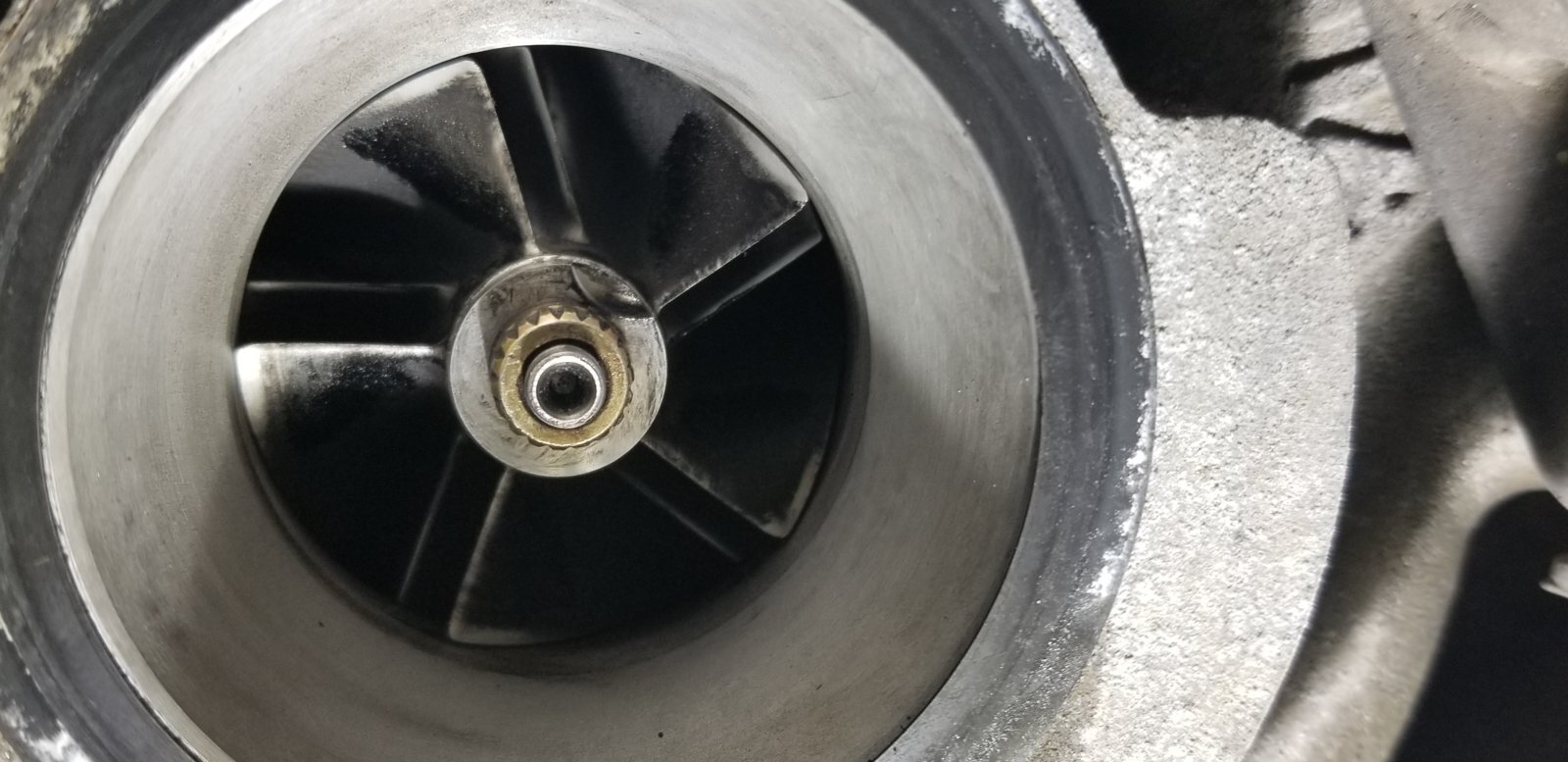

It says check your turbo is working before changing anything. In fact you shouldn’t change anything until it is proved faulty as you’ll be wasting a lot of money if you do. I know, easier said than done. I still think it’s turbo related so do that drawing of the vac pipes and post it up.
Hi I attempted the turbo yesterday but it proved too much for the time I had but I did get to check it for play which was there but minimal
Pic below
