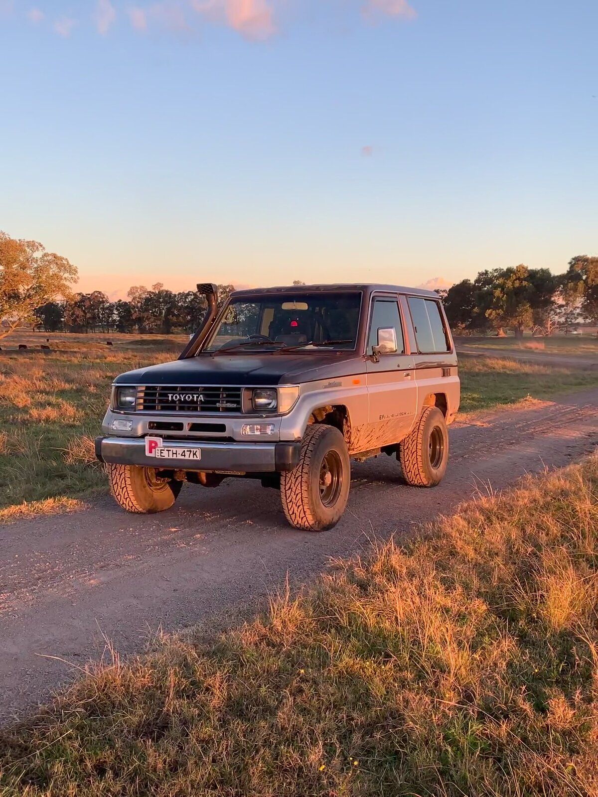

have a 1991 lj71 prado with the 2lt turbo diesel engine, want to do a 2-3 inch lift. just want abit of guidance, has anyone else done a lift on one of these and what works best?

so done abit of asking around, in order to achieve a 3 inch lift....
rear - stock front springs in the rear along with stock 80 series shocks. (alot more travel)
front - 3 inch kzj78 in the front + stock 80 series shocks.
not 100% on this but can work as long as the shocks are pin bottom and round top
