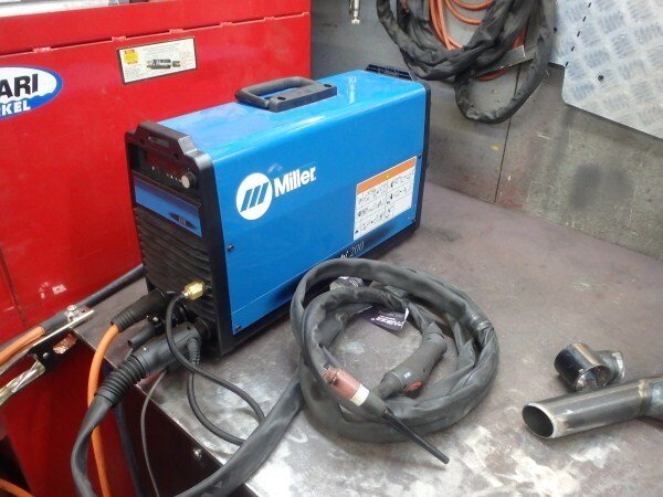

I'm certain an electric motor won't work, not sure if a welder may be different.
What I meant in my Noddy way was if a single phase motor was wired to one of the phases on a 3 phase supply, then it would work (would it not?). The 4 pin plug would just be for the sake of continuity of plugs/sockets only.
I'm assuming that the welder is actually single-phase, meaning I see your point that no 3 phase equipment will work on a single phase supply, full-stop. (period as the Americans would say...)
The welder must be 3 phase why would it have a 3 phase plug fitted otherwise? unless of course it's only there to plug in at Bens workplace, in which case Ben didn't need to make an adapter he could just replace the 3 phase plug unless it would still be used at work. I'd like to know how Ben wired it to a three pin plug. You are right about the motor it would work tapped off one phase.
The welder is a very advanced piece of machinery that will run on any voltage!
Right from 110v in the USA to 500+ in Russia! :icon-cool:
Which was one of the major selling points as it means I can use it at work on 3 phase 415v and use all 200 amps of power!
Or I can bring it home and plug it in to single phase 240v and get maybe 120amps out of it.
I've only had it up to about 110amps so far and it worked great and the plug didnt get hot etc. :dance:
Its difficult to wire a 240v plug straight to the end as the cable is far too thick, so having a 3 phase plug then an adapter to bring it down to 240v single phase works well. :icon-smile:

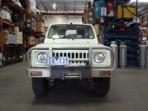

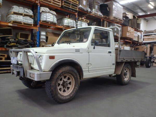

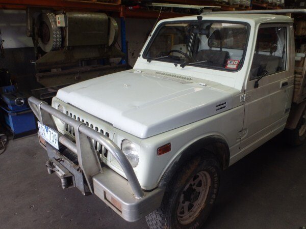

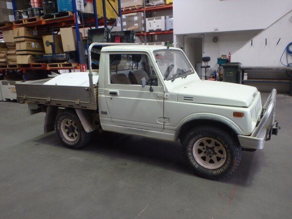

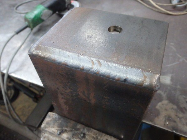

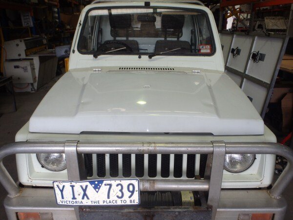

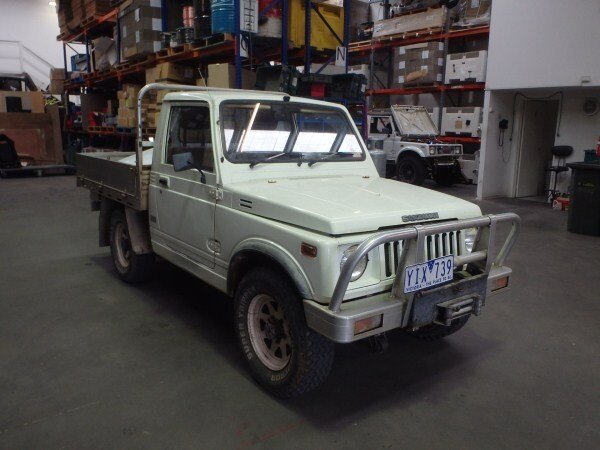

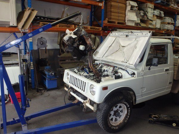

I started a big job on a customers Suzuki this week.
The car.

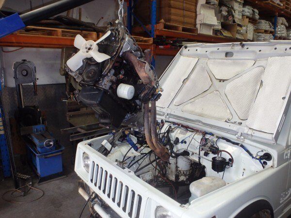

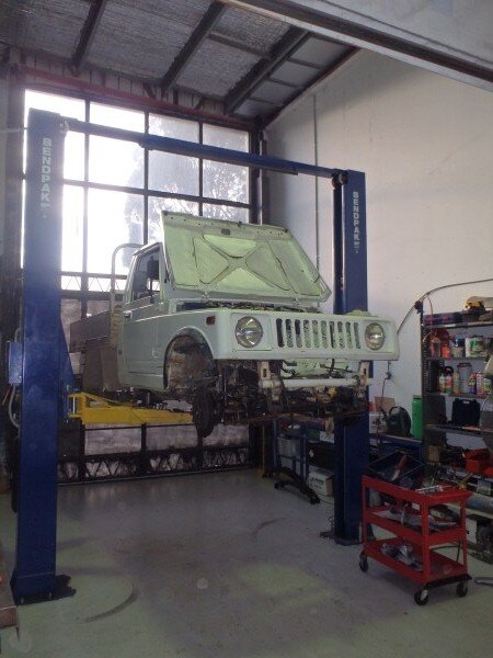

I've got to do an engine conversion to replace the tiny 1 litre with a slightly bigger 1.3. The first job was to fit a bonnet from a 1.3 which has a bulge to allow for the higher engine.
I pulled the old engine and gearbox out.
With that done I got it on the hoist for a full front end rebuild of the axle, with all new bearings and seals.
While on the hoist I've got to change all the suspension and remove and clean the fuel tank out.

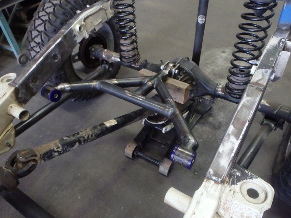

On Friday I finally got a day to work on the Jimny project.

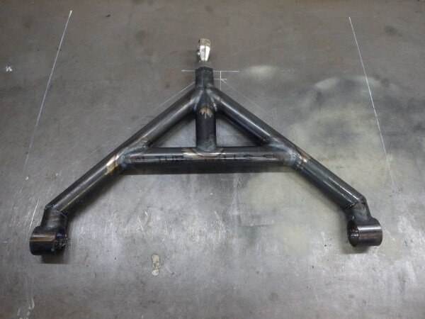

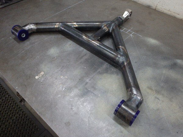

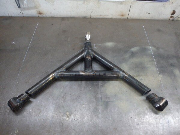

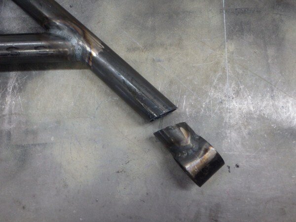

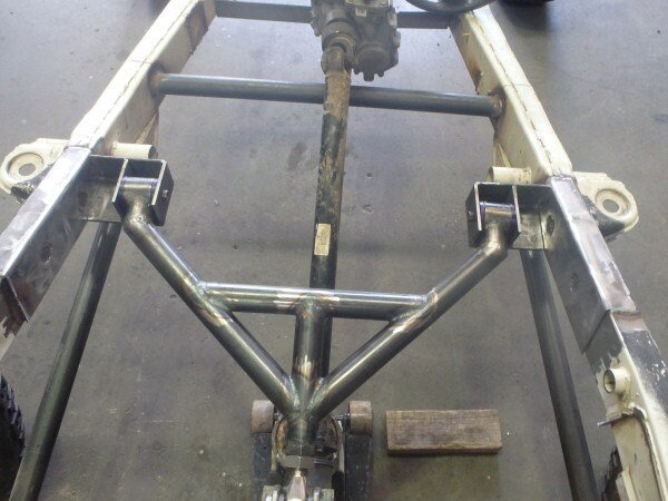

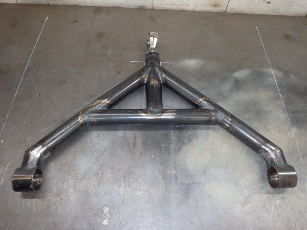

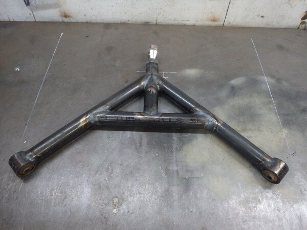

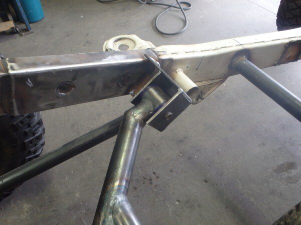

First job was to alter the A frame on the rear suspension setup.

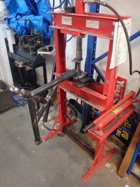

Removed the A frame.
Pressed the bushes out.

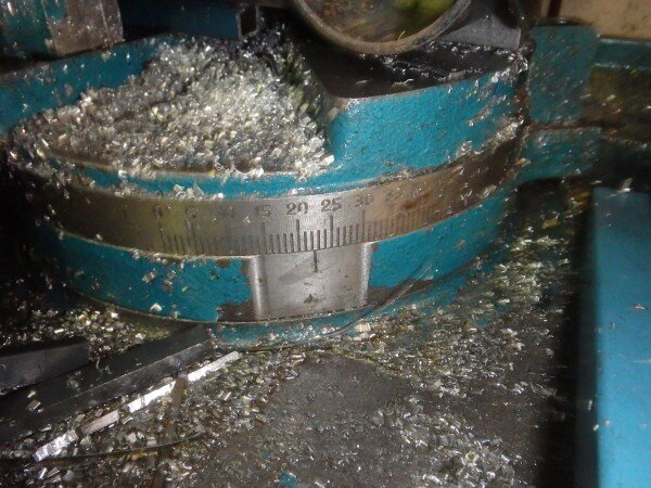

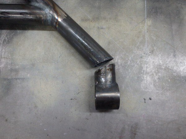

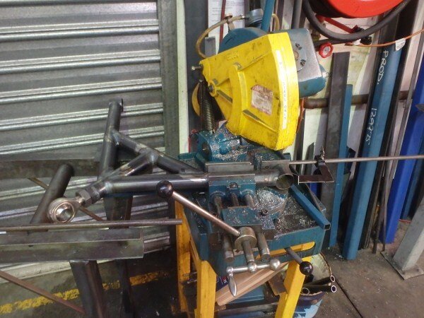

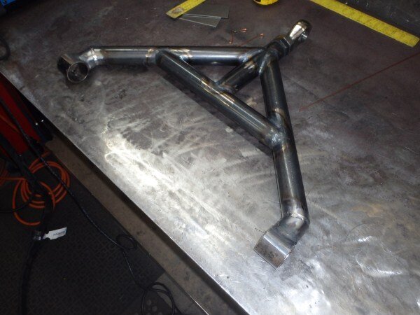

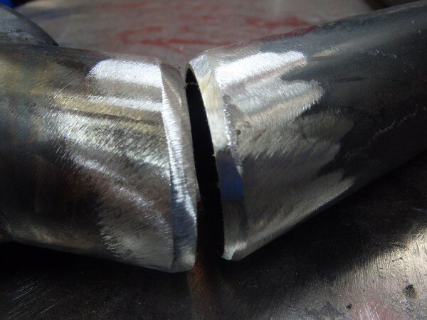

I could then put it on the Brobo saw to cut mounts off.
22.5 degree cut in order to turn the mount 45 degrees.
I could then turn the ends around.

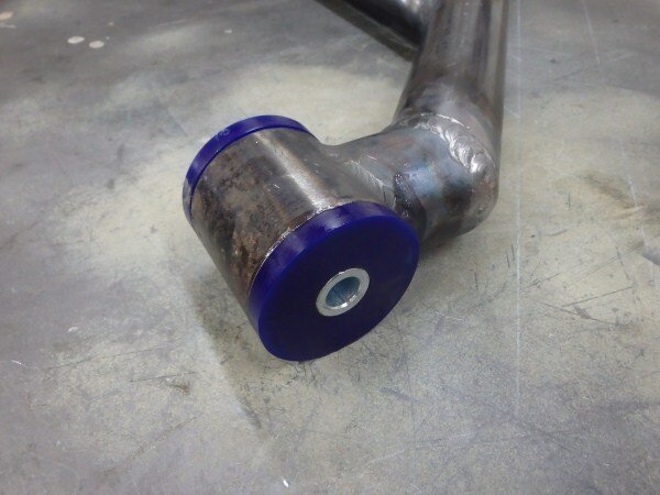

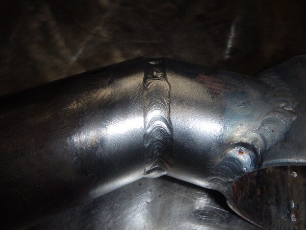

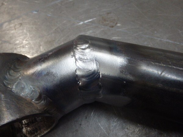

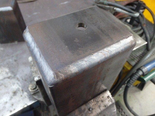

To ensure a really strong weld I ground the ends of the tube to ensure I would get full root penetration.
Got my TIG setup.

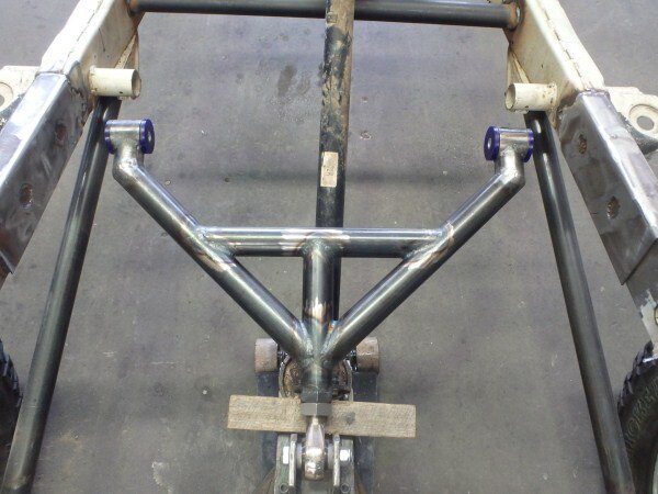

Welded it in 2 passes, a root pass first.
Followed by a capping run.

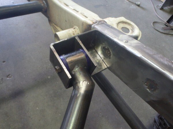

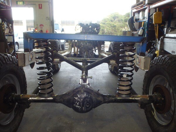

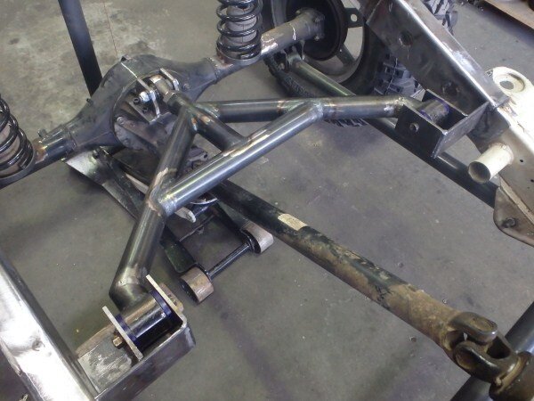

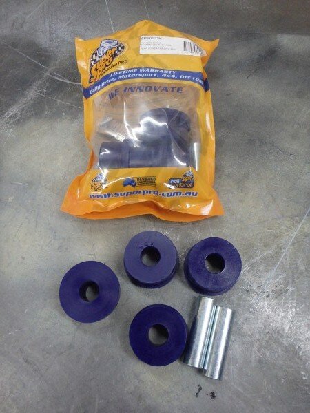

Got some new bushes.

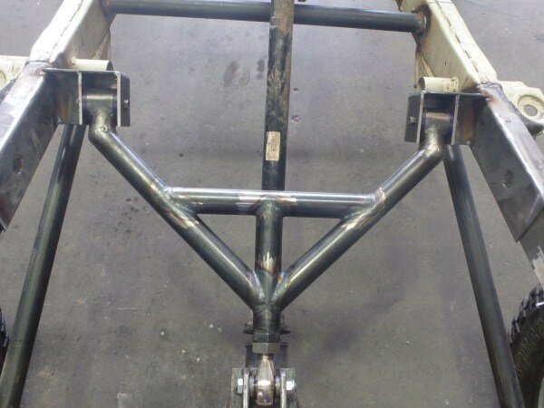

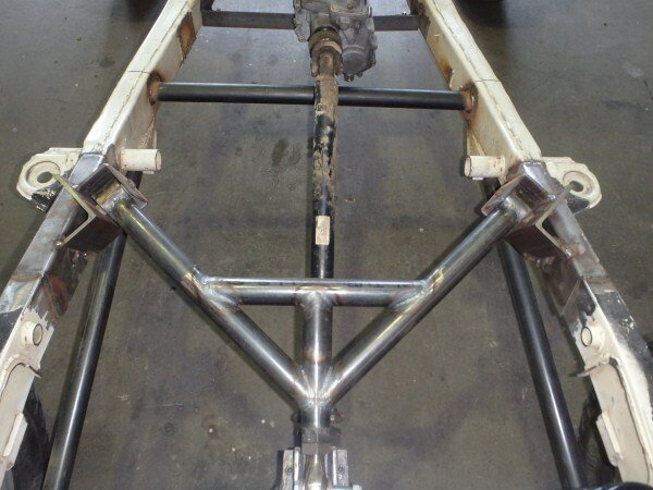

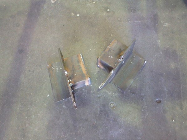

Cut the old mounts off the chassis.
Bolted the A frame in position.

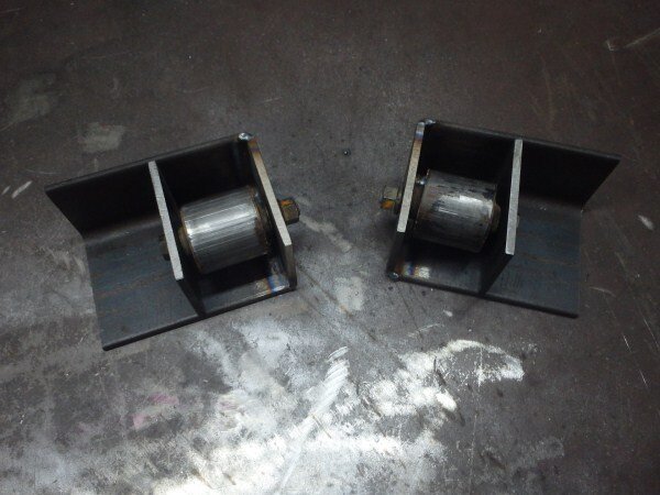

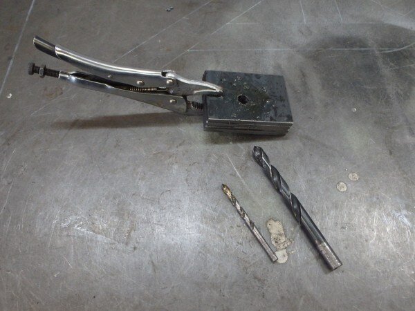

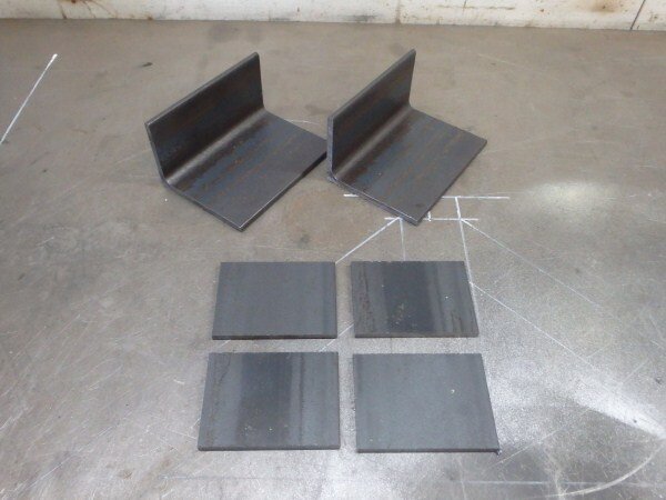

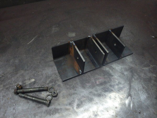

I cut some 6mm thick steel.
Clamped the 6mm flat together and stack drilled it on the pillar drill.

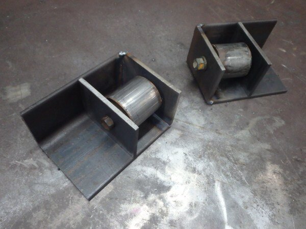

Welded a piece of flat on the end of each piece of angle.
I bolted the other pieces of flat in position using the old bushes and welded the flat to the angle.
Bushes removed and ready to be welded to the chassis.

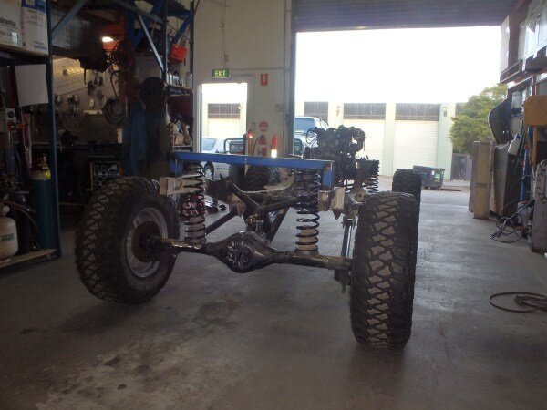

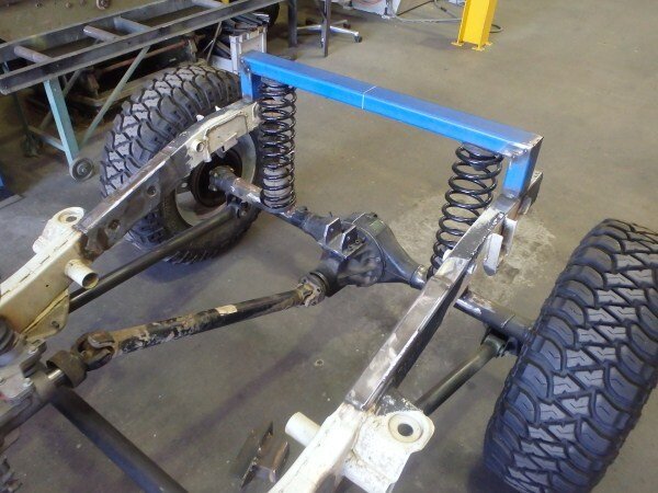

I could then test the articulation.
There isnt any weight above the rear springs so I think thats why their not compressing. With the cage, fuel tank, batteries, winch, seats etc. it should work better, if not we can source some softer springs.

I got to do some work on the project this week, but just for one day.
The first job was to work out where the front hoop of the cage would be.
The old body mounts needed removing.
I decided to trim the back off the Jimny dash board in order to mount it closer to the engine rather than wasting space now the buggy wont have a heater matrix and ducting.
I could then work out exactly where the front hoop would sit.
I want the cage to bolt on and off so we can get it powdercoated.
12mm plates drilled and taped to weld to the chassis and 6mm plates to bolt to the 12mm plates.
12mm.
All the plates bolted to the 12mm ones ready to be welded to the chassis.
I tack welded 2 of them on to the front of the chassis.
I could now work out the first hoop.
Marked it out on the floor with chalk.
Bent some tube.
The next bends proved to be a bit tricky as I was trying to bend the tube on a bend.
This meant as I started bending the tube it was trying to rotate the tube towards the other bend.
I did get it eventually though after ratchet strapping the tube to the pallet racking to stop it rotating as I did the second bend.
More bending.
I had to cut the ends off the hoop so I could bend it more.
Tacked in position.

And drilled some 6mm plates for them to bolt to which will be welded to the bottom of the rack.
I cut a load of pieces of 30mm angle.
And started welding them to some 50mm flat.
Thats as far as I got on that project as I dropped everything to work on the other project. (I've just updated that thread :icon-wink:)
