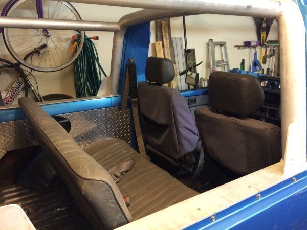

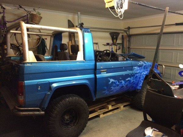

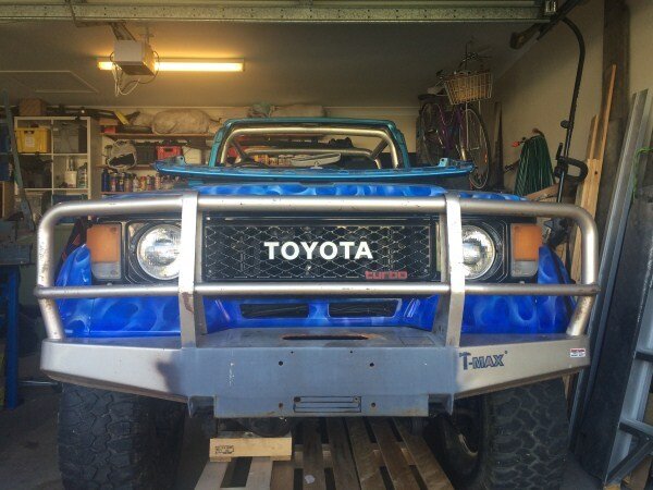

Where did you find that pic Doyle? As far as I know Toyota never made and sold such a roof, but there is a chance they did in select markets maybe. :think:
I found that one on this site, can't remember the thread though. As I said I've seen 70's advertiaed before with this roof, only a couple of times in fairness but I do remember seeing them. The 70's I saw them on were adds on autoscout24 and I think they were german cars
If you part it out Ben I want the doors please. :)
If I part it out its the rare soft top body (with doors) that I will be keeping, I dont actually need anything else. :icon-smile:
Thats very interesting! I must have missed that thread. :thumbup:
I'd say seeing that Toyota obviously did make and sell them, but I dont believe the Australian market got those FRP tops. :think:
I think I will just run mine topless all the time and keep it garaged when its not being used. :icon-cool:

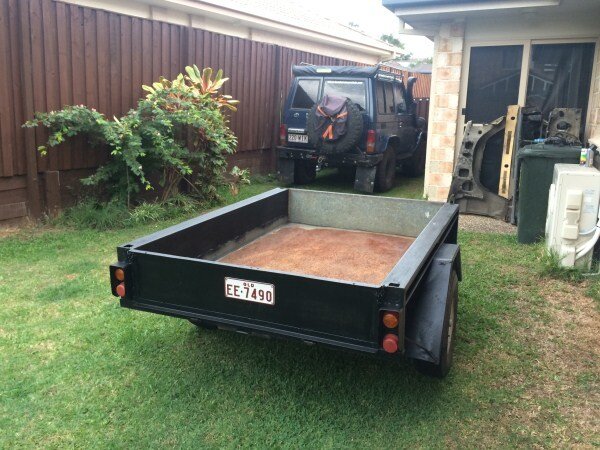

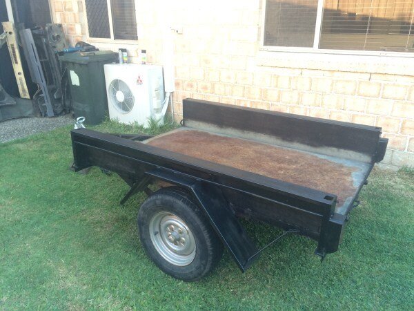

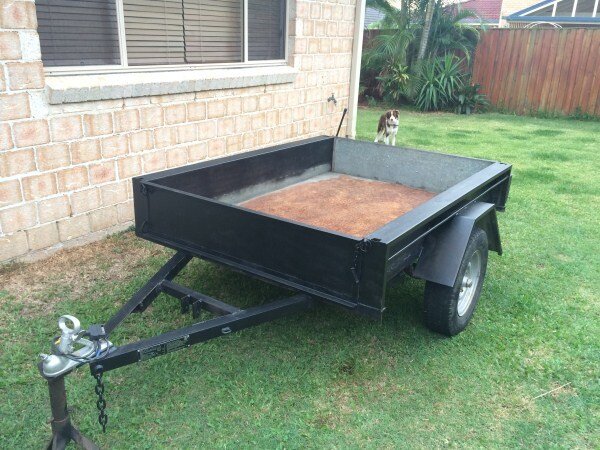

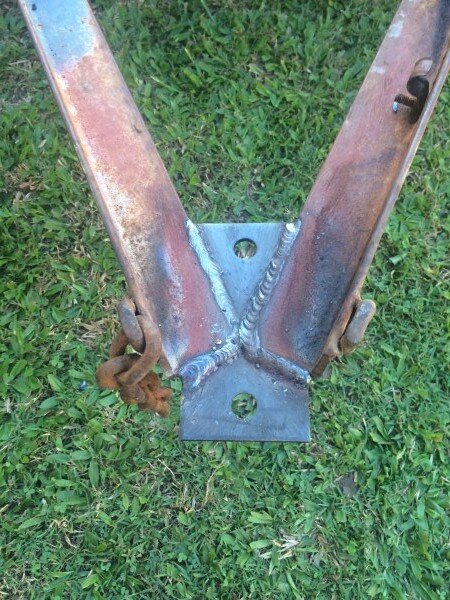

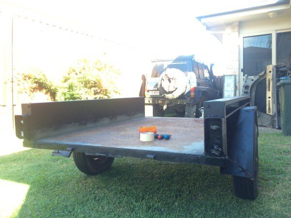

Trailer Project.

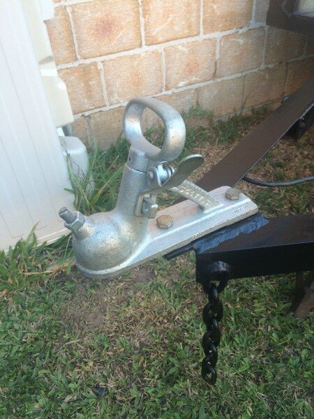

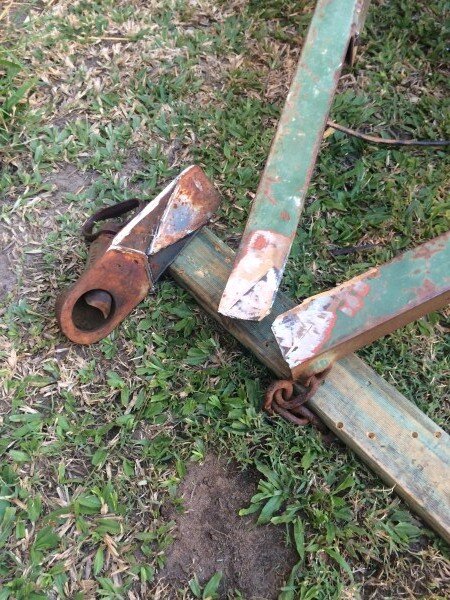

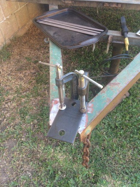

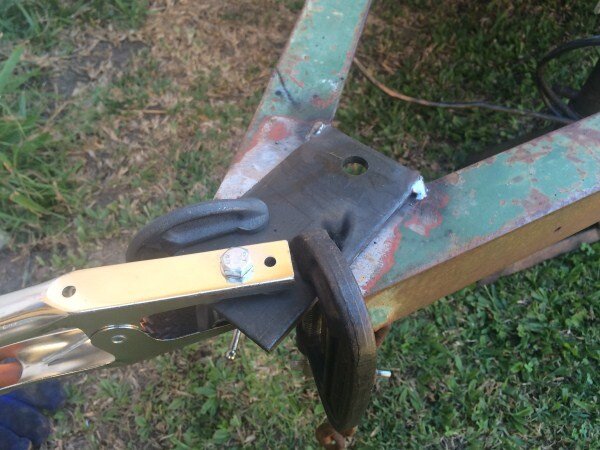

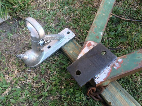

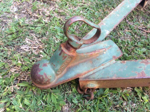

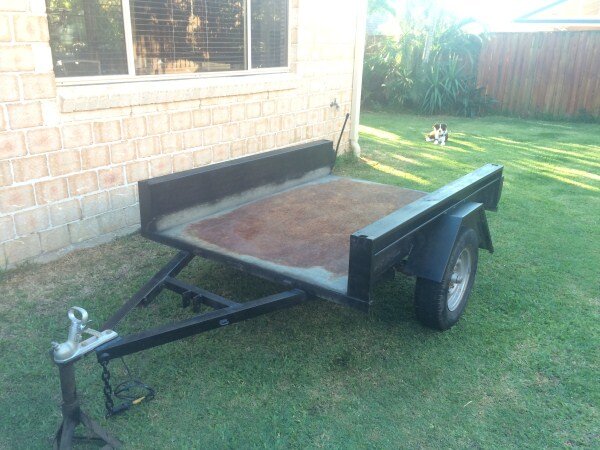

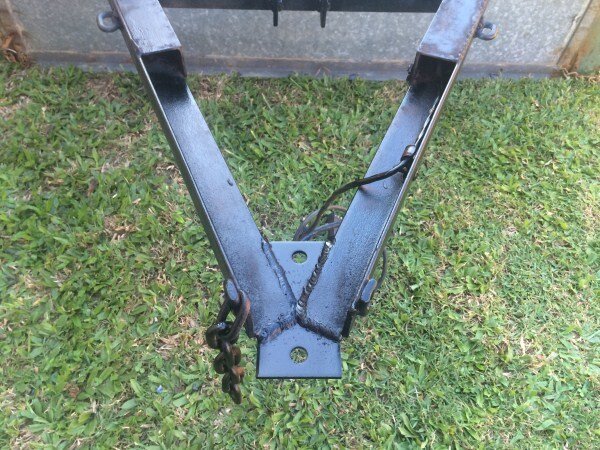

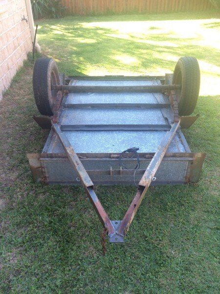

Needed to change the old imperial hitch for a metric 50mm one so it would fit my cars.
Cut the old one off with the grinder.

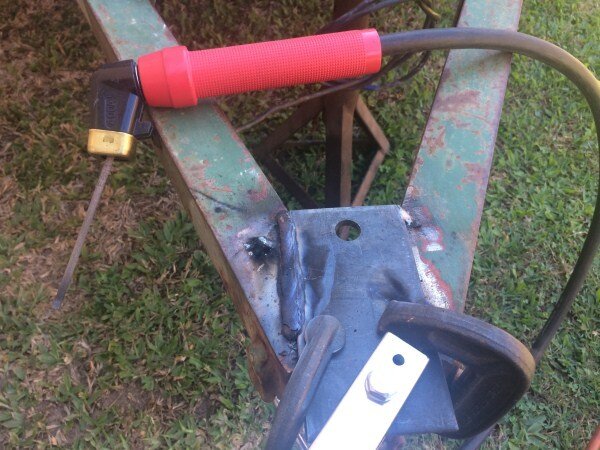

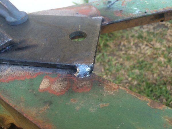

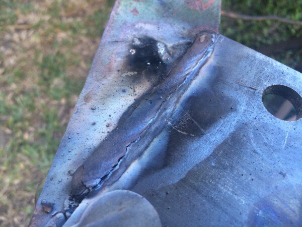

I then needed to weld the plate on that the new hitch would bolt to.

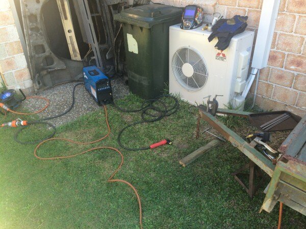

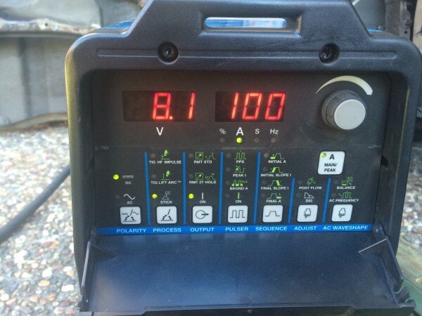

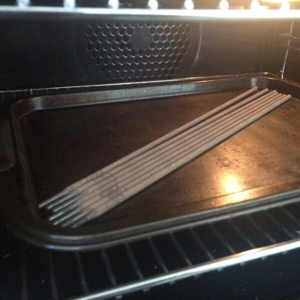

Dug out the Miller that hasnt been used since we left Melbourne.

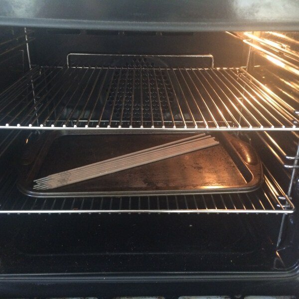

Heated up some welding rods in the oven to dry any moisture out.
Got setup.
Did a few tacks.

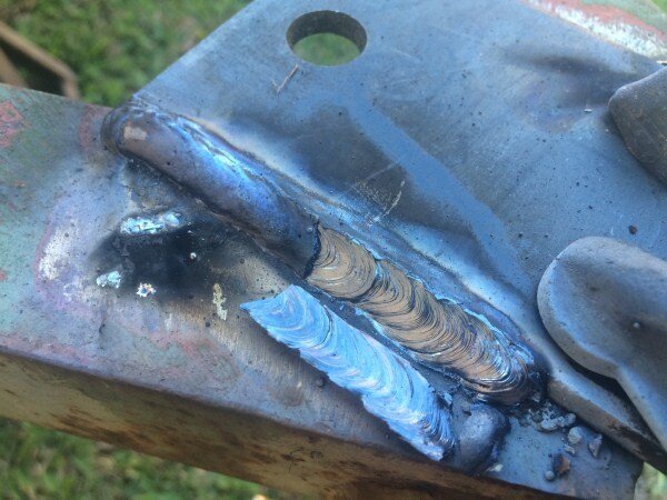

Followed by some full welds.
The slag was just starting to lift off, not as good as I've had it before, as I've had it completely peal off along the whole weld and curl up like a snail.
Flipped the trailer up and welded the underside.
Followed by a coat of paint.
Decided to re-grease and tighten the wheel bearings while I had it up side down.
Flipped it back over, gave the welds a paint and bolted the new hitch on.

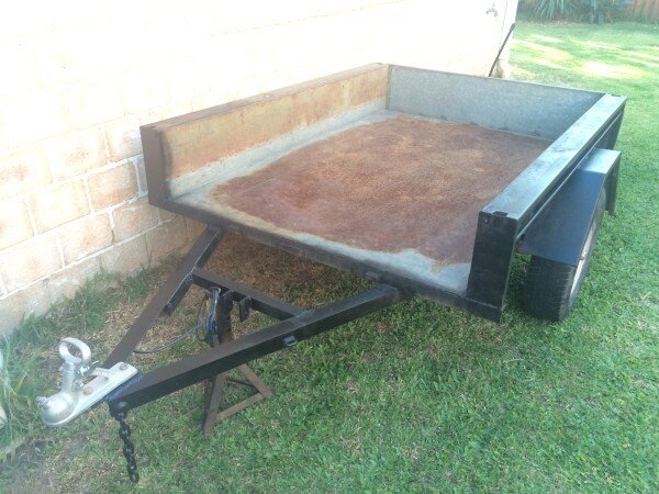

Decided against giving it a proper paint job in LJ blue as the trailer is pretty rusty anyway. So just painted it with rattle cans.
Once it was painted I could fit the new number plate to the back and vin plate to the front.

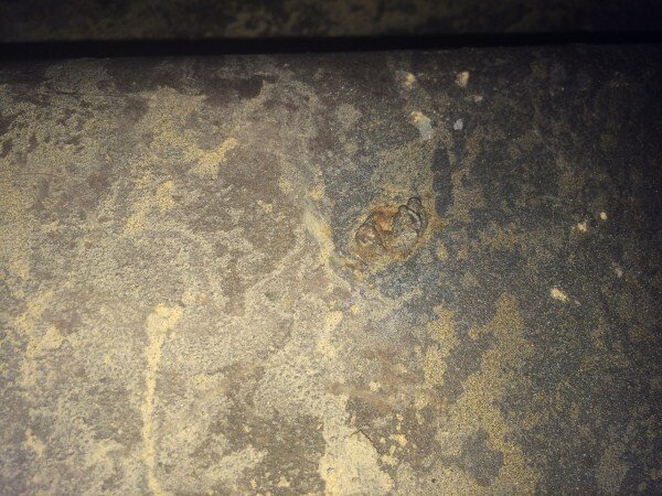

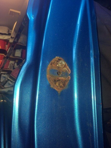

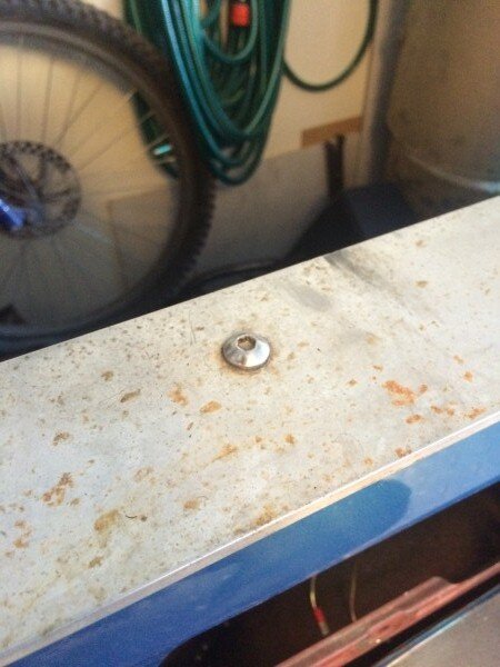

I removed this rusty part from the B pillar.
As it was causing the body to rust. :thumbdown:

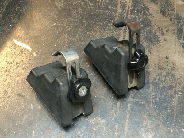

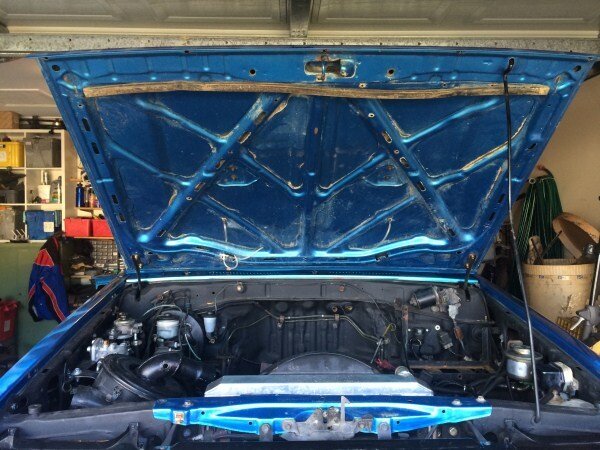

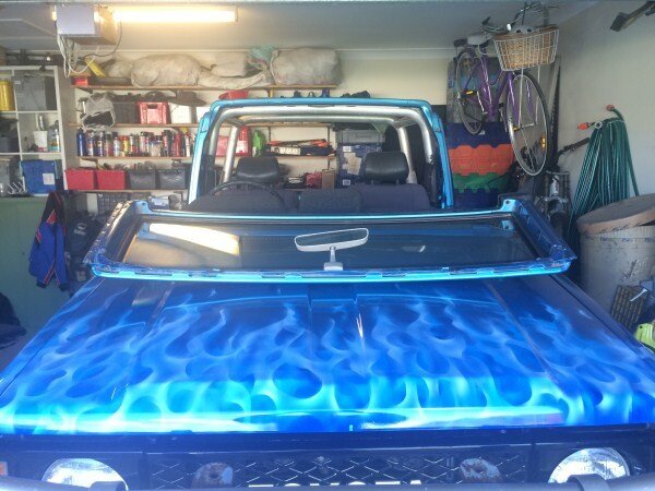

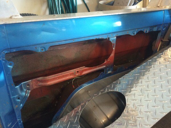

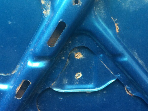

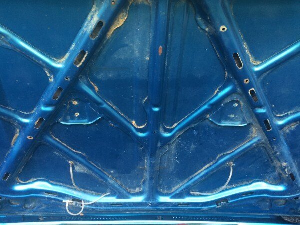

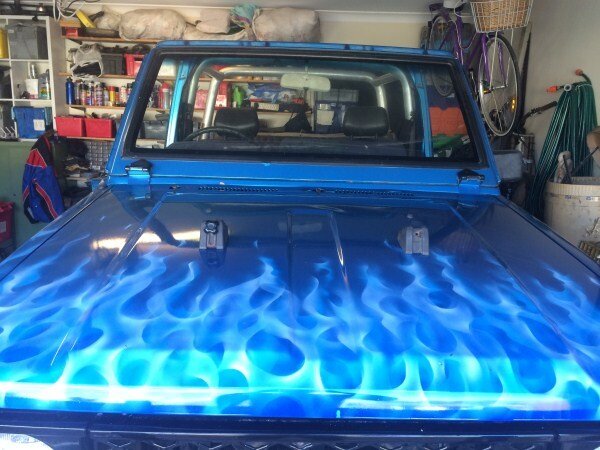

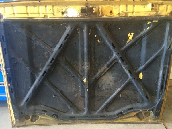

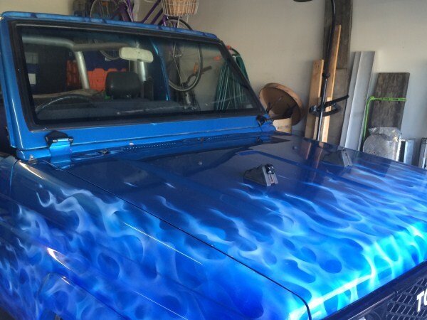

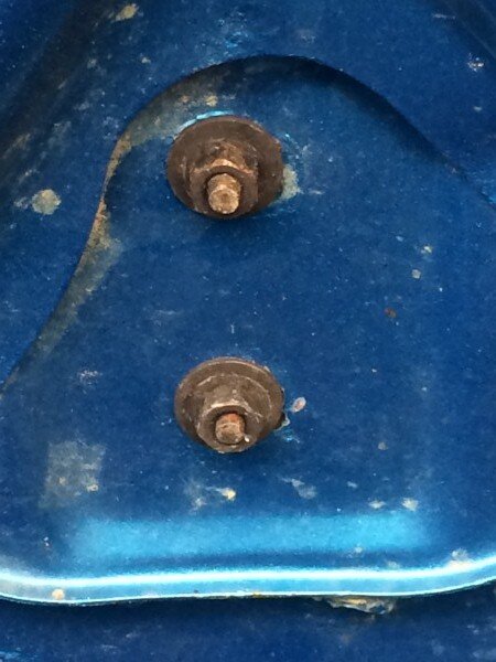

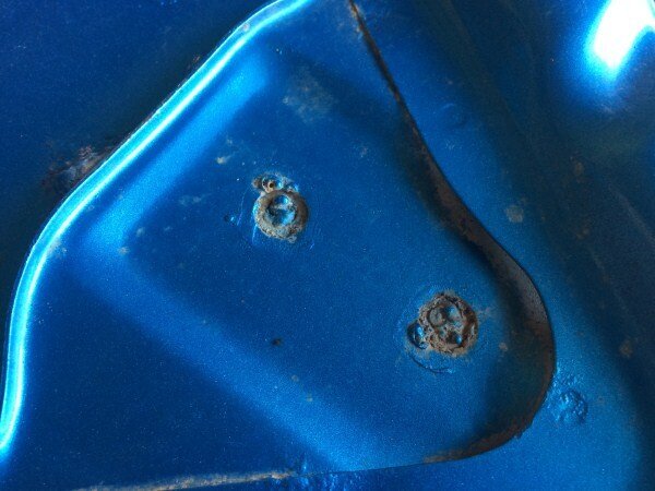

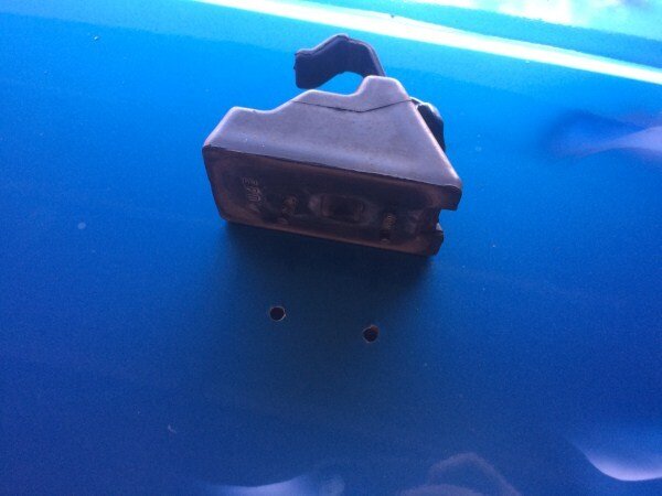

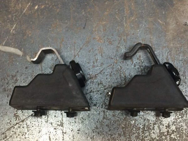

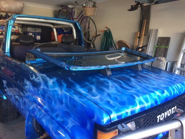

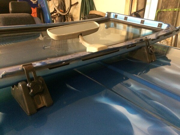

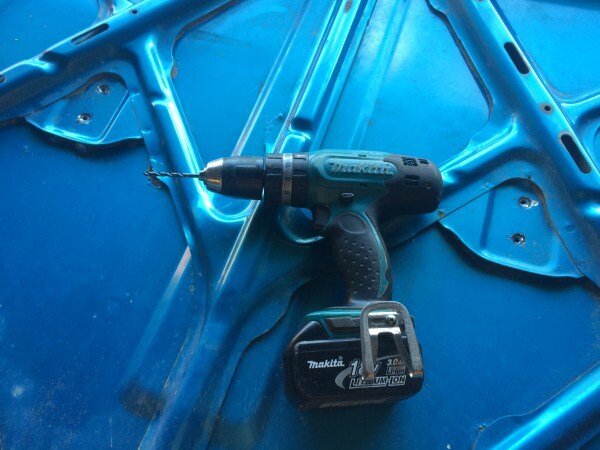

I want to re-fit the windscreen hold down brackets to the bonnet.

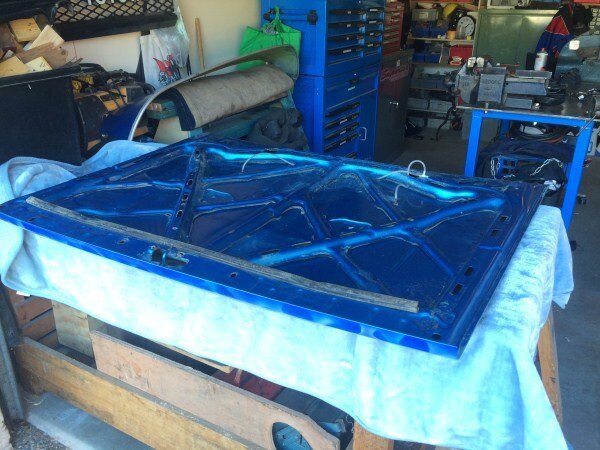

The hard top bonnets arnt designed for the hold down brackets as they dont have the extra rib underneath.
Hard top bonnet.

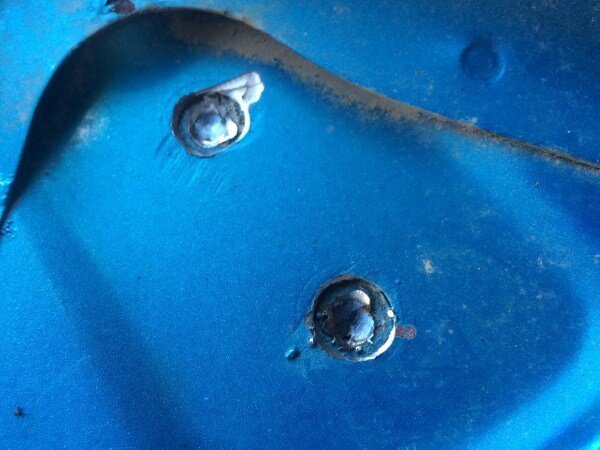

Soft top bonnet, complete with welded up holds.
So I will have to drill the welds out so I can bolt them back on.

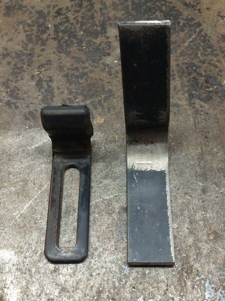

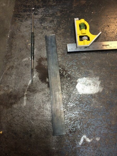

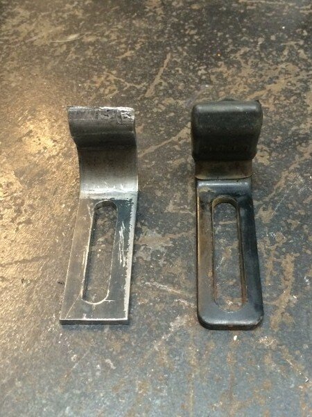

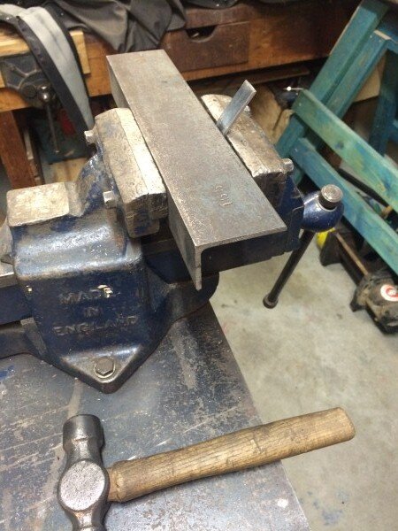

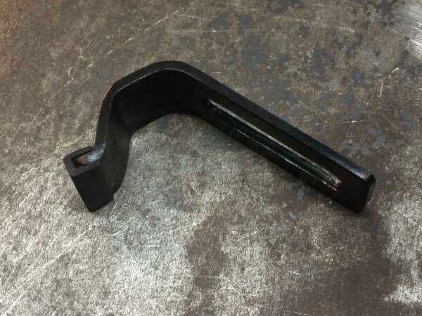

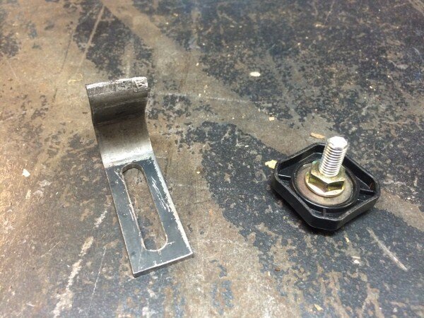

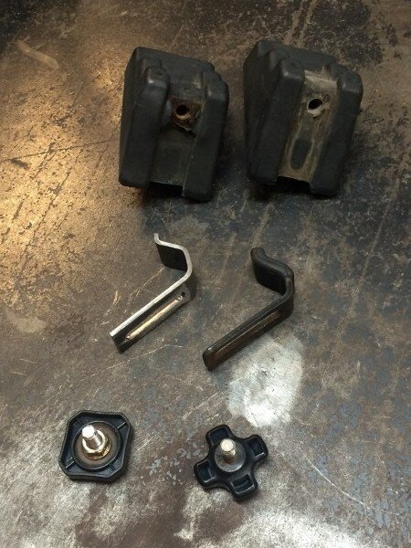

One of the windscreen hold down brackets that came with RJ was missing this bracket.

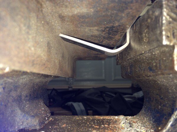

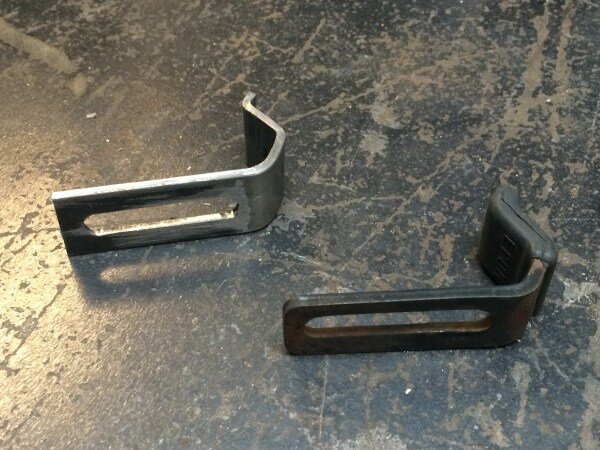

So I decided to make one.

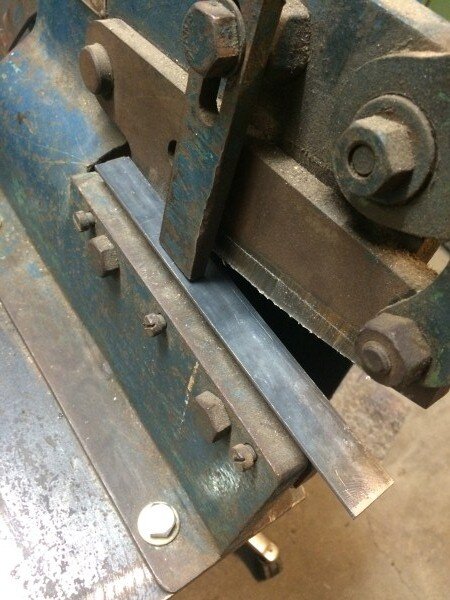

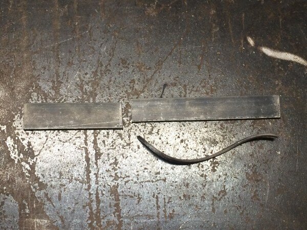

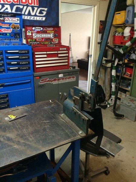

Found some steel the correct thickness, but it was too wide so I marked where it needed cutting.
Cut it on the guillotine.
I bent it to shape in the vice with a hammer, after the first few bends I had to get creative and use a piece of angle to do the bends that were close together.
A bit more cutting, bending, drilling and filling later....................

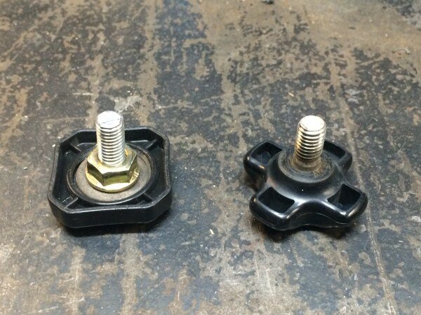

Ideally I need to plastic/rubber coat the end some how. I may just use some black heat shrink.
The only thing I could come up with for the bolt that was even remotely similar in size and shape was this.
Not ideal but it will do for now.

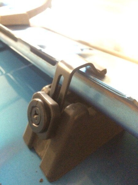

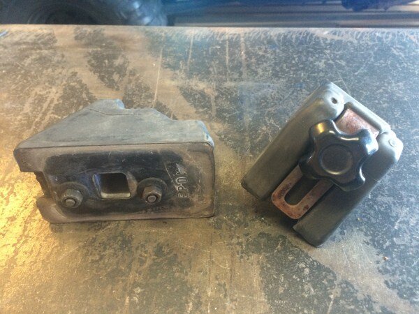

I've actually found a place in the USA selling NOS complete hold down brackets but at over $100 each I cant afford that at the moment. :think:

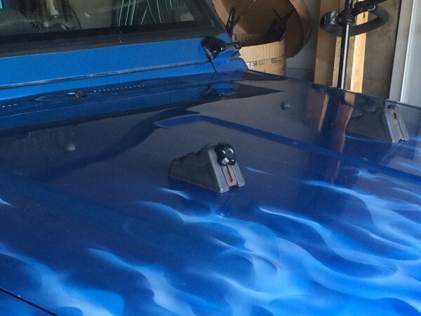

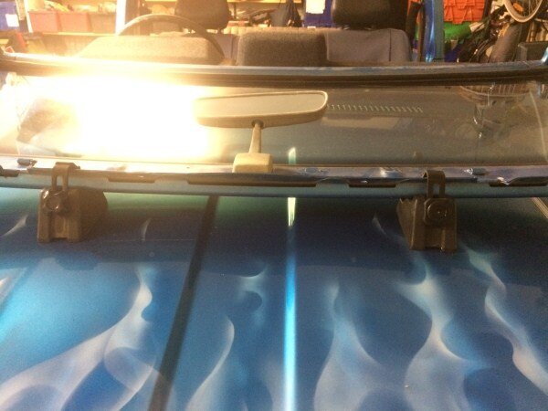

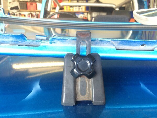

So they bolt to the bonnet and sit like this with the windscreen up.
When the windscreen is folded down they look like this.

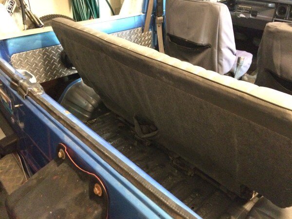

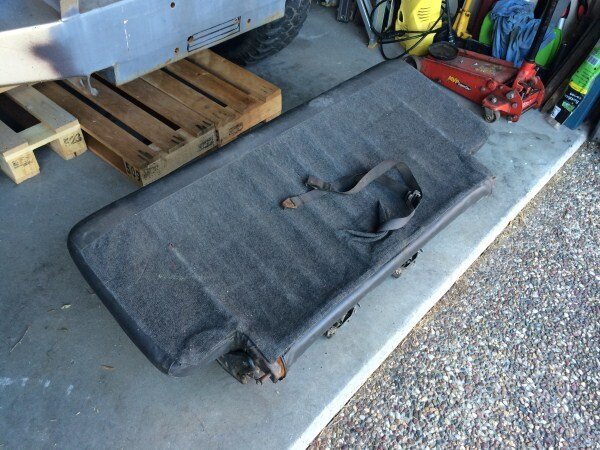

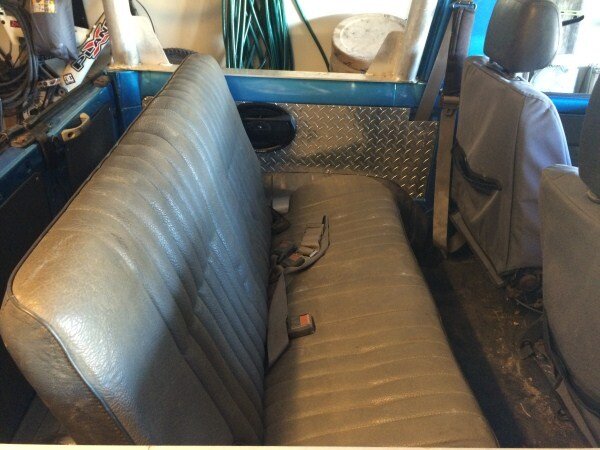

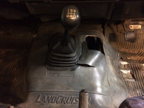

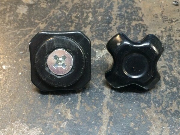

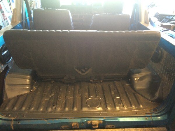

Kieren turned up at the weekend with the rear bench seat for me.
He also brought me the missing transfer nob.
I have the stick to fit in one of the boxes along with the rubber gaiter, just need to bolt it all on now.

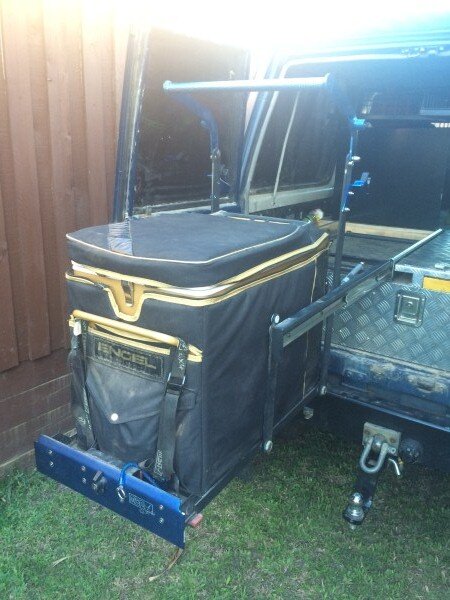

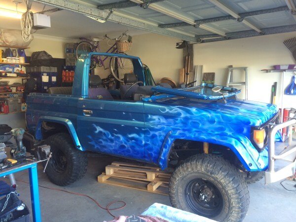

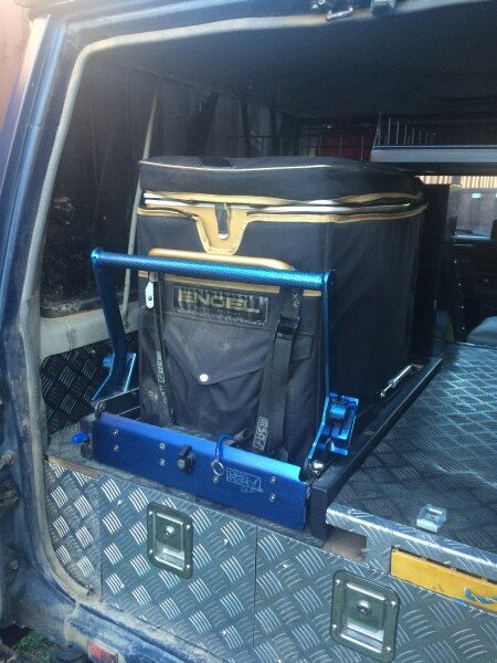

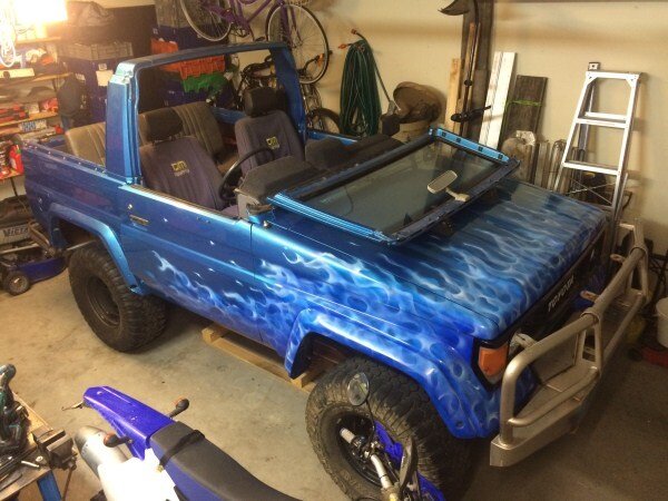

I did a tiny bit of work on LJ.
Re-fitted the drop slide and Engel.

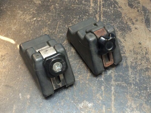

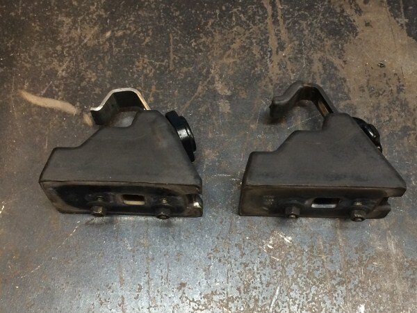

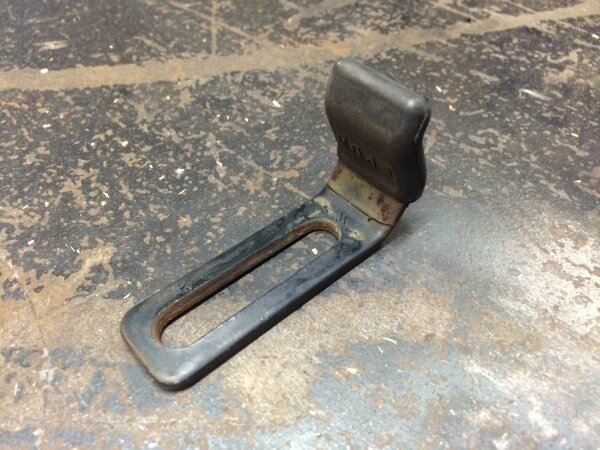

Thanks Ben for the photo's of the windscreen hold downs points. I have a set and want to fit them to my bonnet but from the photo's I will need to add some extra strength into the corners on the bonnet.
:thumbup:
Were they difficult to source?
When I went out to Toowoomba to look at the first soft top RJ70 the seller told me he had lots of people contacting him wanting to buy just the windscreen hold down brackets, so I'm guessing their hard parts to find. :think:
I've been unable to find a Toyota part number for them, even on Toyodiy. :icon-confused:

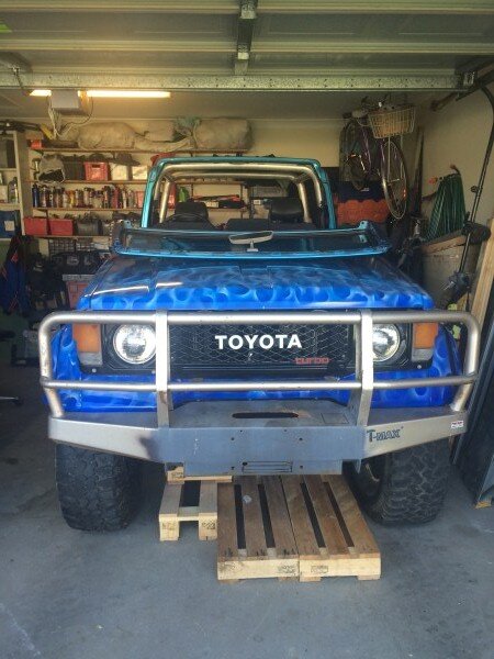

RJ.
I'm thinking it might be nice to put a petrol V8 in RJ and theres only really one choice and thats a Toyota/Lexus one! :icon-twisted:
I could buy something like this as a donor and sell off what I dont need. :think:
http://www.gumtree.com.au/s-ad/byro...00-lexus-4l-v8-4speed-auto-no-rego/1106362260

Ben
Rest cradle P/N
53390-90K00
Oh wow! I couldn't find a part #! :thumbup:
Did you buy yours new then? How much were they?

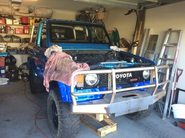

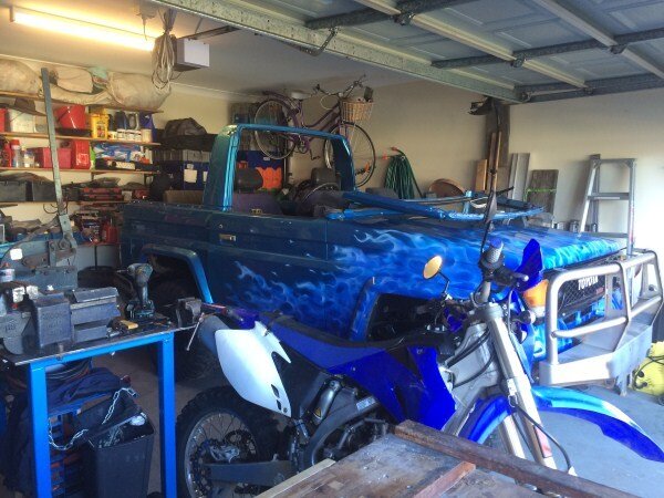

I did some more work on RJ yesterday.

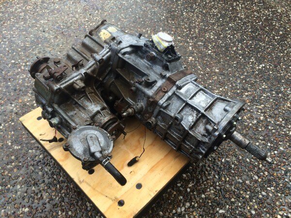

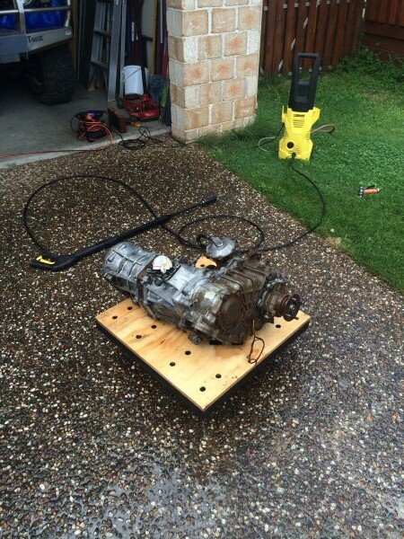

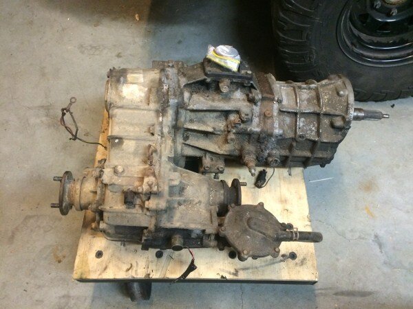

First job was to clean the spare gearbox/transfercase as I figured I could use it for the engine conversion as I want to make my own bell housing from scratch in alluminium, a bit like I did for the air boat project back at Piranha when I mounted the Subaru Impreza engine.
But it turns out its not the right box! :doh:
Its a G52 which is the box that would have left the factory in RJ, behind the 22R petrol engine.
What I need is an R151f box from a diesel 70, the same as what is in LJ as they are a much stronger box and will be able to take the Lexus V8 power a lot better. :geek:
So this needs selling.
I removed the bonnet.
Got it on the bench.
Needed to drill out the holes that have been welded up.
Got to use my sexy new die grinder!
That got the welds nice and smooth ready for drilling.
Drilled the holes through.
I could then bolt the windscreen hold down brackets on.
Bonnet back on.
Screen down and clamped in position.
The bits I made needed finishing.
Cleaned up the bracket with a flap wheel disc.
A quick coat of paint.
Found some rubber channel to use for now.
Done!

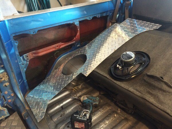

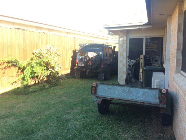

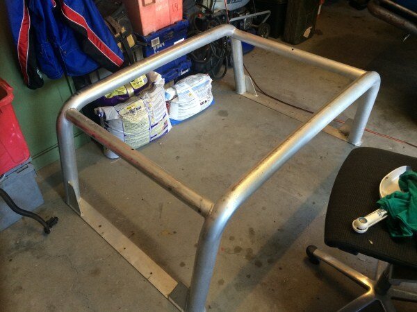

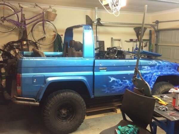

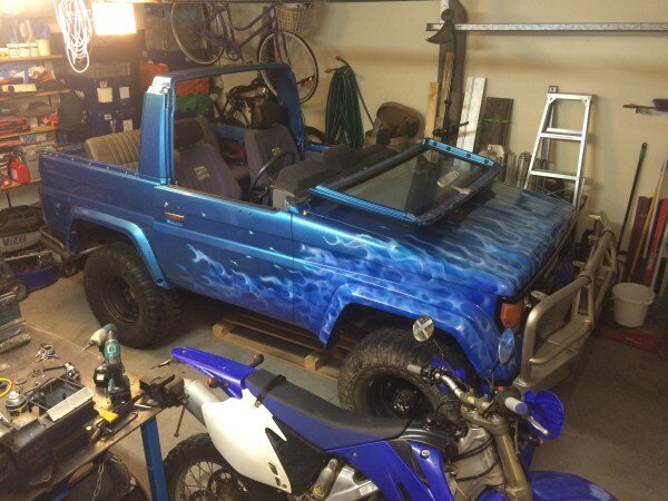

I wanted to remove the hideous cage from the back.
First I had to remove the checkered plate from the sides. I'm hoping to replace these with the original pieces of trim when I source some as I want it back to factory finish.
Then I could get to the nuts holding the cage in place.
Cage off.
At this stage I'd like to repair the 2LT diesel engine thats currently fitted and I may even register the car with that engine and start using it.
Then I want to sell that engine and buy a donor Lexus. :think:

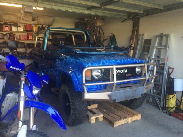

Back to the cars, I think a v8 is the go in a car like this. It'll spend a lot of time on the beach and you'll want a lot of torque for the sand. I have a 304 injected v8 in my FJ70. It sounds tough, it has a lot of power and it goes hard. I've got a Marks adaptor on mine. Look up Castlemain rod shop, you'll find everything there.
What are your plans with the main pillar on RJ? at the moment its looking a lot like a barbie utility vehicle! maybe a better paint job to camouflage it a bit! Will you be adding a decent roll cadge of sorts? I don't think the soft top would fair to well in a roll over.
Ben
I brought them second from a member on a American forum both where around $100 landed in OZ from memory. There around $150 each on Amayama from Japan and around $105 from UE but postage will put it around the same price.
Hi Ben, I'm also a commercial market gardener and have grown thousands of tomatoes over the years. When I grow them in a glasshouse and run them up a trellis I pinch out every second growing shoot, not the fruiting shoot (you want the fruit!) and wrap them around the string weekly. They grow to 8 feet easily. When you first plant them make sure you give them a decent seaweed and fish emulsion feed, then stress them for 2/3 weeks. One decent watering when planted, then nothing! it seems weird but what it does is force the plant to send out a decent root base in search of water and food. It'll make for a strong plant and it'll produce decent fruit. Keep the potassium levels up as they require it for fruiting. Use worm castings in your potting mixture to help retain moisture too. I'd avoid the garlic and onion peelings in your compost, the beneficial nematodes don't like them much.
Awesome! Thanks Ash, very interesting! :thumbup:
Sounds good mate, you've got to love a petrol V8 for sound and power! :icon-twisted:
I will be keeping the B pillar on I think as the seat belts are mounted to it. If I remove it I would have to fit a cage to mount 3 or 4 point harness's to. Although I'm not sure how legal they would be for road use. :think:
I'm not a huge fan of the colour or flames and I think it would look much better put a bit more back to standard and with a genuine Toyota colour. :icon-cool:
I wouldnt mind a simple cage but I dont want anything too radical as I dont want to do any extreme off road driving. I want it mainly for the body, to fit to LJ so that I can ultimately keep LJ for the r est of my life. But before I fit it to LJ I want to put RJ back on the road and use it for light off road driving and beach driving.
Admittedly it may look a bit barbie like at the moment but I think in standard form like the one below it looks cool. I cant wait to drive it round like that, even just to nip to the shops! :icon-biggrin:
Very interesting! :think:
I'm thinking I might just stick with the ones I have for now, the one isnt perfect but it works ok. :)
These are the ones I found for sale in the USA:
http://shop.cruiserparts.net/index....=37314&zenid=7b265c106b52264aacb82afe5af30725
