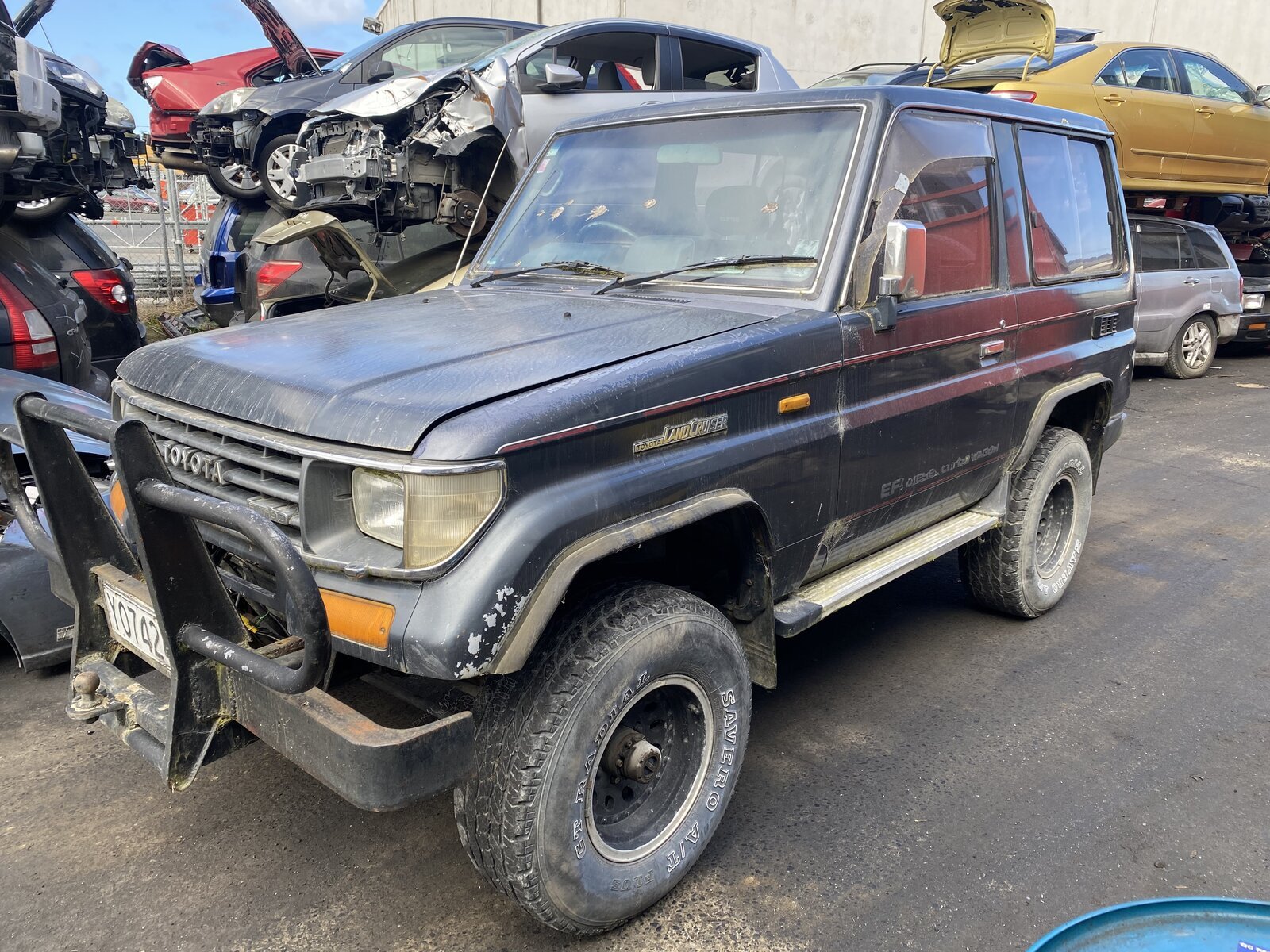

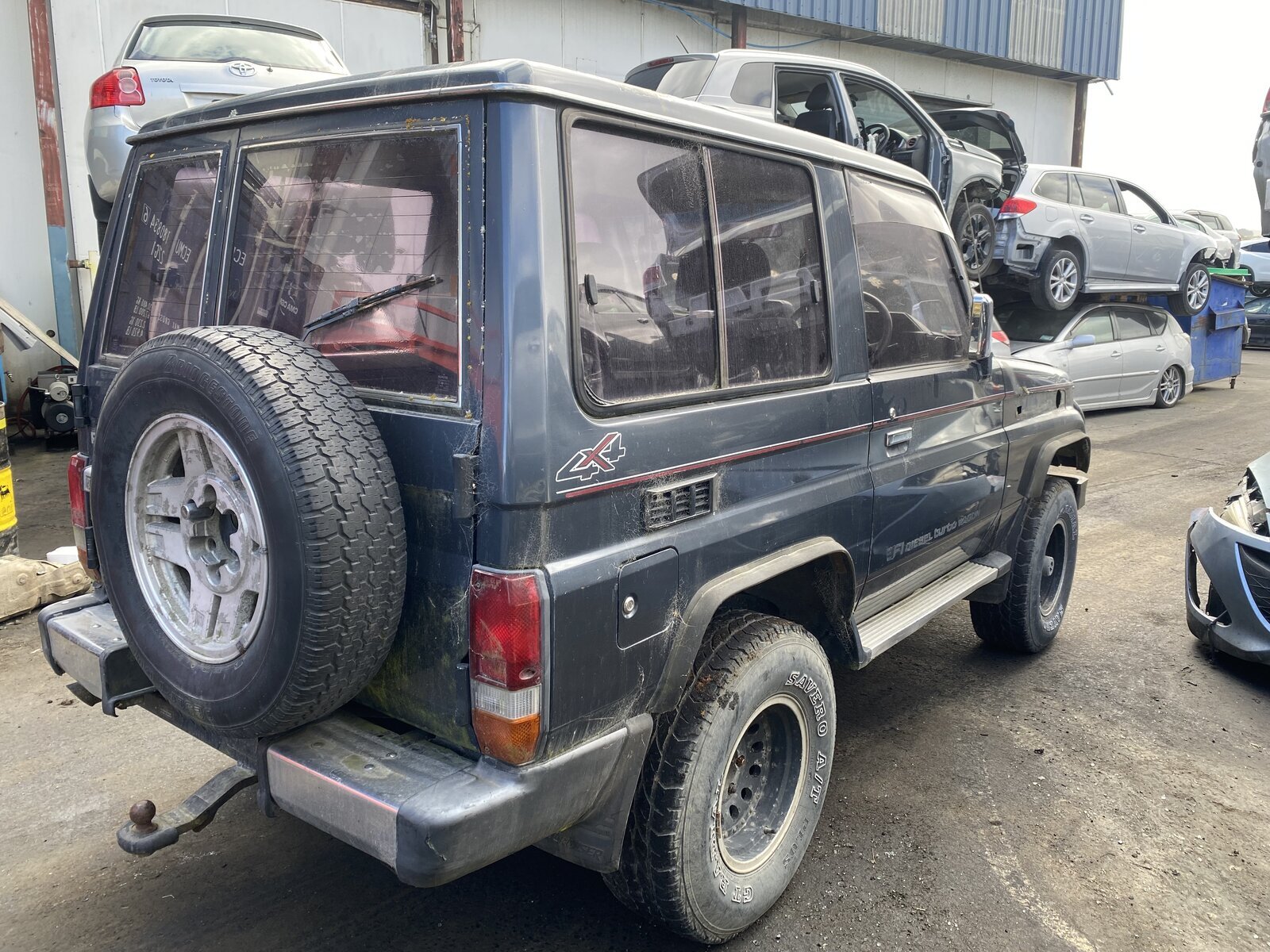

Hey guy, I’m completely new to the Landcruiser scene and I’ve purchased a 1990 LJ71 Prado that I’m planning to do engine conversion. The original 2L-TE is in bits so considering putting a 1KZ-TE out of 1995 Hilux Surf that I have lying around.
- they are both auto so can I get away with leaving the original auto trans in or will the 1KZ auto trans be different??
- I know the wiring will be different but what else do I need to prepare for.
TIA
