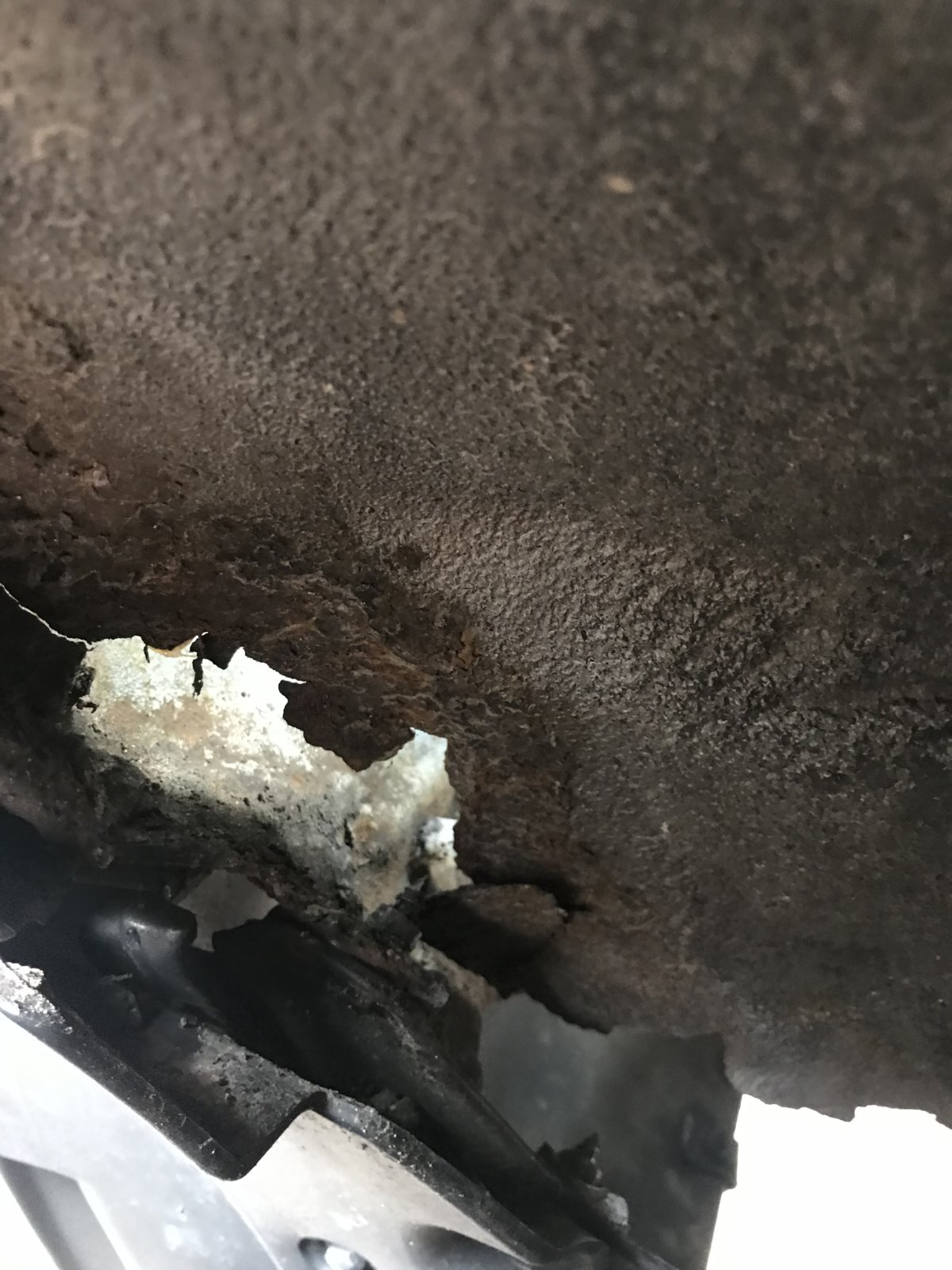

@clivehorridge the state of the rust. That rear arch/floor was much worse than I thought. Discovered this whilst insulating.

Thats surprising amount of rust eating away the inner cargo panels...... I feel for you
No doubt its always worse than it looks and I know here in Cyprus its fixable. The rest is kinda normal of signs that appear over time.

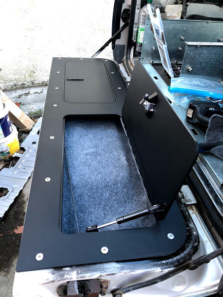

Sarah was working on the tail gate installation whilst I was on long range tank duty and snorkel fitting.
