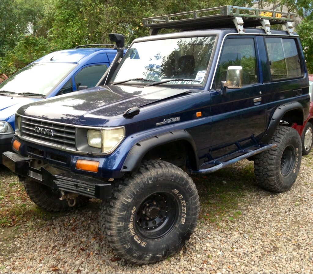

Smart looking truck ! Especially the front bumper looks really well on it !
I have a 90 bumper on mine, not a tubular one like yours though.
Hi Shaun thanks for that.
i like you truck mate looks very clean on pic did you have to shorten your bumper aswell then??
Where re did you get roof rack from or home made?
Cheers
Thanks Craig, I do try and keep it clean within reason as it does get used what it was built for.
No not at all and it more or less fitted straight on once I lifted the body 2 inches.
The roof rack used to be on an 80 series of my mates and is an aiba works it's made from aluminium and stainless steel.

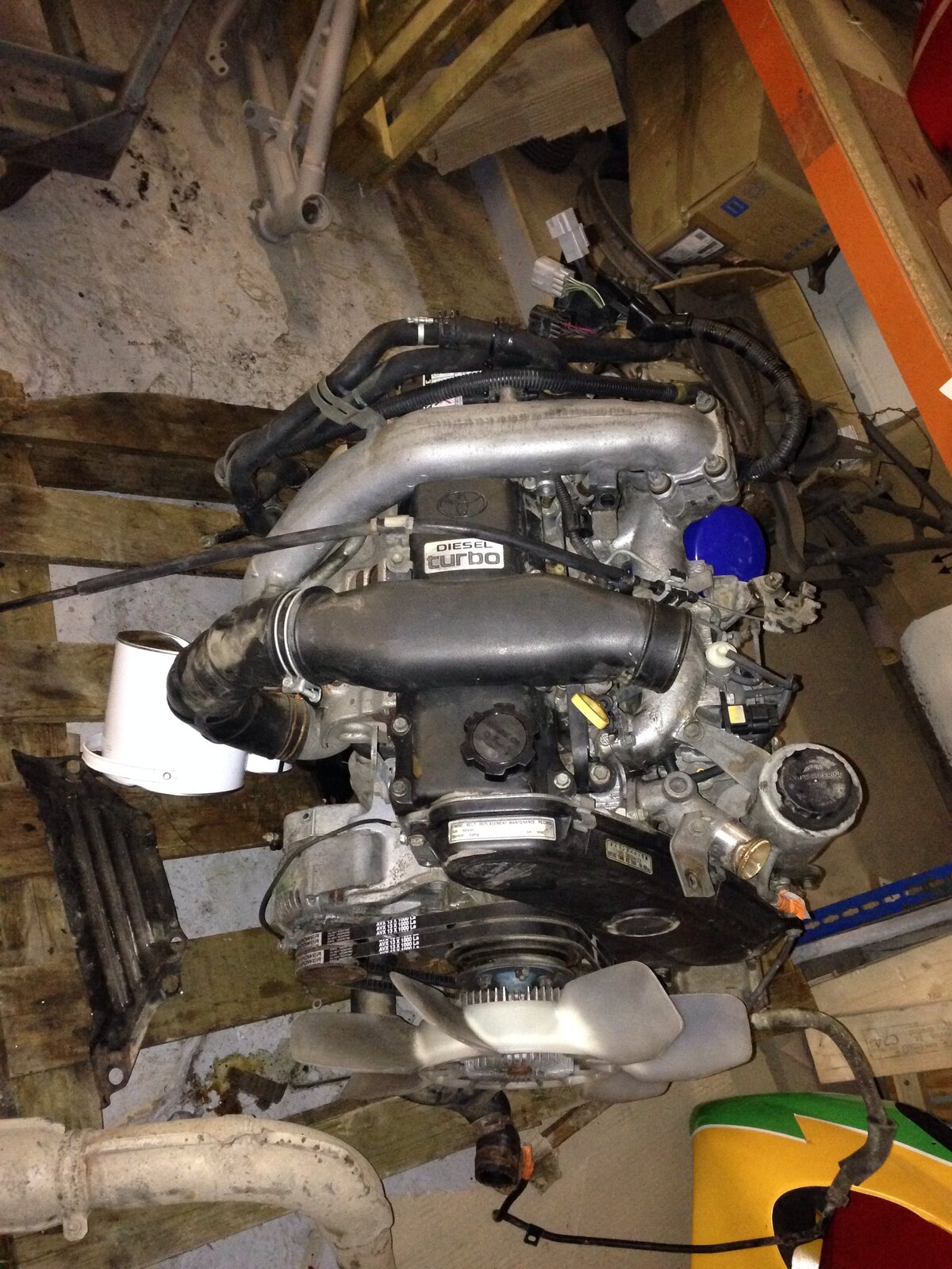

Brought this off eBay the other week
oh yes 1kzt it is
been looking for ages now

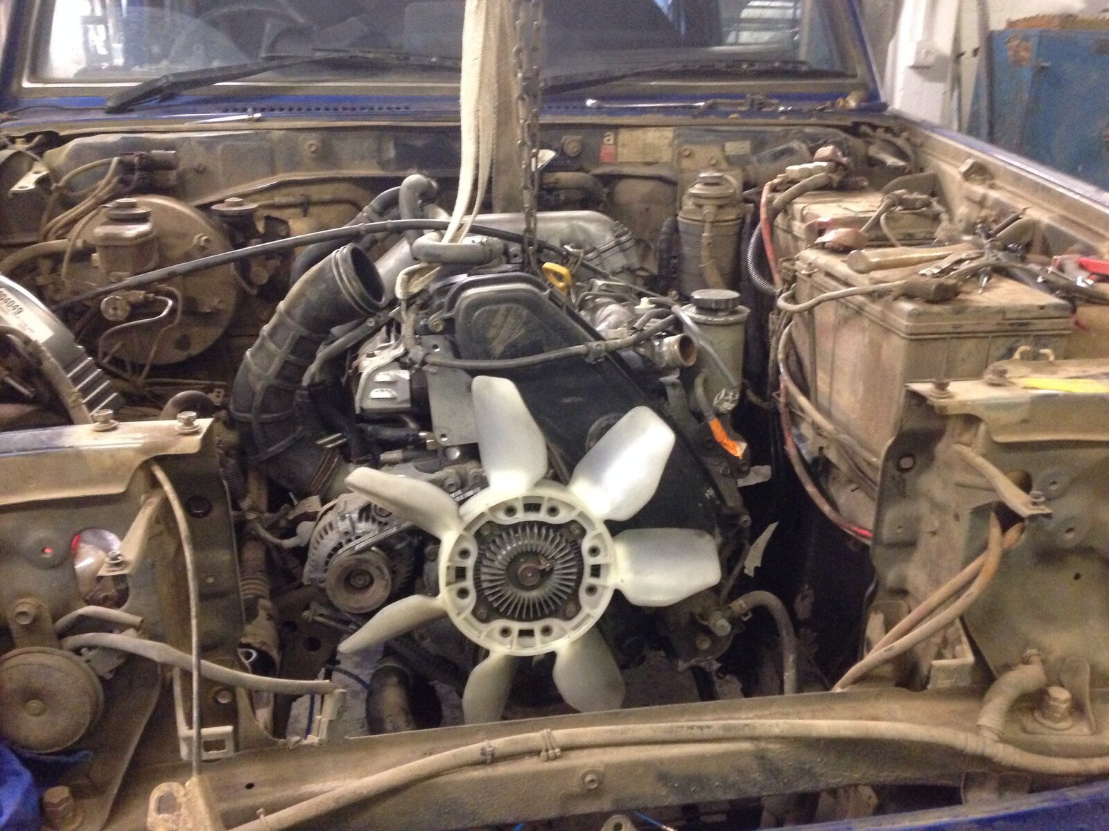

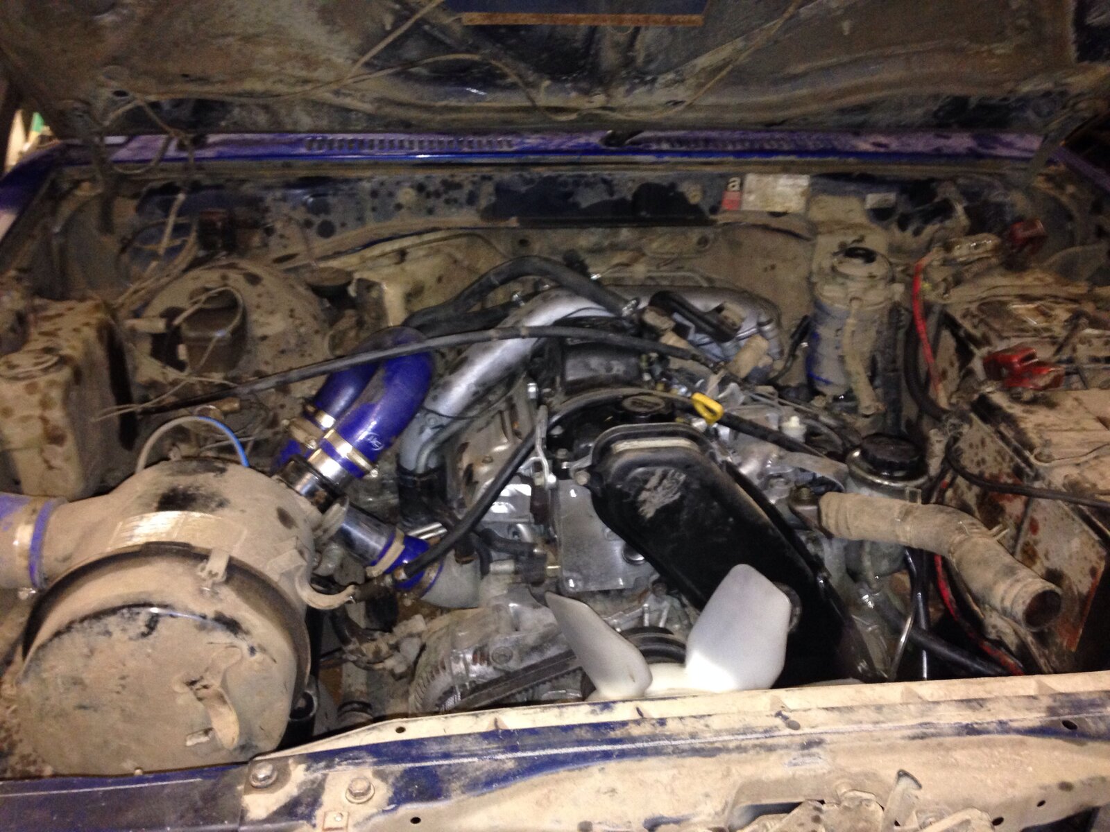

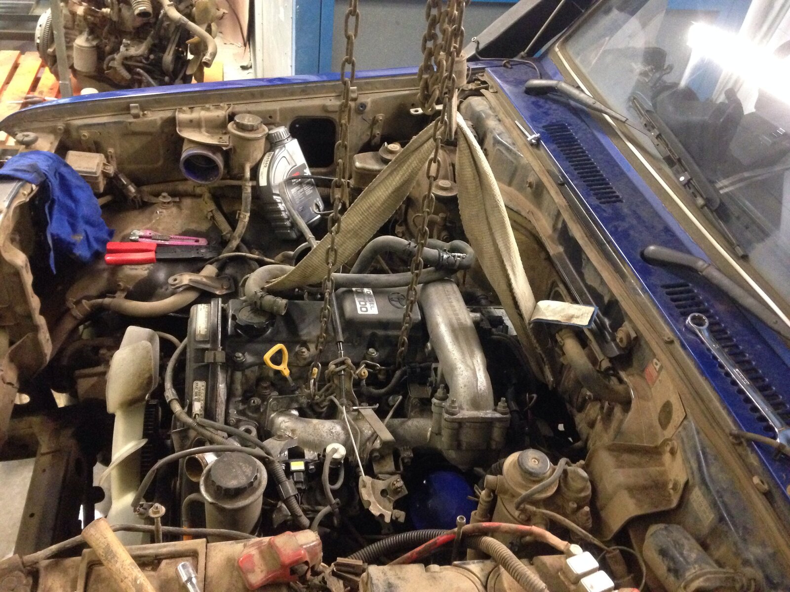

We'll after a slight struggle with the wiring I started at 6pm with my dad got the 2.4 out by 8pm
1kzt was in and bolted up by 12 after changing bell housing and working out engine mounts decided to use 4mm plate instead.
by 3am she was alive and sounded gorgeous!!
Radiator I was going to use a 4runner one but changed mind and decided to use my original 2.4 rad bug get it altered like fit a rad cap and expansion pipe, also move bottom hose fitting to opposite side so took it to local radiator workshop Friday I should have it back Tuesday along with a new matrix which I took out to replace as it's all blocked up and never had any heating since I've owned it so should be like new truck when it's done!!
