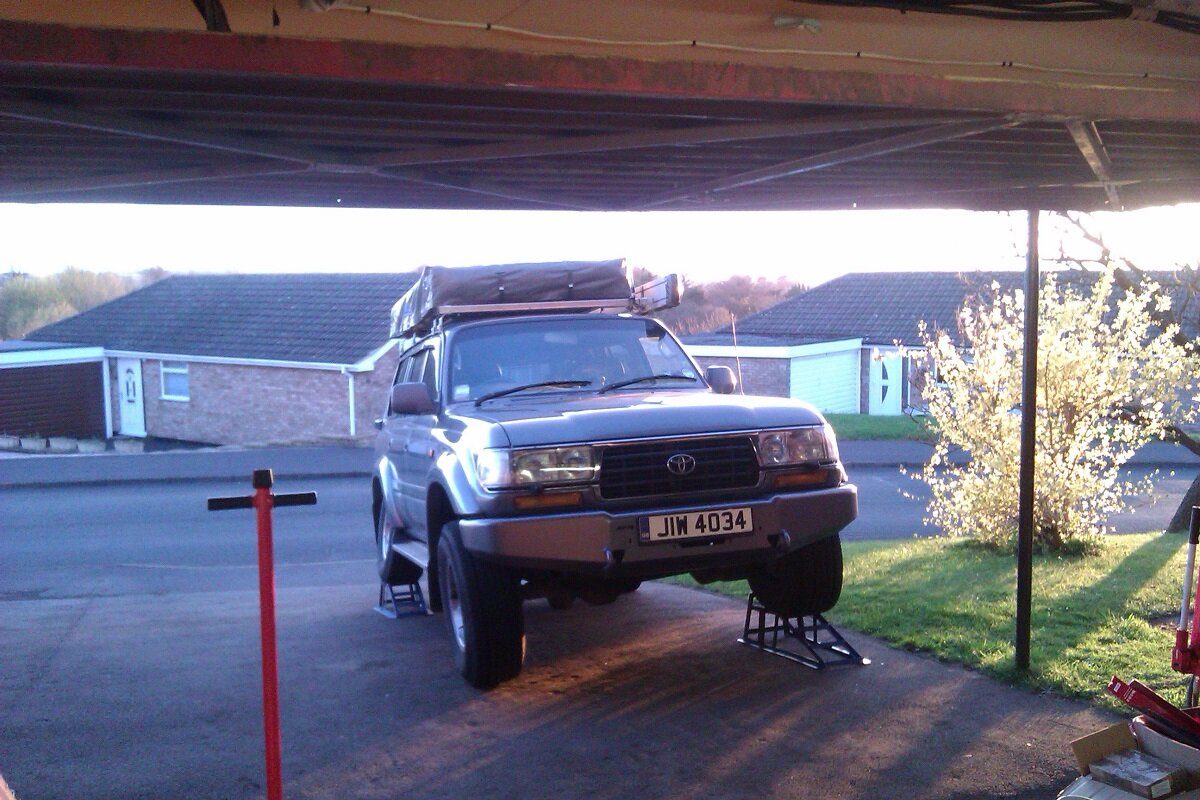

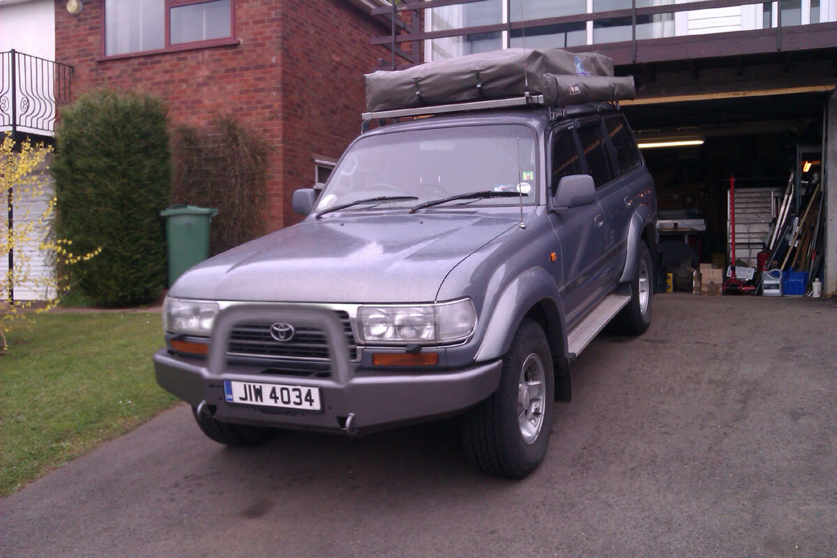

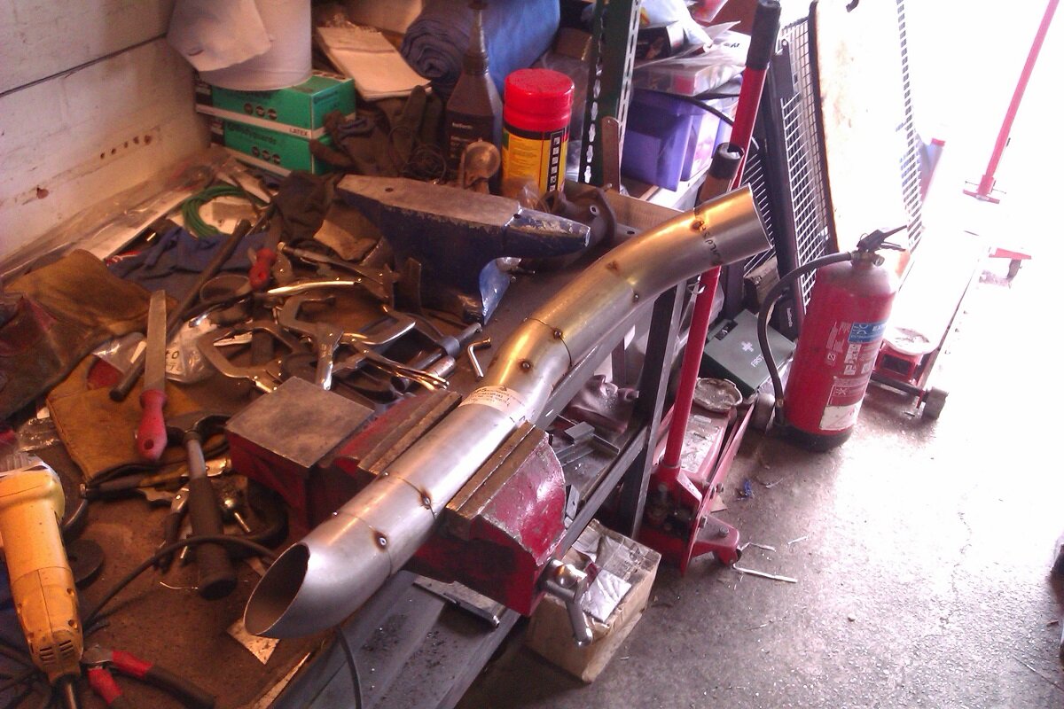

This has been the view from my garage for the last week or so and I don't think I'll bother trying a hoop as I like it how it is but I think I've blown the stealth theme this last week or so
I've been shopping for various exhaust bits for a few months

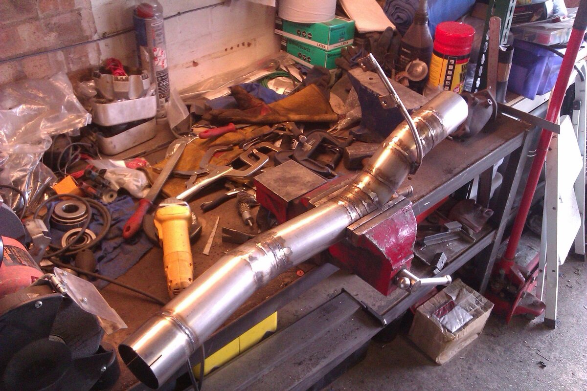

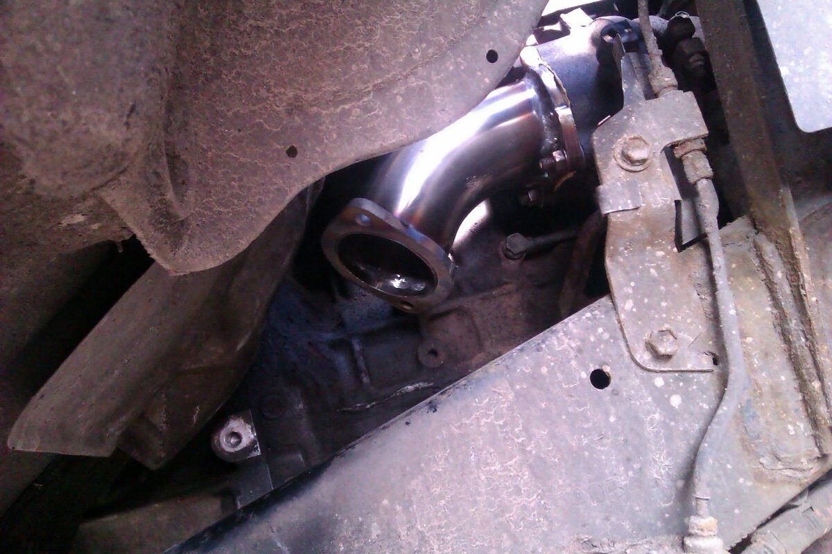

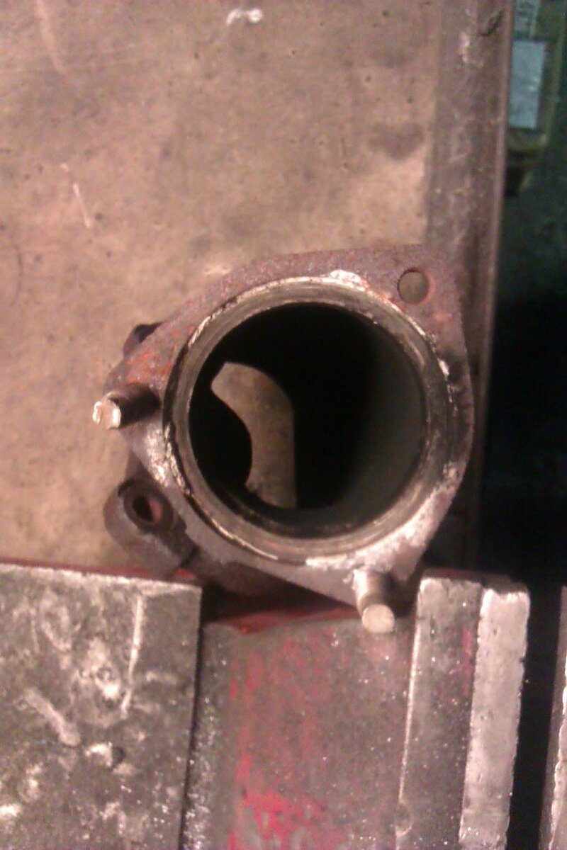

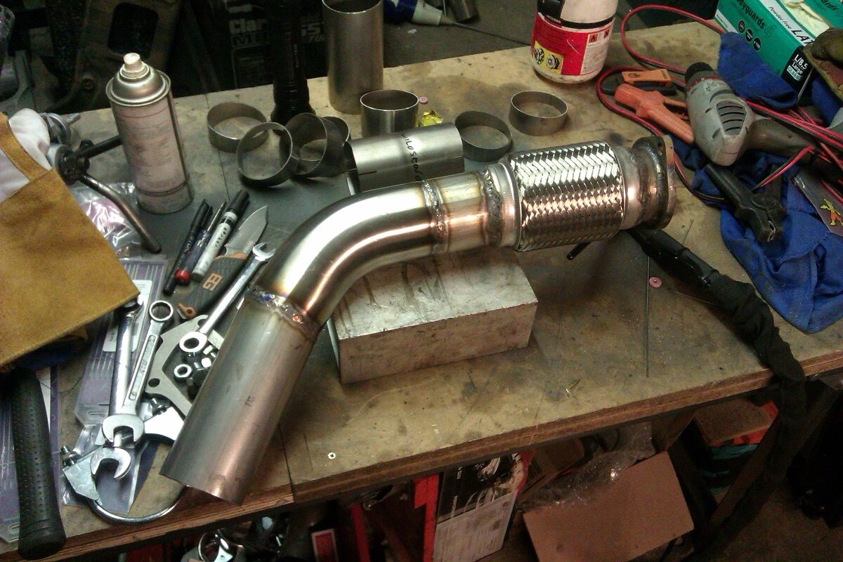

Being a sucker for making work for myself I wanted to replace the OEM 'dump pipe' which is the casting off the back of the turbo that the OEM exhaust bolts to as the outlet is a bit smaller than 3" and it points the wrong way really for going inboard of the chassis
I thought of buying a dump pipe but they only seem to be available in Oz and are really quite expensive so made my own. First proper bit of TIG I've done so not the prettiest but it should do

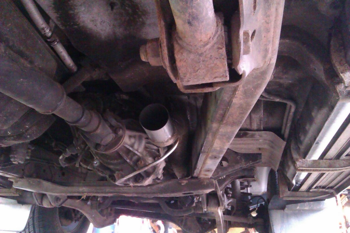

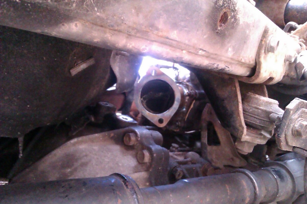

This next one is looking up from inboard of the chassis and is where the down pipe ends up coming down through, all quite tight with not much room for maneuver.

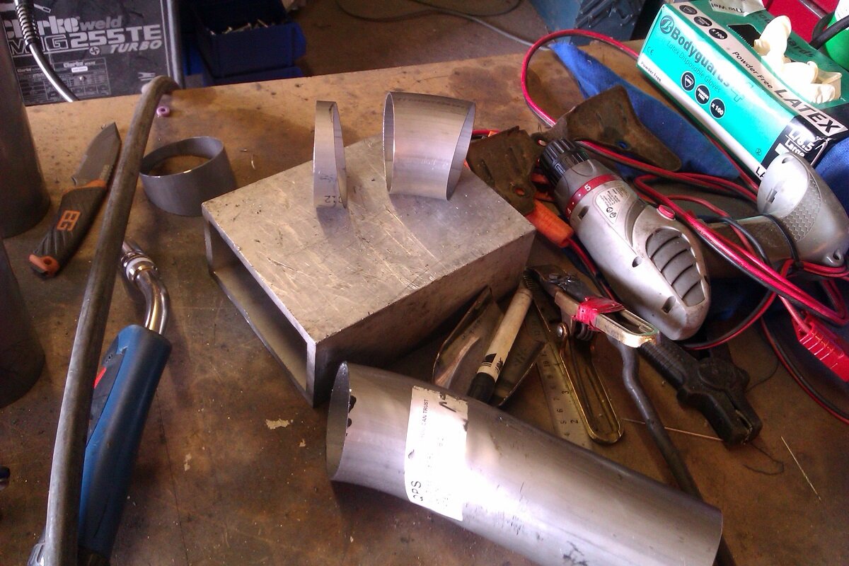

Then I made up sections of pipe - down pipe

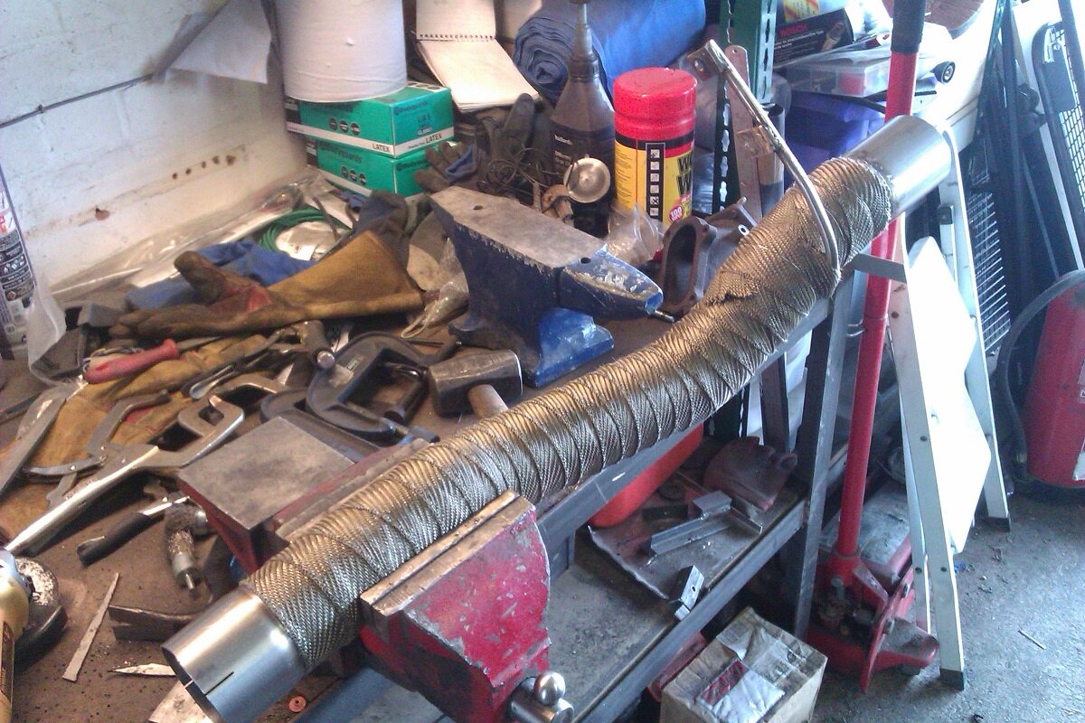

The pipe that wiggles past the transfer box (upside down in pic) which I wrapped to stop it cooking the box

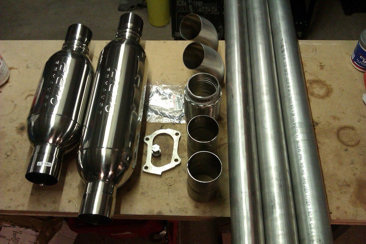

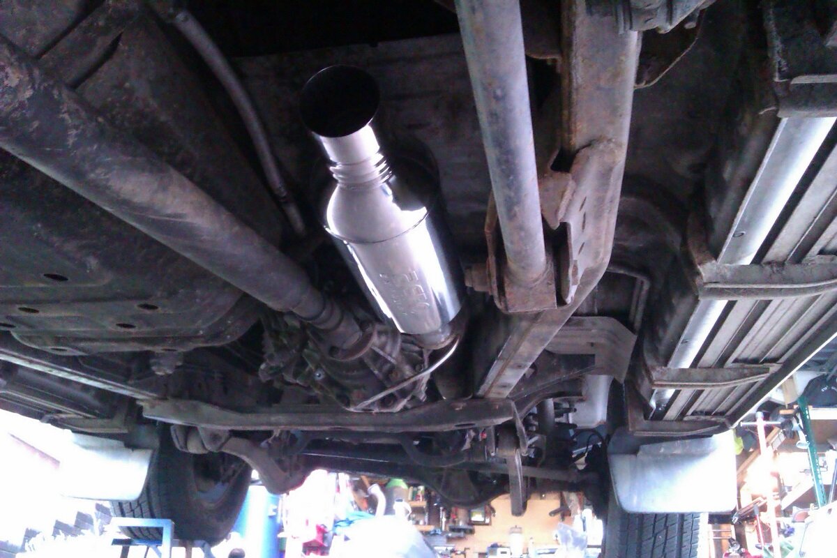

Then a silencer

I bought a 180 degree bend and 130 degree bend and cut sections from them to make most of the pipes, these were the building blocks
I started off doing TIG but ran out of Argon so switched to MIG with stainless wire which worked well enough if a little messy but much much quicker than beginner TIG'ing!
Tonight I finally got to start it up and go for a drive ... sounds nice but a little bit too loud for my liking so maybe another small silencer in the tail pipe is needed.
