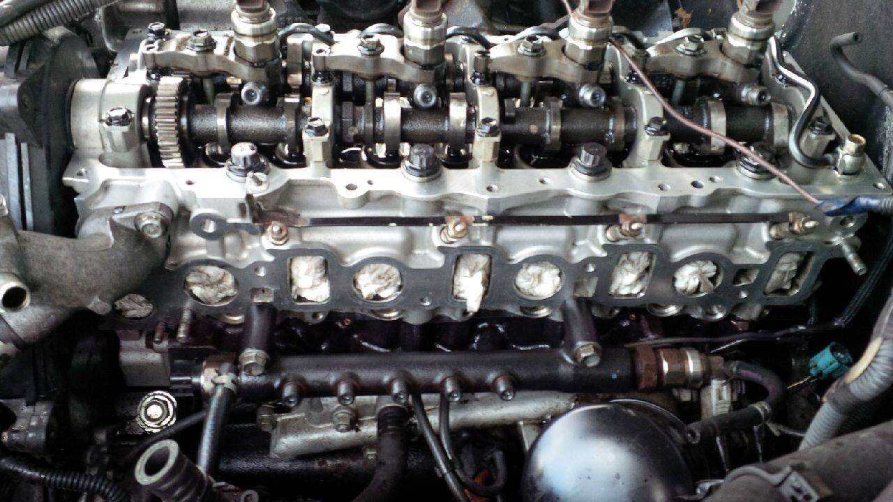

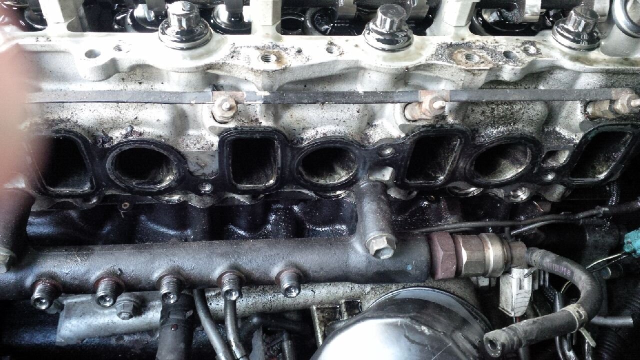

Although the cylinder head gasket had a lot of oil on it there was also oil in the head blanking plugs, this suggested that the oil was coming from above the head gasket! a quick examination of the rocker cover had ruled that out and my last repair was holding fast:thumbup:
Stripped the manifold gasket off and as i did not have a spare i cleaned it all up (it seemed to be coated in some black looking Teflon coating tho9ught this was carbon deposits to start with, this was all breaking off), cleaned all the manifold and seating faces and re assembled using Hylomar to re seal.
Was a bit apprehensive of stripping this down to start with but it one of those jobs once you have done it once the next time is easy! (hoping there will not be a next time), what i really like the most is that you only need a handful of tools!
Everything went back with no problems, all torqued up to Toyota specs, i know the manifold gasket should be replaced and i might be revisiting this if my job is not sufficient but i had to know how it all fits together!
