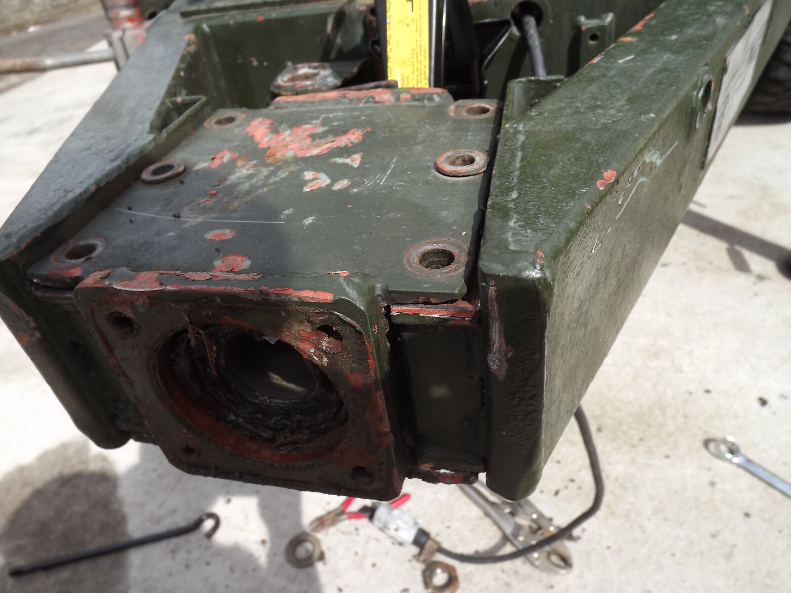

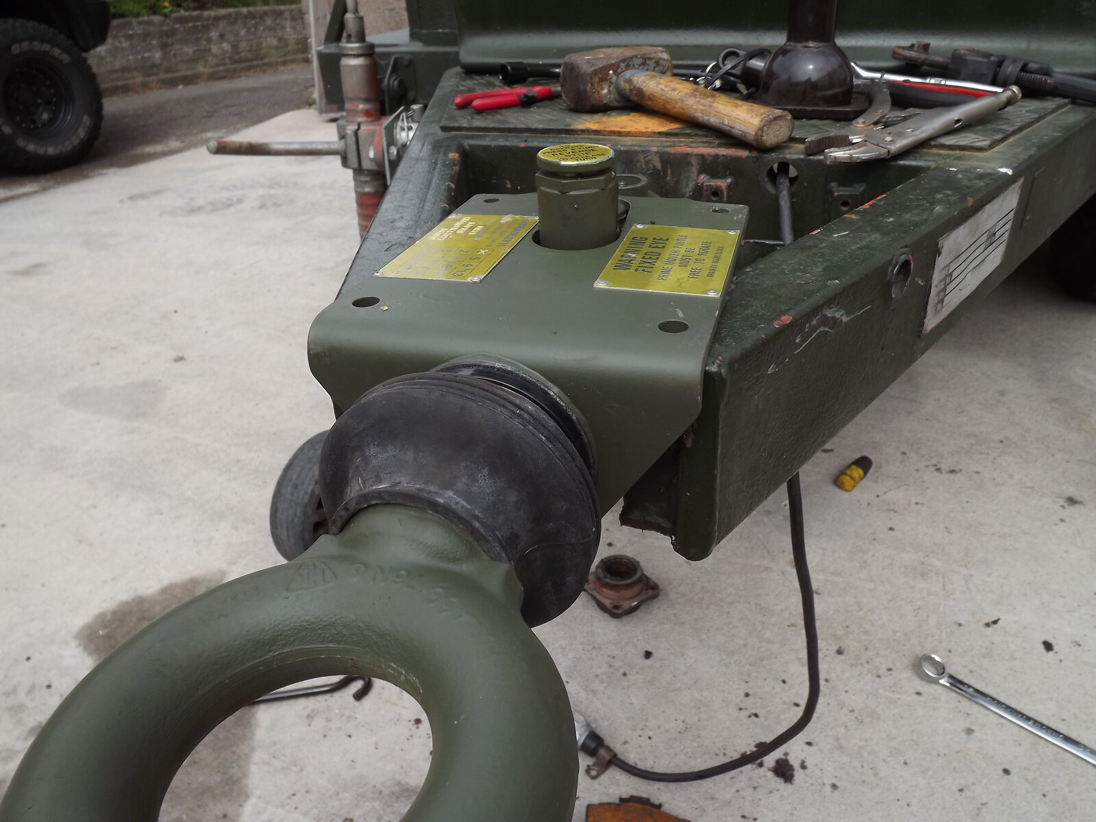

Can't get this bloody thing out so any suggestions before i chop it up ? as far as i can tell there's nothing holding it but years and a half ton jack is all i can get behind it .

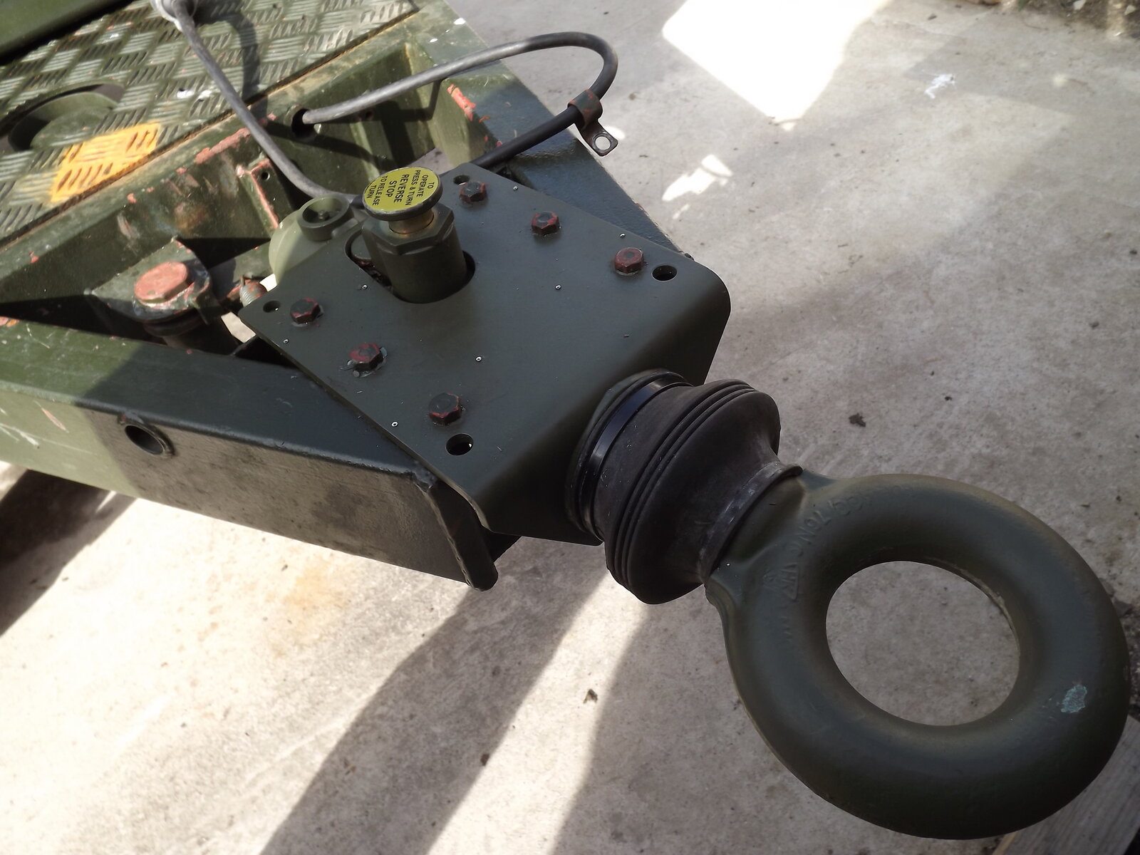

NK Recovery did say the Rapier Towing unit they sell will need a little modifying to fit

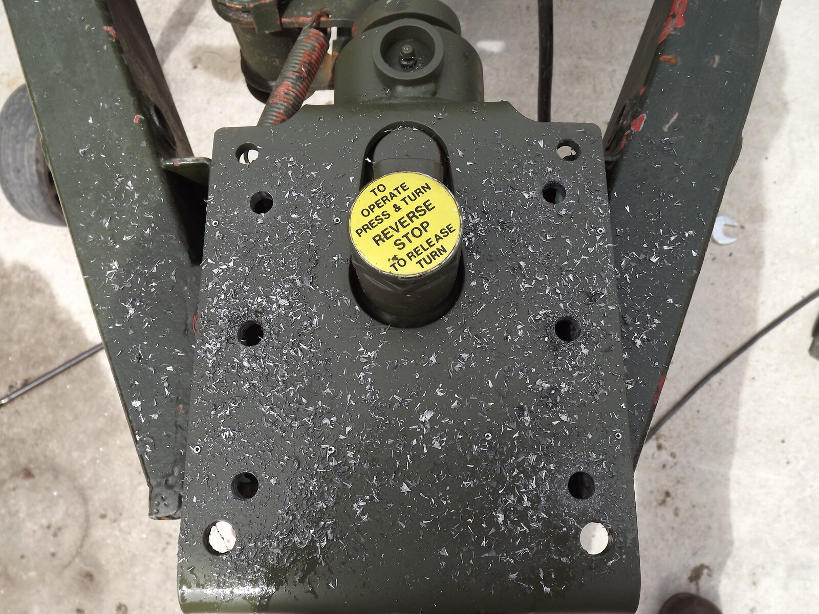

I should have trimmed it down to make narrower so it would sit between the A-frame rails like the original but having no paint i thought it would do for now .
Bradley overrun damper type MH35 should anyone be looking for similar and reverse/shaft lock is button down to save you hooking it up and going for a drive because you can't move it by hand locked or not .
