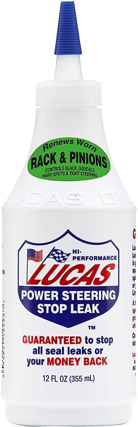

Oh another thing my Cruiser has is quite noisy power steering, I suspect I've got a leak somewhere as a top up of fluid and a good bleed sorted it for a couple days but now its back, need to check my lines.
Bob
Jun 30, 2011
1,238
ireland
I had the very same, despite a full flush and new ATF. This sorted it right out..
