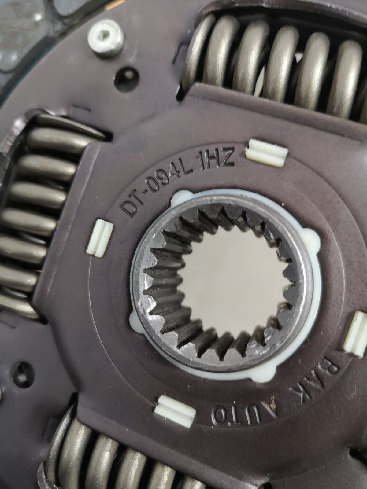

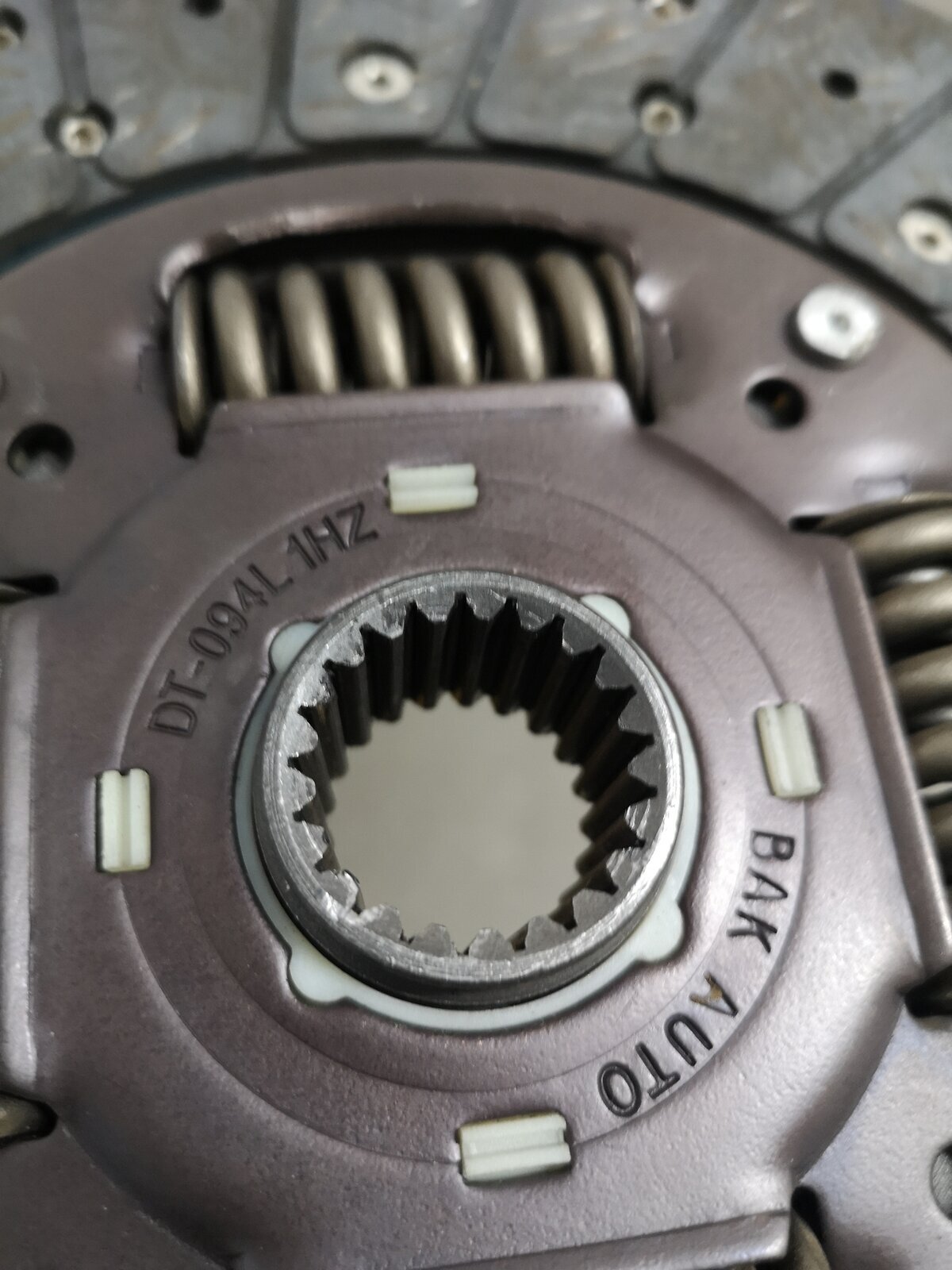

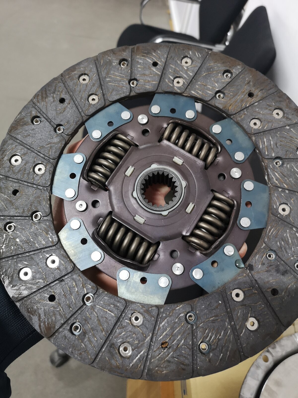

Oh i see, i took mine out, but doesnt seem to have such damage,

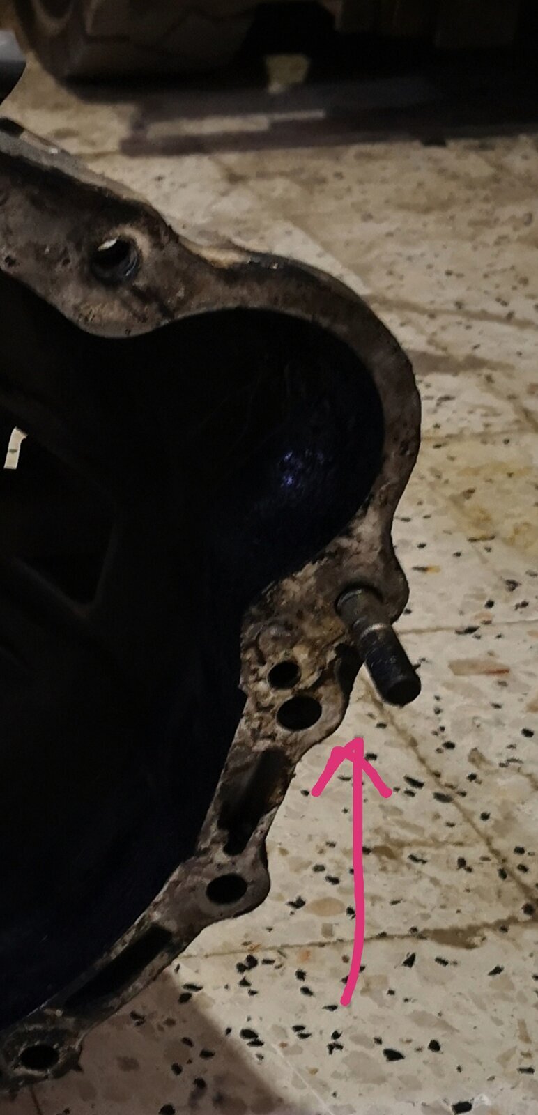

Dave do you mean this bolt stud in the picture? If yes, then i didnt remove it, and i can't see how, as for the anti roll bar, i removed it completely. I made enough room.

Yep that's the one, it seems to be just the right length to foul up a smooth install as the bell housing approaches the engine and the primary shaft is in the spigot bearing, the result is the gearbox/engine is not in a straight line, and then many people use the bolts to draw the engine and gearbox together, this results in pressures being applied to components inside the gearbox and of course the clutch pieces.
The stud can be removed by threading on two nuts of the correct size and locking them tightly against each other, then turning the nut nearest the bell housing in an anticlockwise direction the stud will come out.
