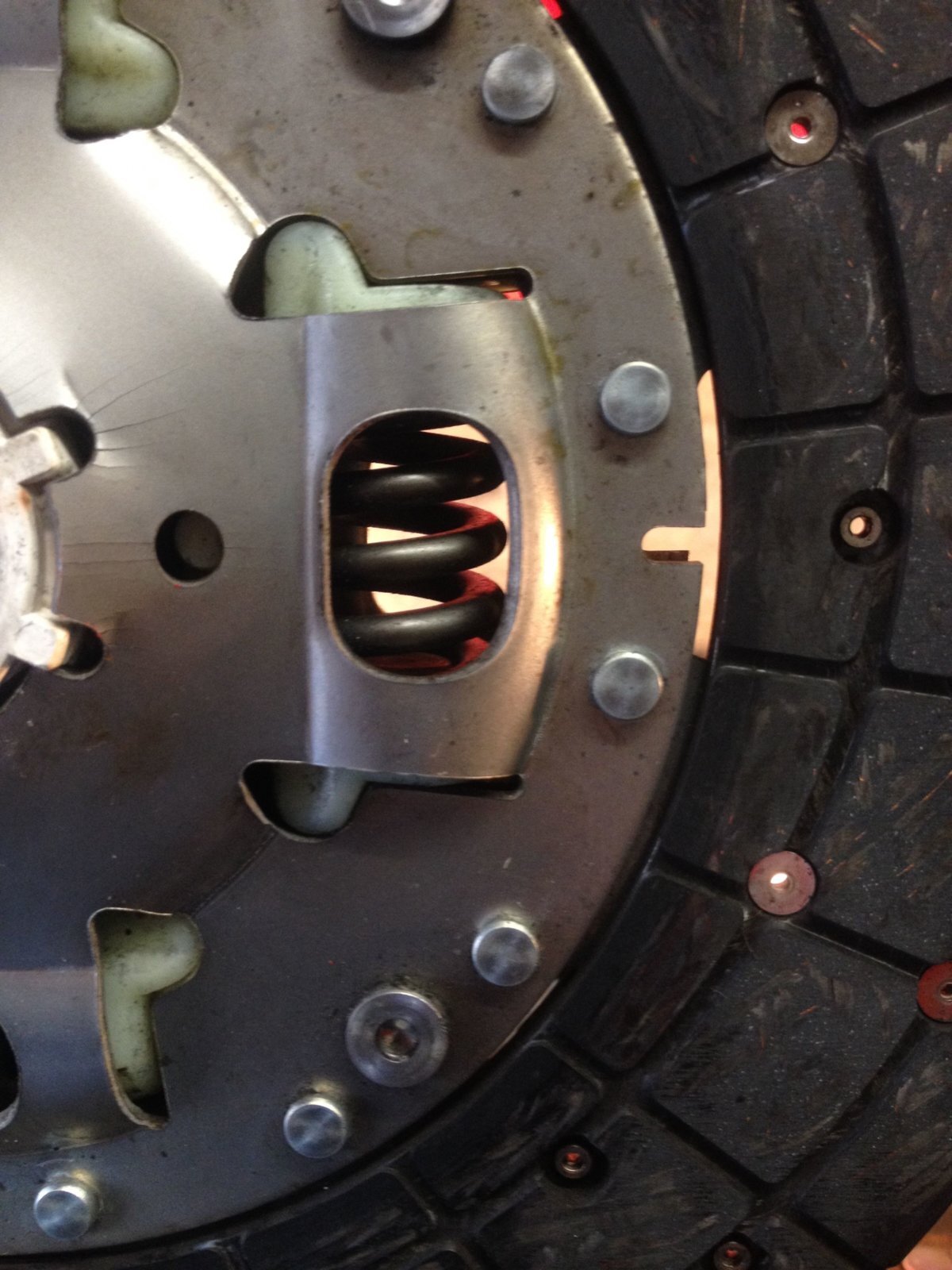

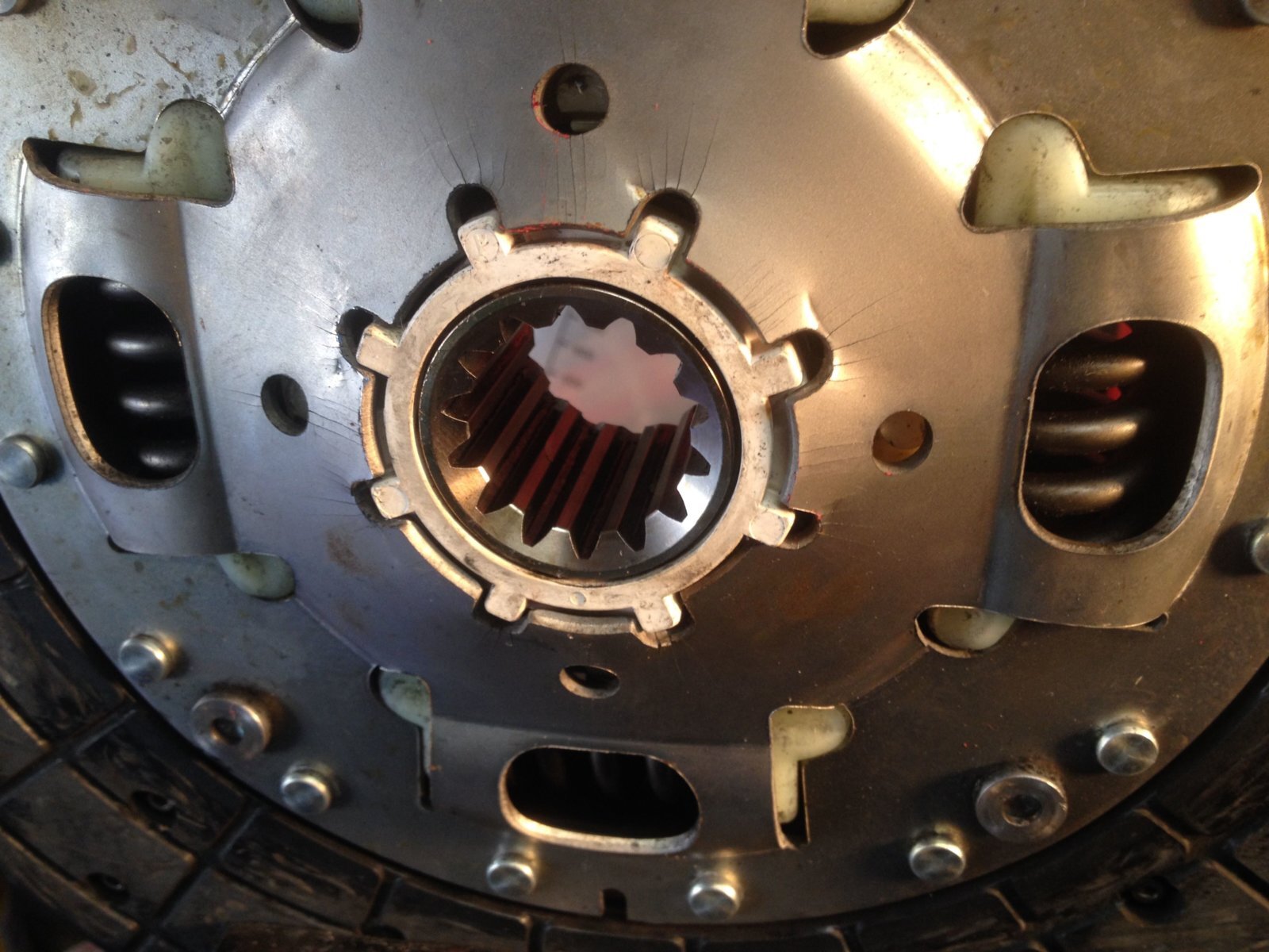

So to the fix, one damaged friction plate replaced, damaged during the last instal several weeks ago by yours truly, almost certainly by too much weight being applied on the input shaft and warping the steel housing surrounding the splined centre drive spigot/collar or whatever its called.
Doesnt really show the extent of the damage but you can see the stress lines/cracks...

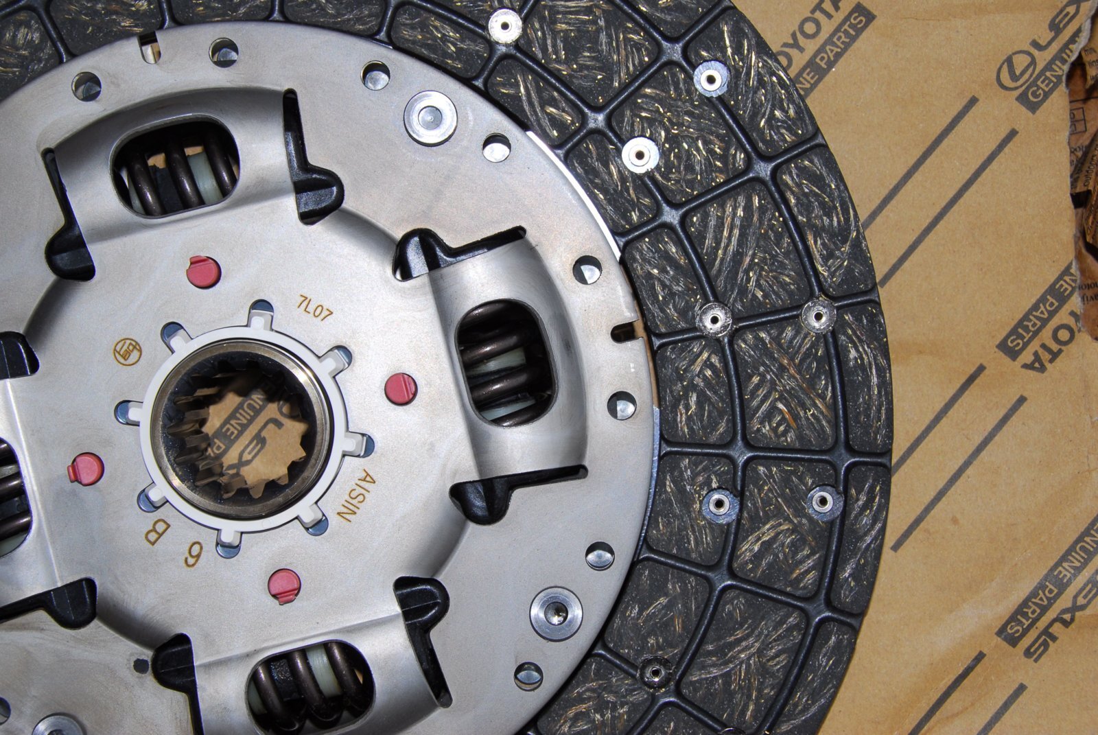

Damage aside, the only obvious difference between the 2 plates (OEM plate now installed) is the small plastic inserts in the springs of the OEM, not present in the non standard Aisin clutch. Who knows what they're for.
Here's the source of the noise..
Looking at the damage I reckon the friction plate would eventually have failed altogether, probably sooner rather than later.
The bite point is now slightly higher than before and feels perfect.:thumbup:

TP it was a please mate. Good banter, good company and a good job. As soon as the bell housing was clear, I stuck my finger in there and thought errm, I don't think that's right. But neither was the release bearing spring clip. That was spragged too. A quick bend and hey presto the fork was all sorted.
