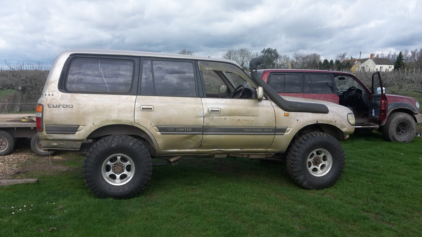

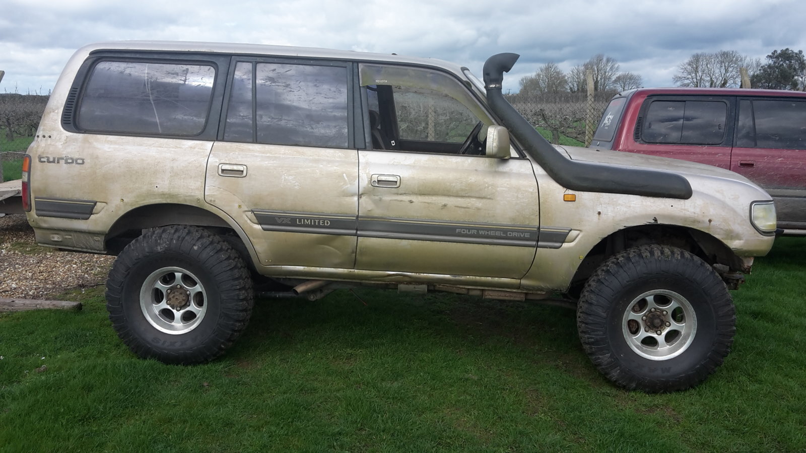

New toy! !!! Off Road built coming on I think!!!!! 3 80's in the stable now. Ain't life great! !!!!!

Yes Dave it came from Garry. Despite the scrapes and grazes it's incredibly solid with virtually no rust and only 200 000 kms on the clock. Planning front and rear winches camo paint job. All lockers work too as a bonus. Passed it's mot with only a couple of advisorys. BEB s planned in the not too near future. Fed up fixing suzukis every week and needed a stronger pay and play toy. If all goes well I'll be taking it to lincomb.I think I have seen this before, did you get it from Gary the guy that breaks 80's? The pictures I saw did show some bits and pieces were missing but would not have taken much to get it back to a 'runner'.
