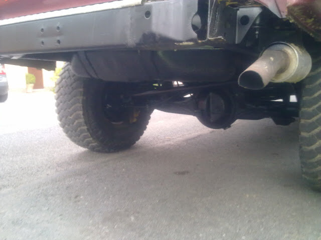

I have a landcruiser 70 fuel tank fitted as aux tank where the spare wheel was.
A double filler neck: left hole is for main tank, right hole for aux tank.
And a 12v pump.
Both tanks are equally big. So I just drive on the main untill it's dry, and then I start pumping. Just have to remember if the aux tank is empty or not :) :)
And a 12v pump.
Would be interested to know more about this set up Geert.
Is the double filler something you fabricated?
Also, how does the 12v pump transfer the fuel from the auxiliary tank to the main?

In my installation the pump is switched manually from the dash & pumps from the long range tank & then into a tee I fitted in the breather pipe of the main tank and fills it that way.
it came with a Y filler & fuel cap (which I didn't use) , I used the Toyota dual filler where you pull a lever to divert the flow to whichever tank.
it wouldn't be at all difficult to fabricate a Y filler but don't forget to add 2 connections into it for the vent pipes from each tank.
The one regret I have about when I fitted mine was not fitting a fuel gauge sender in the top before I installed it, and can't face taking it out to fit one so I have put a double banjo connection on the out let with a valves off 'sight gauge' piece of clear pipe to give me a rough indication of what's left in it!
So is it a submerged 'push' pump or does it sit outside the tank and 'pull'?
Do you still have the Y filler & fuel cap? :whistle:
No, it's not a submerged pump, just an electric pump bolted near the l range tank outlet.
This then pushes the fuel through an additional racor filter before its pumped into the main tank.
this means that when filling the rear tank with potentially dirty african fuel , only clean stuff goes into the main tank.
sorry not still got the Y filler & cap, gave it to another 80 owner a while ago!
Thanks Andy, am I right in thinking it doesn't have to lift the fuel from the LR tank then, is its outlet near the bottom and the pump just pushes it up into the main tank?
