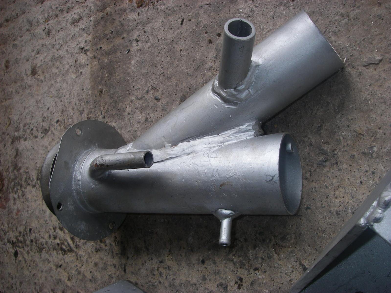

What about a simple inverted "Y" piece, where you could shoot the fuel into either filling neck, leading down to the respective tank?
Seems a whole lot easier, and could be fabbed up pretty easy I guess.
Gra.
it can and has been done Graham but if you need to pay someone to do it then you will not save a lot if anything and may end up with an inferior solution compared to the OEM part.
Like this
May be made out of exhaust pipe tube?
Wouldn't cost me £2.00 each over here.
Gra.
How about a pair of these
£2.00 each
Then cutting the down pipe off the one, and welding it onto the other one, suitably prepared with the required opening.
For that price, you could buy half a dozen to "experiment with"
Gra.

I'm sure you could knock something up along those lines Graham.
