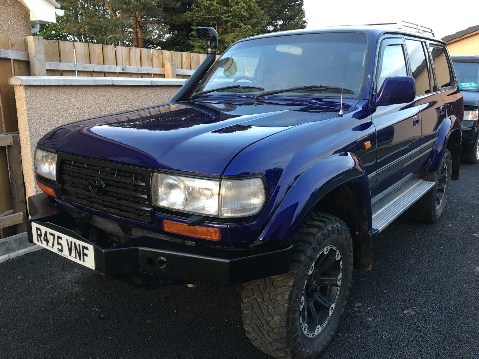

Long story short i was in a bad mood , forgot this truck doesn't yet have wheels offset enough to prevent paint being scratched until after i scraped my way against a concrete pillar out of an underground car park where i'd been boxed in .
Not in the mood , its a problem for another day i stopped at halfords on way home and lashed some of their piss poor rattlecan paint on and forgot about it .
Weeks later google finds me a shop that will mix Toyota 202 astral black and while there i noticed cutting compound on the shelf , :think: i've tried everything and i'm never happy with the result but i've always used halfords cutting compound with my Maguiar's machine , gimme some of that .

It came with a free polishing pad to which is far and away better than any i have used before , i actually turned the speed down from 6 to 3 , it took a while but who cares when you know your gonna get the result you want :thumbup:
Awesome results Shayne, that's it now when you start you won't wanna stop.
When you get it all done apply a good quality wax, it'll help keep it shiny and seal in your good work.

I'm probably going to swap or modify the flares eventually which is why i sprayed it with halfords paint in halfords car park with all the caution of drunk 5 year old but it should be noted that i only went out to test the new cutting compound so its still halfords paint .
@Chris , its taken me a lot of trial and error to work it out but i know now the paint has little or nothing to do with the finish , lash it on (even with a paint brush) and sand it off until it shiny is the principal , 1200 wet and dry paper is the finest i can get locally but that stuff i the bottle is 3000 grit so more than twice as fine but still sandpaper in essence .
A quick look at the Cartec website shows they go as fine as 9000 which probably isn't abrasive enough to clean your teeth with but no doubt leaves a mirror finish if you spend the time .
