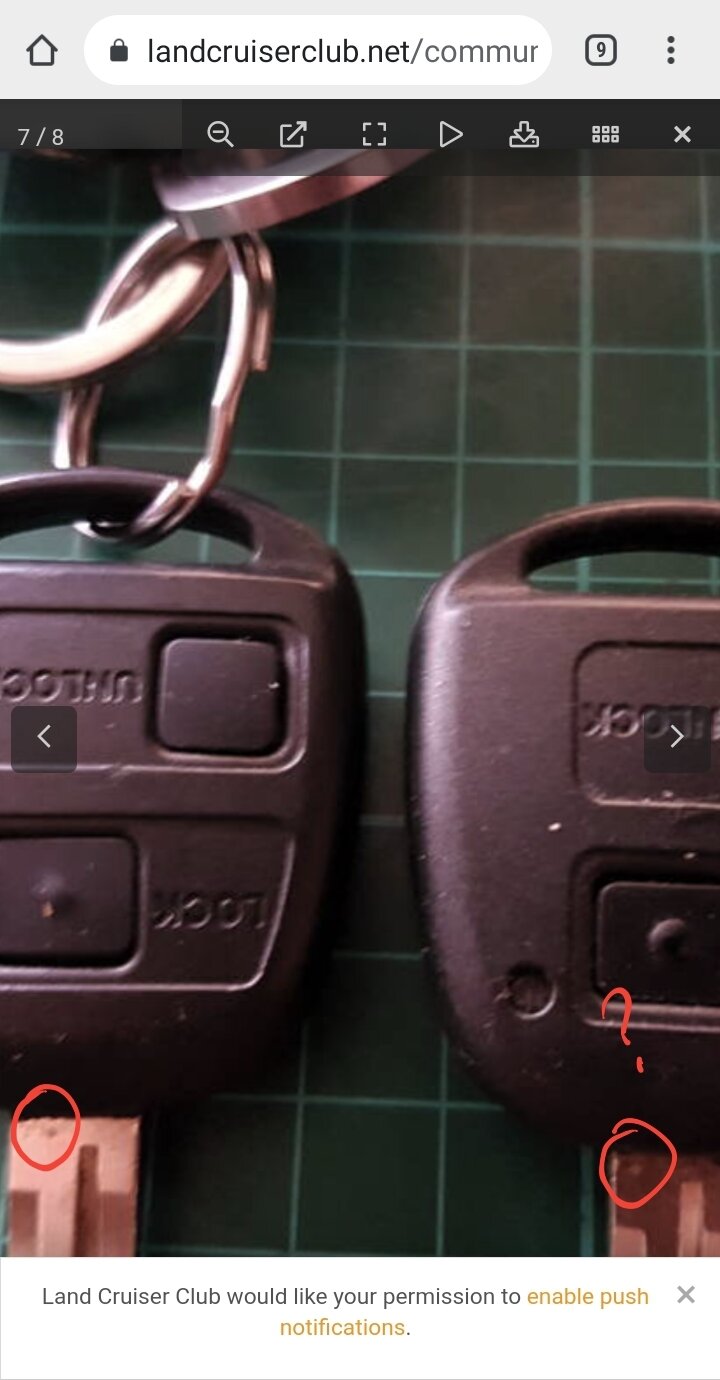

I think the one I've got is a genuine Toyota spare. It's a full key, not just the fob bit, looks the same as the original and has the Toyota logo on it. Not that that's any guarantee of authenticity. The £3 eBay ones probably come with whatever logo you fancy..
If its got a dot near the top of the blade (near the plastic bit), I think its probably genuine.
Nope. No dot on either key. So, if you're right, that means my 'proper one' is a copy too.

Re the dots on the keys: yes, now I see there are two very faint dots. I didn't even notice them before. they just look like your everyday scratches or dents. But there is one on each key. Though not in the same place.
