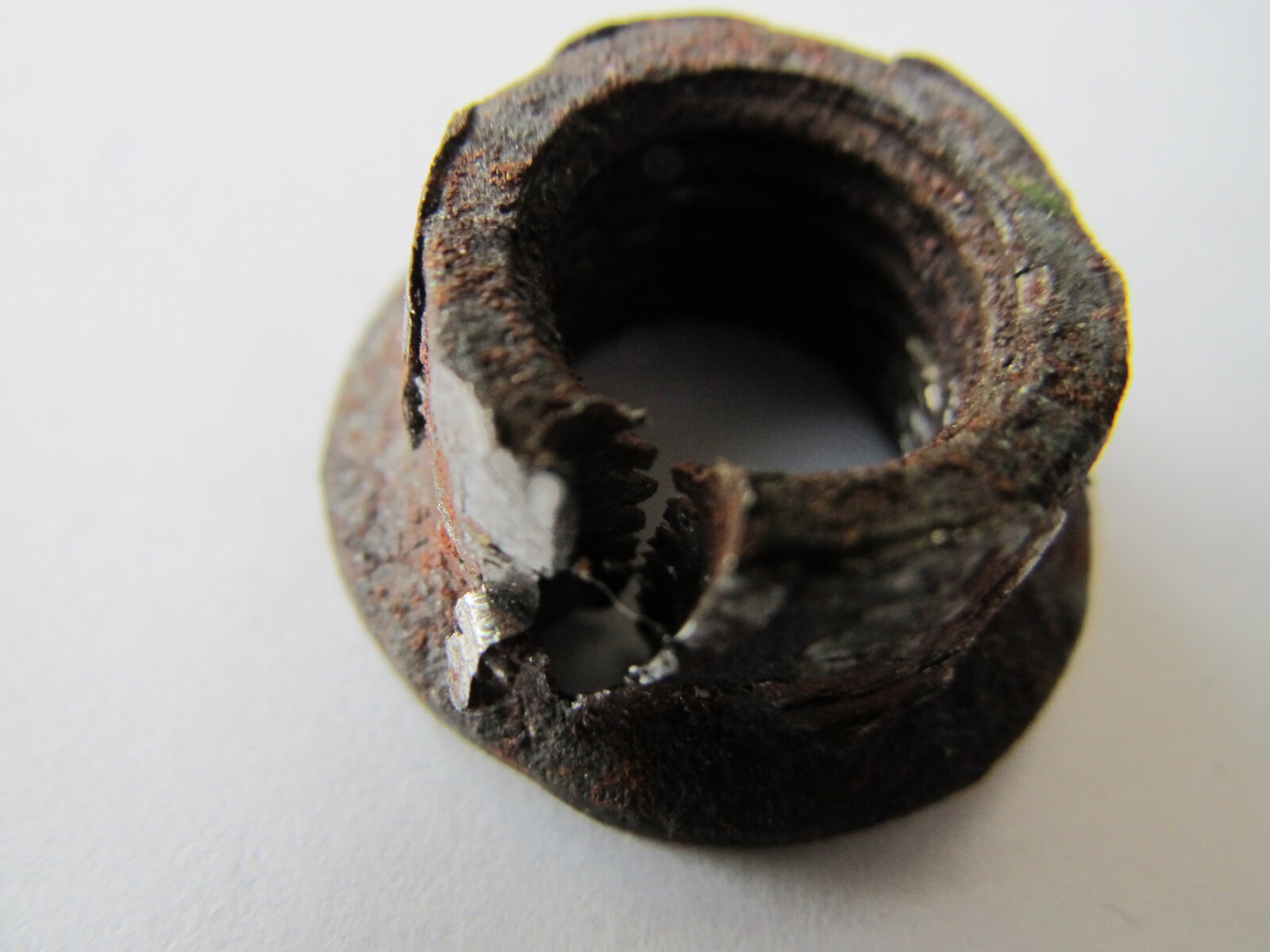

So you've rounded off a 14mm nut and cannot get heat or a wrench on it etc. Drill a hole down the wall and drive in a tapered wedge. The pic is a 14mm but I did a 1 1/2 inch AF one once down inside a long crank shaft pulley.
