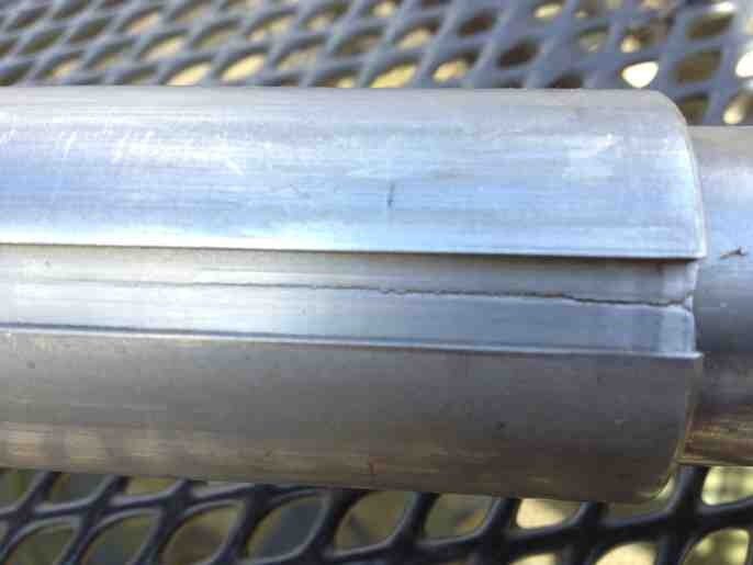

For those who use there OEM jacks just check it out next time you use it as I found a nice long crack in mine yesterday.
It's on the second extension in the guide slot and runs for a good 10cm or more.
