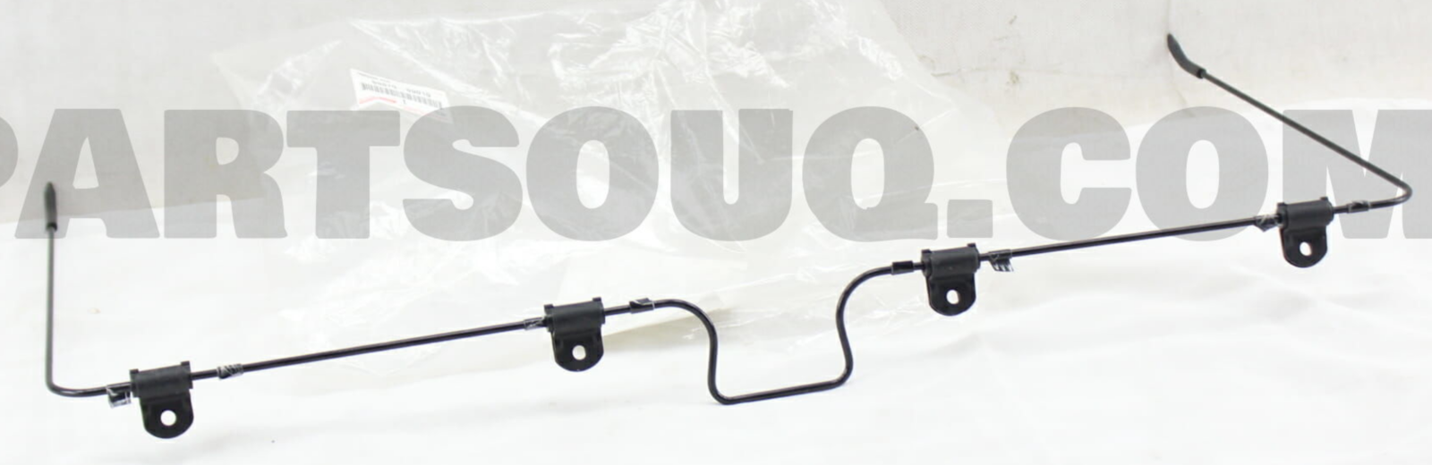

Hi,
Any chance of posting a photo of the part that's broken, as I'm not to sure where the lower torsion bar is, I know where the front suspension torsion bars are.

Hi,
Edit, I get the picture, I understand what it is now.:thumbup:

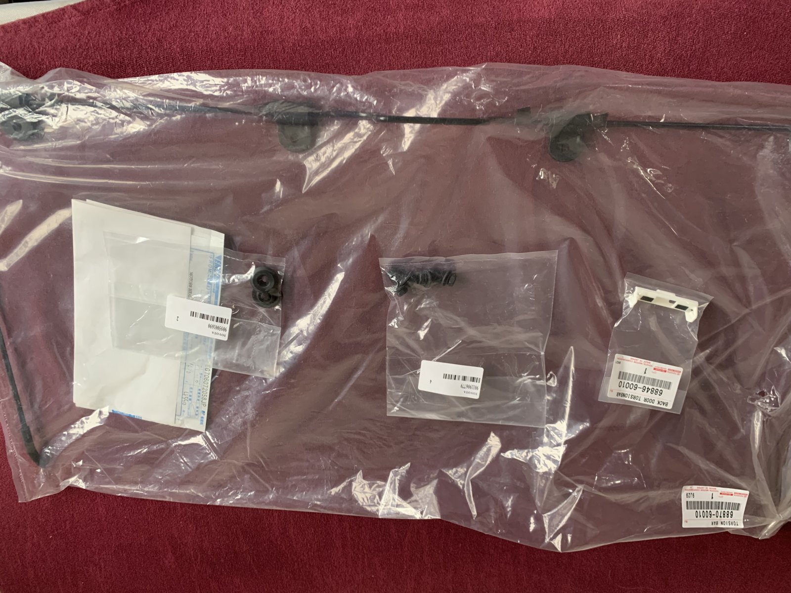

Cheers https://www.landcruiserclub.net/community/members/uhu.5802/ and https://www.landcruiserclub.net/community/members/jibberjabber.20133/ - apologies for delay in getting back to you. Picture of the issue.
Thanks for the confirmation re removal of rear bumper skin - new parts ready for action....
