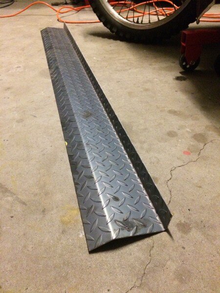

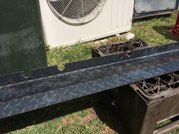

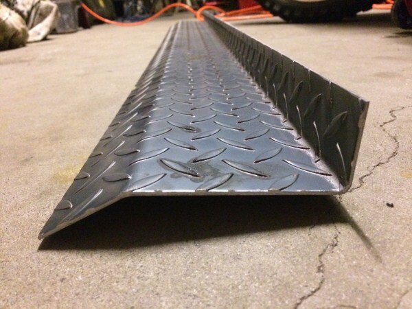

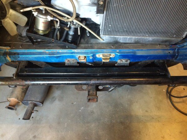

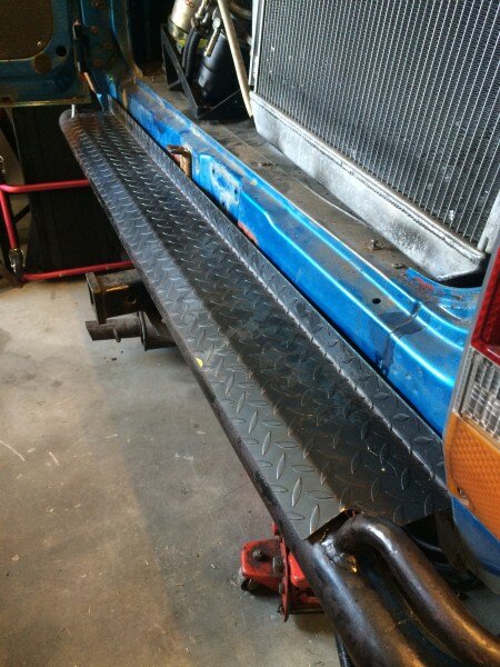

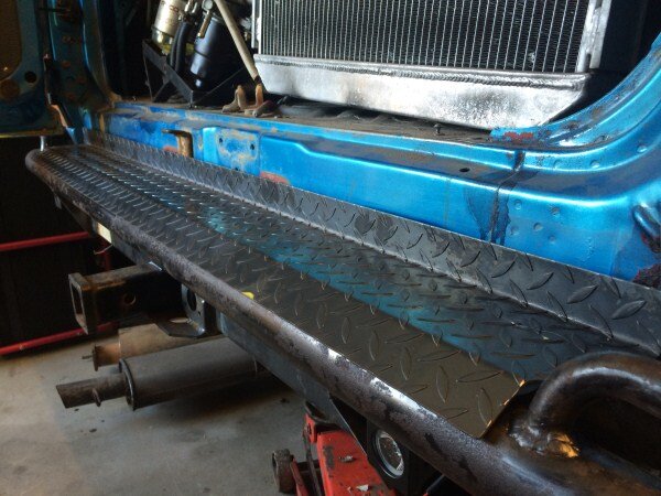

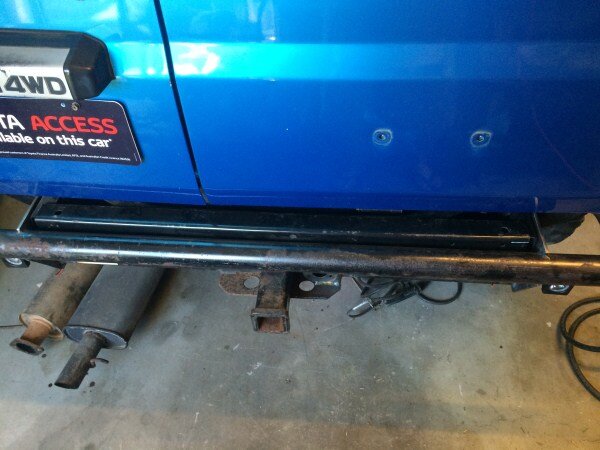

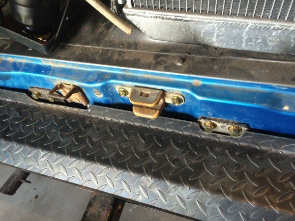

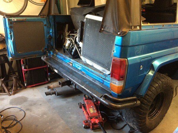

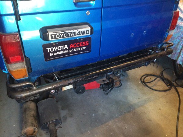

A few weeks ago I did some more work on the rear bumper. :icon-cool:

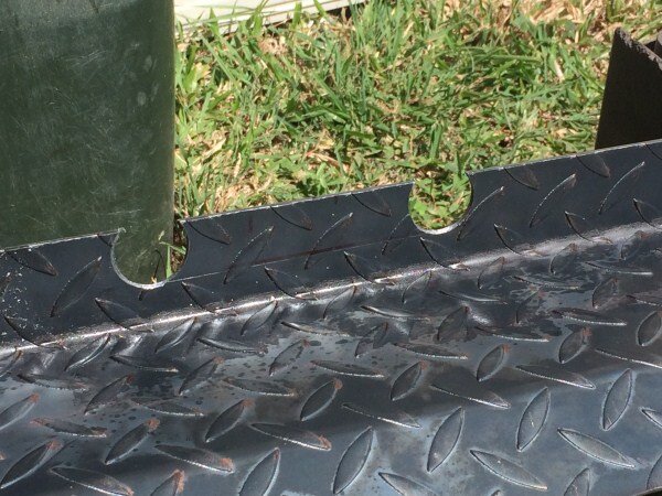

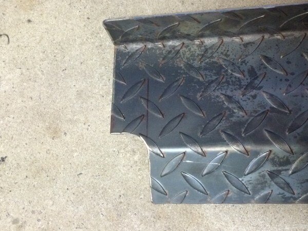

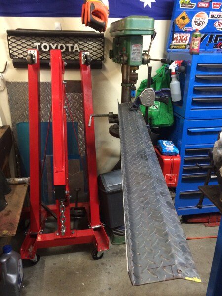

I got some 2mm checker plate cut and folded.

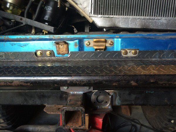

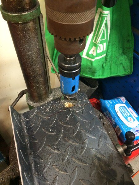

Put a hole saw in the pillar drill and drilled a hole in each end of the checker plate.
Cut back to the hole from both sides with the angle grinder.

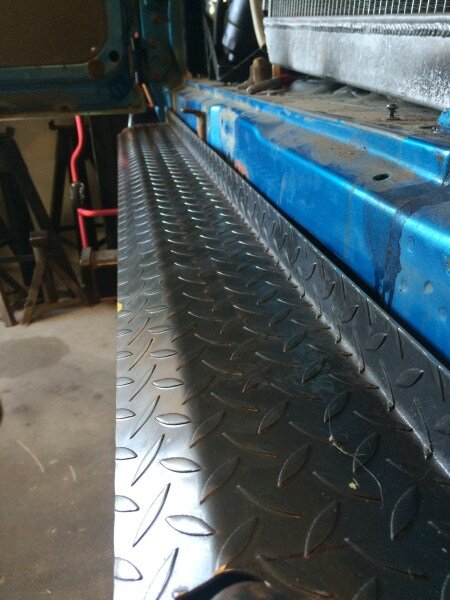

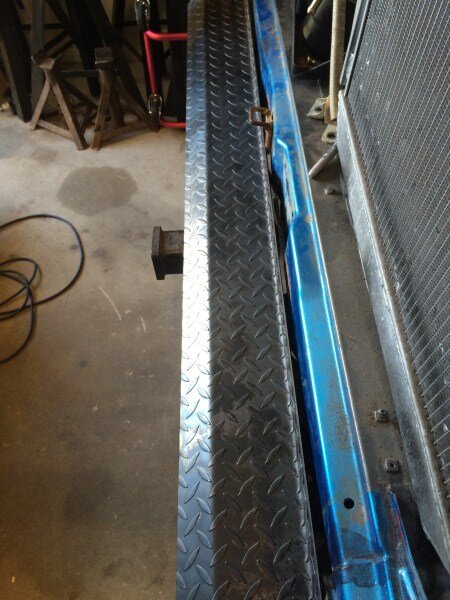

I wanted to tack weld it in position next on top of the bumper.
Had to remove one of the rear doors to allow me to get the checker plate into position.

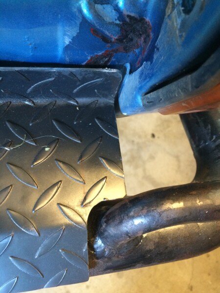

Had to put a few holes in the checker plate to allow the checker plate to fit closer to the body, around the bolts holding the fuel tank on.

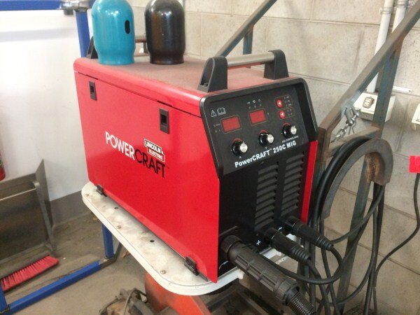

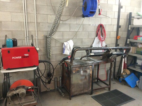

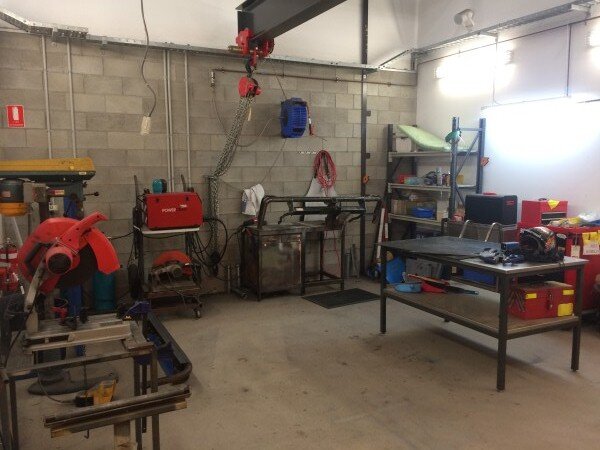

With the checker plate tack welded on, I took it to work and used the MIG to fully weld it.
I still need to do a bit more work on the rear bumper and bullbar then they can be shot blasted and powder coated.

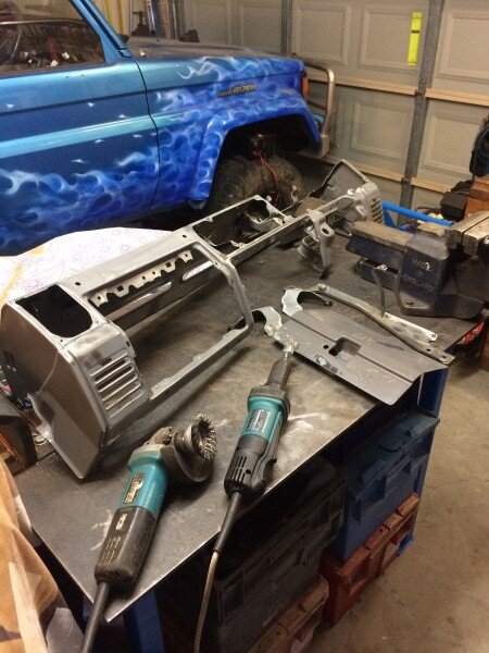

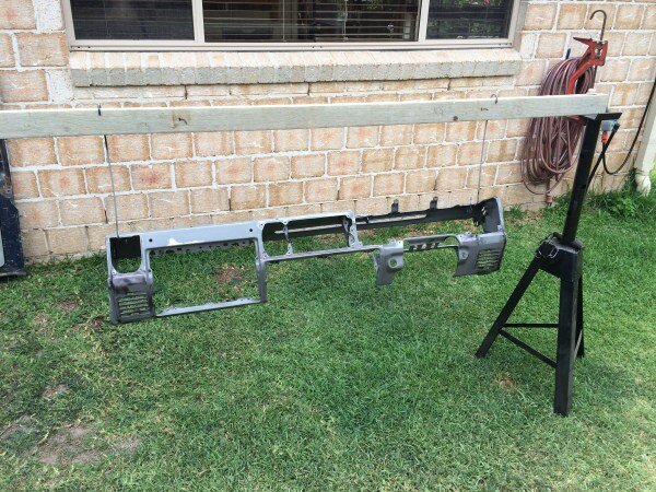

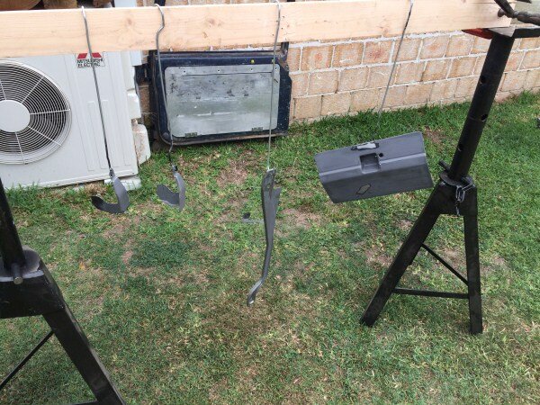

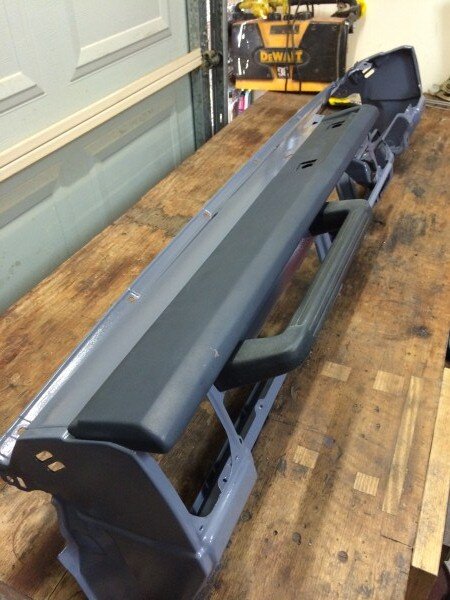

Did a bit more on project RJ last weekend. :icon-cool:

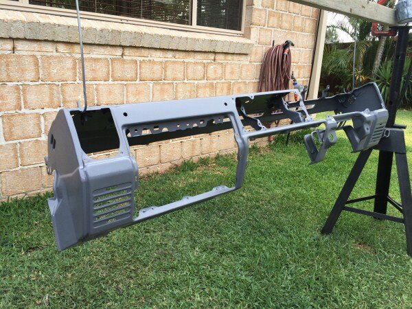

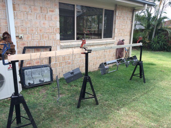

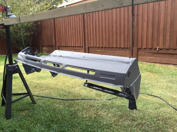

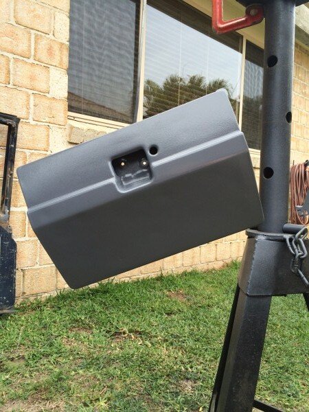

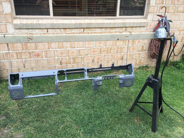

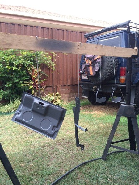

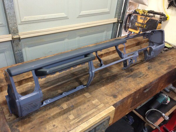

Decided to push the project forwards a bit I would paint the dash rather than getting it powdercoated.
Cleaned all the surface rust off with the grinders.

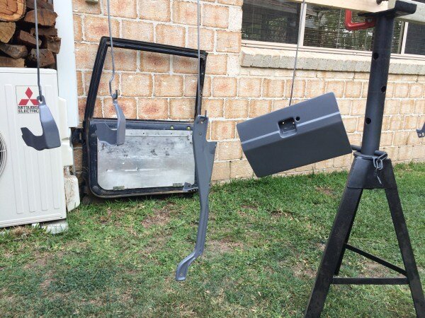

I then got the parts hung up outside.
Picked up some enamel paint that looked like a pretty good colour match.
And got spraying!

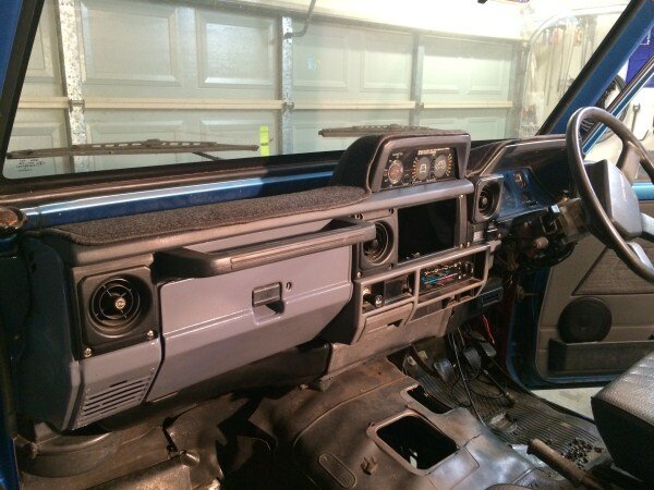

The next morning I got it on the bench and started bolting it all back together.

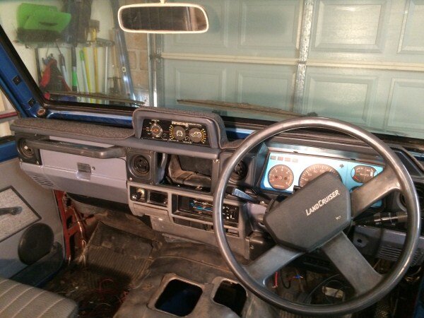

Got it back in.

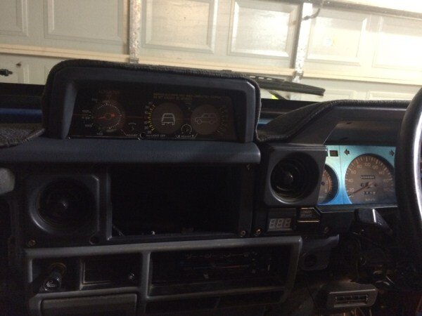

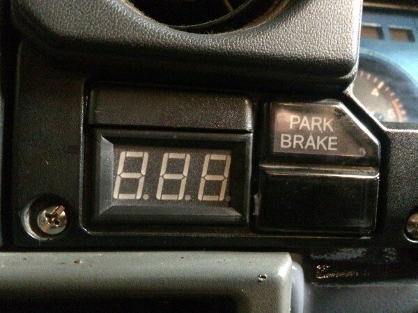

Inclinometer fitted.
Engine temp gauge fitted.

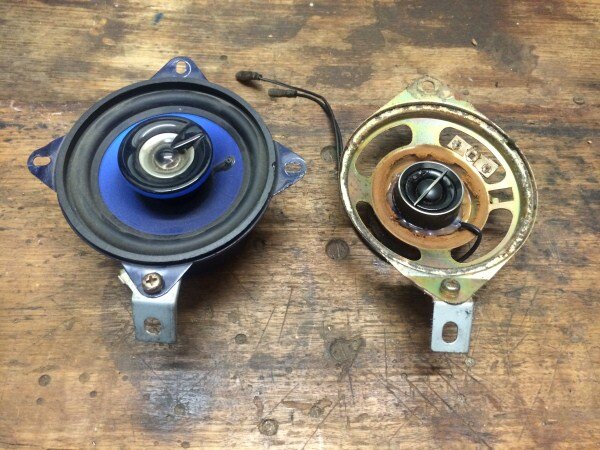

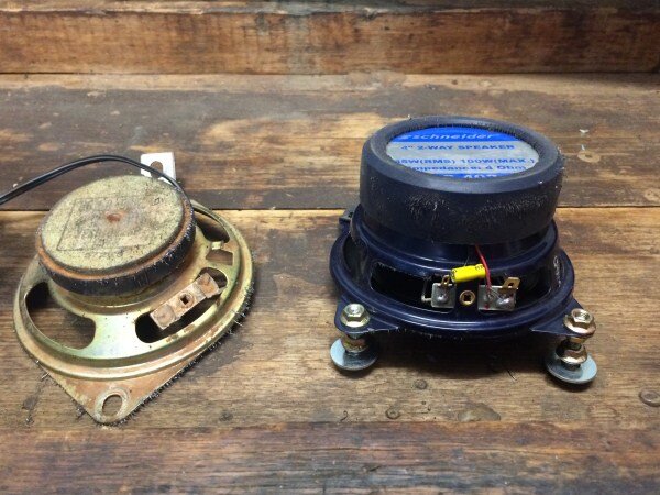

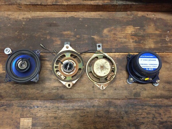

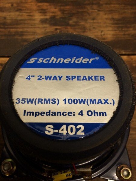

I found some replacement front speakers I'm going to fit.
Much bigger and more powerful than the originals.

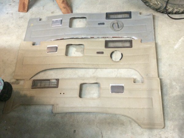

A mate gave me a set of rear door cards/trims for the back of RJ as I didnt have any. Sadly they are brown, but I thought I could always use them as templates to make some new ones. :think:
But then I got given a drivers side by a chap who bought one of the gearboxes off me, so now I just need a grey passenger side one.

Nice paint job on the dash Ben, is it just the one coat you gave it? You really need to sort the instrument pod out now lad, that blue stands out like a wart now
Thanks mate. :thumbup:
I gave the dash 3-4 light coats. It probably wont be as tough as powder coating, but it will do for now. :icon-biggrin:
:lol: The blue instrument cluster will be sorted out soon. :icon-wink:
Hi Ben,
How are those new speakers going? I need to replace mine so might look for something similar.
Don't need anything too fancy but I think I have 25 year old original issue speakers in there now.

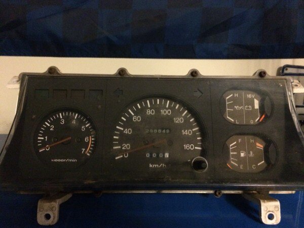

Today I got a new instrument cluster so I can ditch the garish blue one.

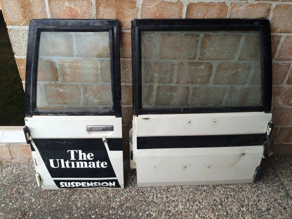

And last week I sourced a pair of rear soft top doors. I didnt really need them but I know how rare and hard to find these doors are with the removable tops. :icon-biggrin:
Thinking if I dont use them I could always sell them to the mid wheel base 73/74 series guys because as far as I know they didnt get the doors with the removable tops, so when they remove their FRP roof to drive it as a soft top, they still have the rear glass/windows sticking up on the back doors and it looks silly! :think:

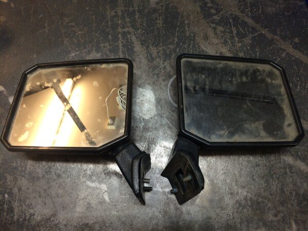

I also got some mirrors, again because they were cheap and the other ones I bought didnt come with the rubber that sits between the mirrors and the door, so I'm thinking of using the other ones on LJ and these ones on RJ. :think:

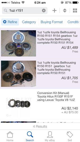

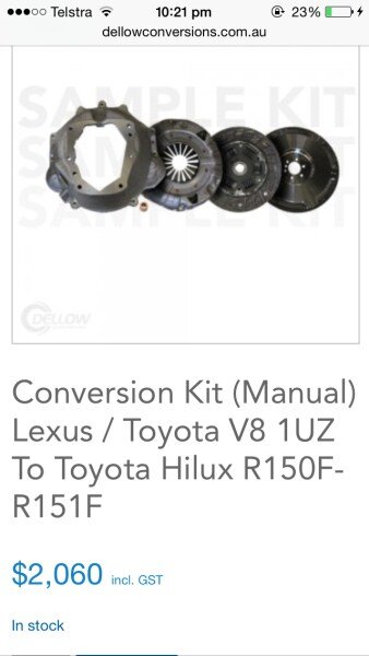

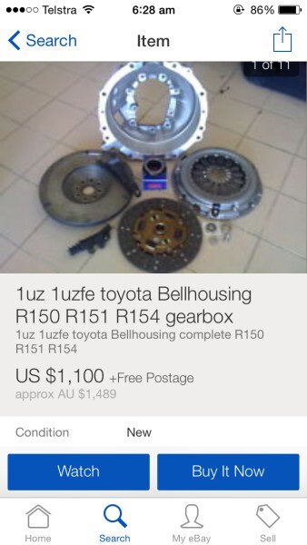

So this week I will order the bell housing/conversion kit. :icon-biggrin:
There are 2 main options.
Dellows in Australia is the more expensive option, but you get to choose which side of the bell housing the clutch slave cylinder sits on.
Or the KS Racing one from Thailand which I think is the one I will order for $1500!
I've got 10 days off over Christmas so hoping to push this project forwards then. :icon-cool:
Hi Ben,
Dash came put flasher than a rat with a gold tooth :clap:
:lol:
Speakers are going good but there not in yet.
I've bolted the brackets onto the new speakers and now I just need to bolt them in position behind the dash. :icon-biggrin:
Fingers crossed they fit as the ducting pipe for the heater is very close. :pray:

Well I've resisted the temptation to spend the engine conversion kit money on a Honda XR600 that I've found and I'm going to order the kit today or tomorrow. :shifty:
Just waiting to hear back from the seller as to what figure he will write on the customs declaration, because if he puts over $1k I will have to pay import duty and charges and then the Australian kit from Dellows may be a better buy. :think:
