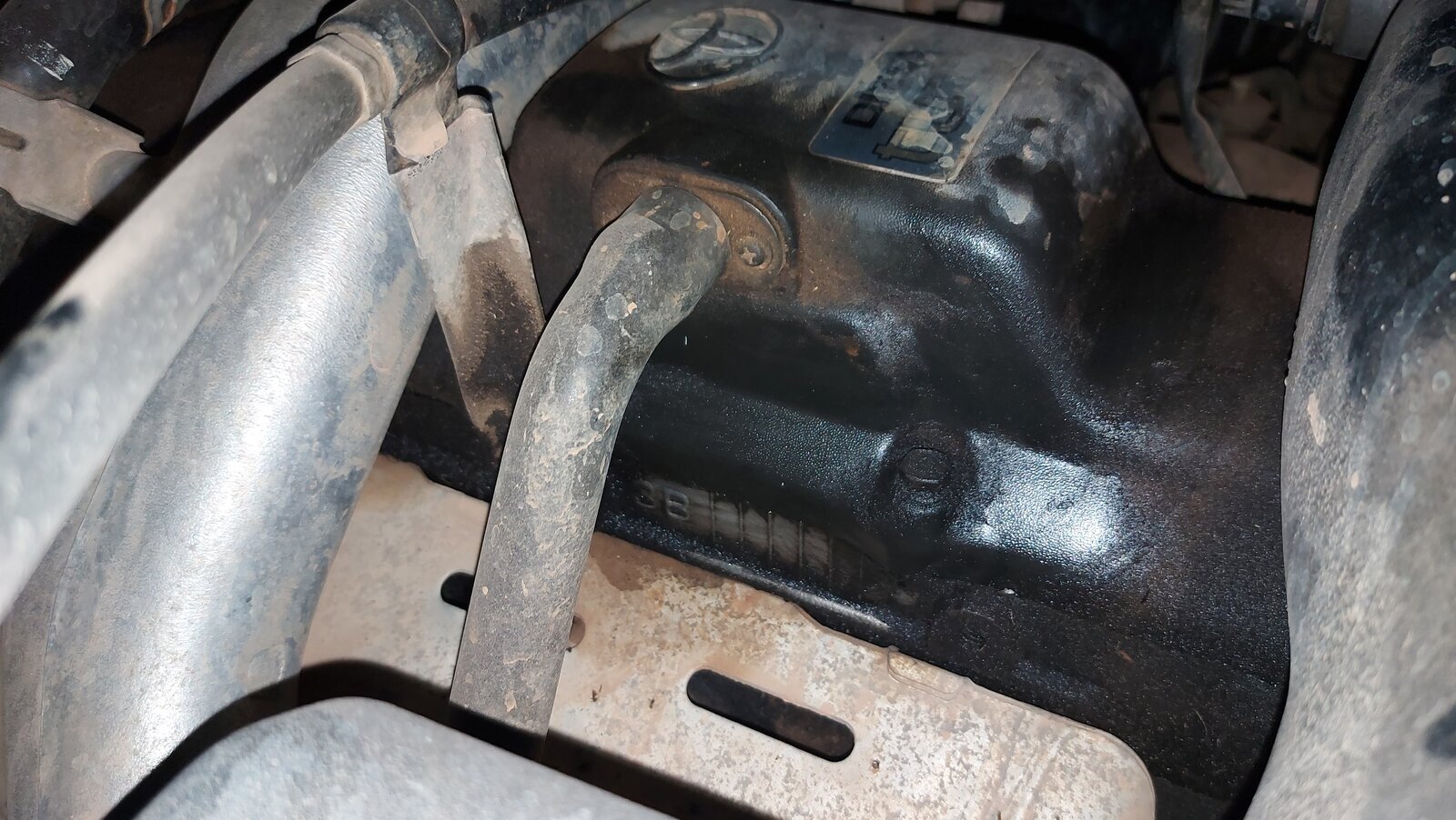

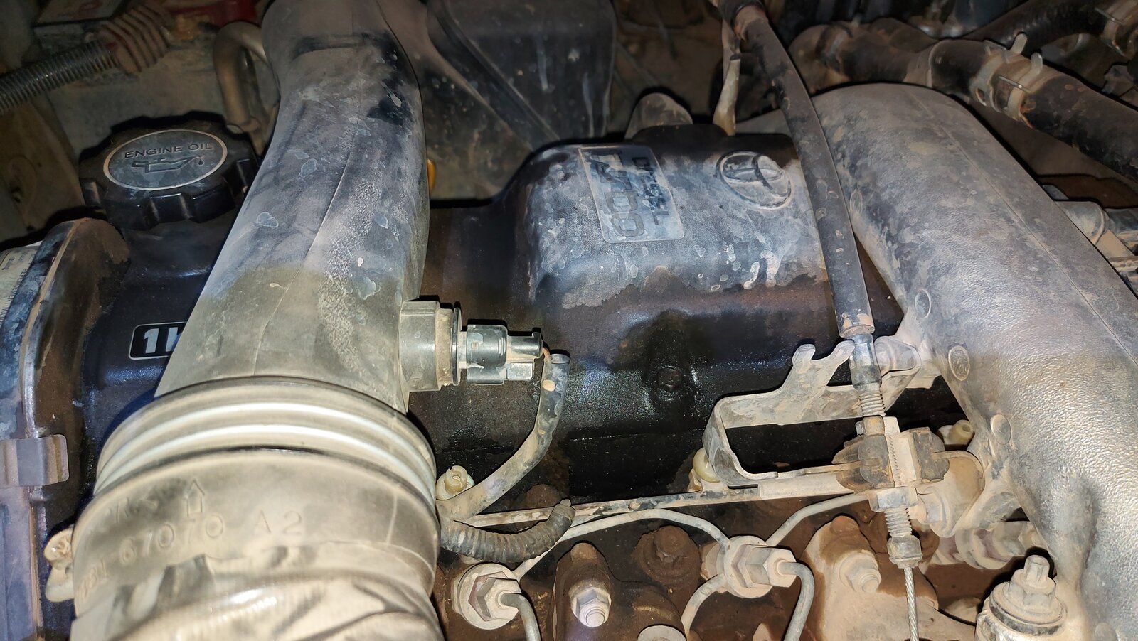

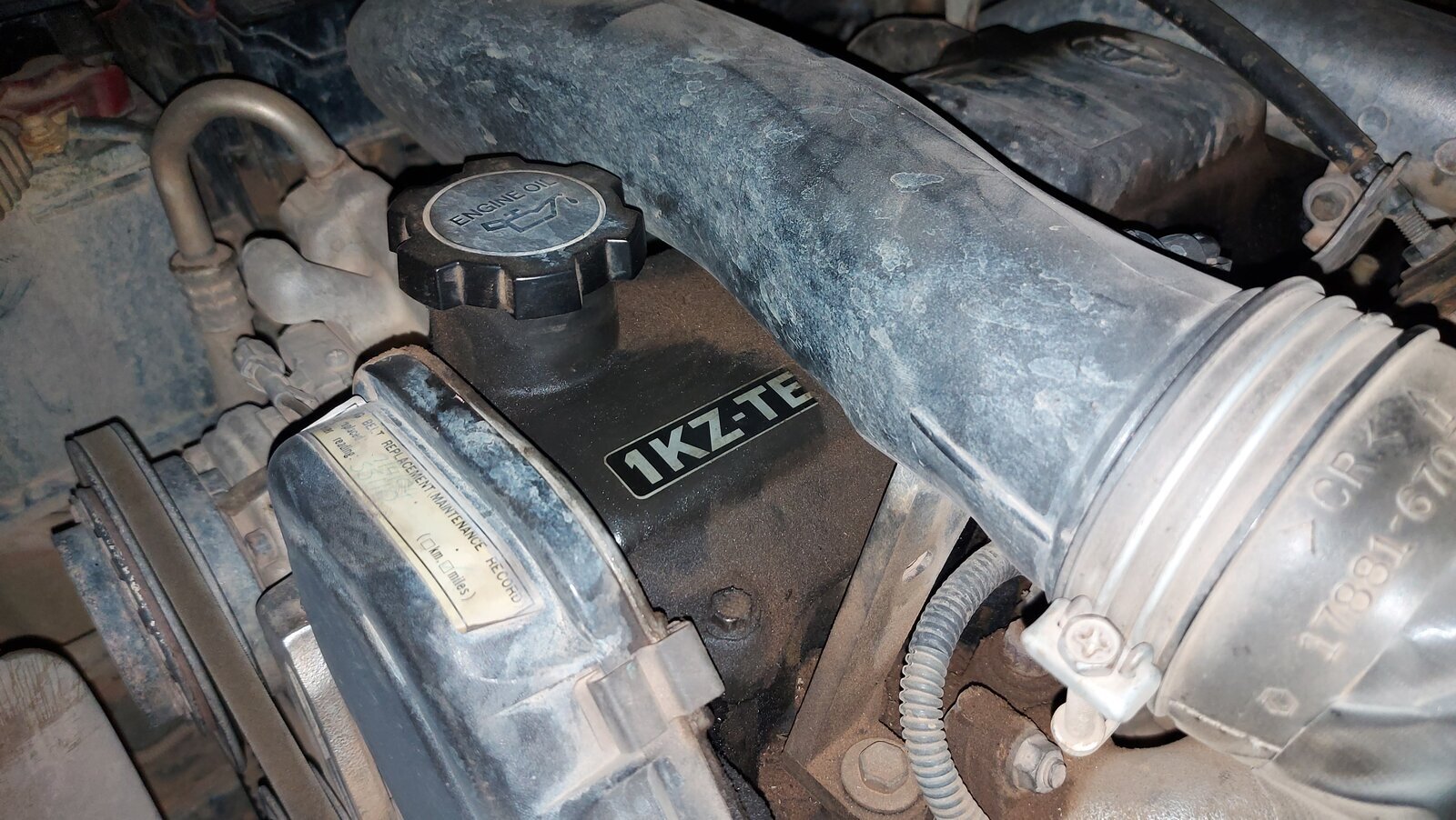

Hi all, is looking like I need to replace my rocker cover gasket on my LC Colorado 3.0L diesel (1KZ-TE) as there's a huge amount of leaking around it. She's also been losing oil recently, requiring small top-ups every few weeks. She on 244,000 miles so she's done well to get this far I think!
Please can anyone advise if this is a big/ difficult job as I've done lots of suspension work & steering work on the cruiser before but never touched the engine. Is there anything I need to be careful of so as to not cause serious damage?
Also, I'm ordering the gasket from RoughTrax; do I need to order any silicone gasket sealant for the job too?

Hi - it's not a big or difficult job. Clearly, you have to remove the aluminium and plastic intake pipes and a few cables and brackets to lift off the cam cover easily, but nothing tricky. I replaced mine using a Roughtrax gasket and did not use any sealant around the gasket, but I do have slight leak again, so I'll use sealant next time.
You do have to use sealant on the half- moon plug at the back and the joint between the head and front cover anyway. I'm thinking I may have not done that bit correctly.
I'm interested to hear others' advice.
