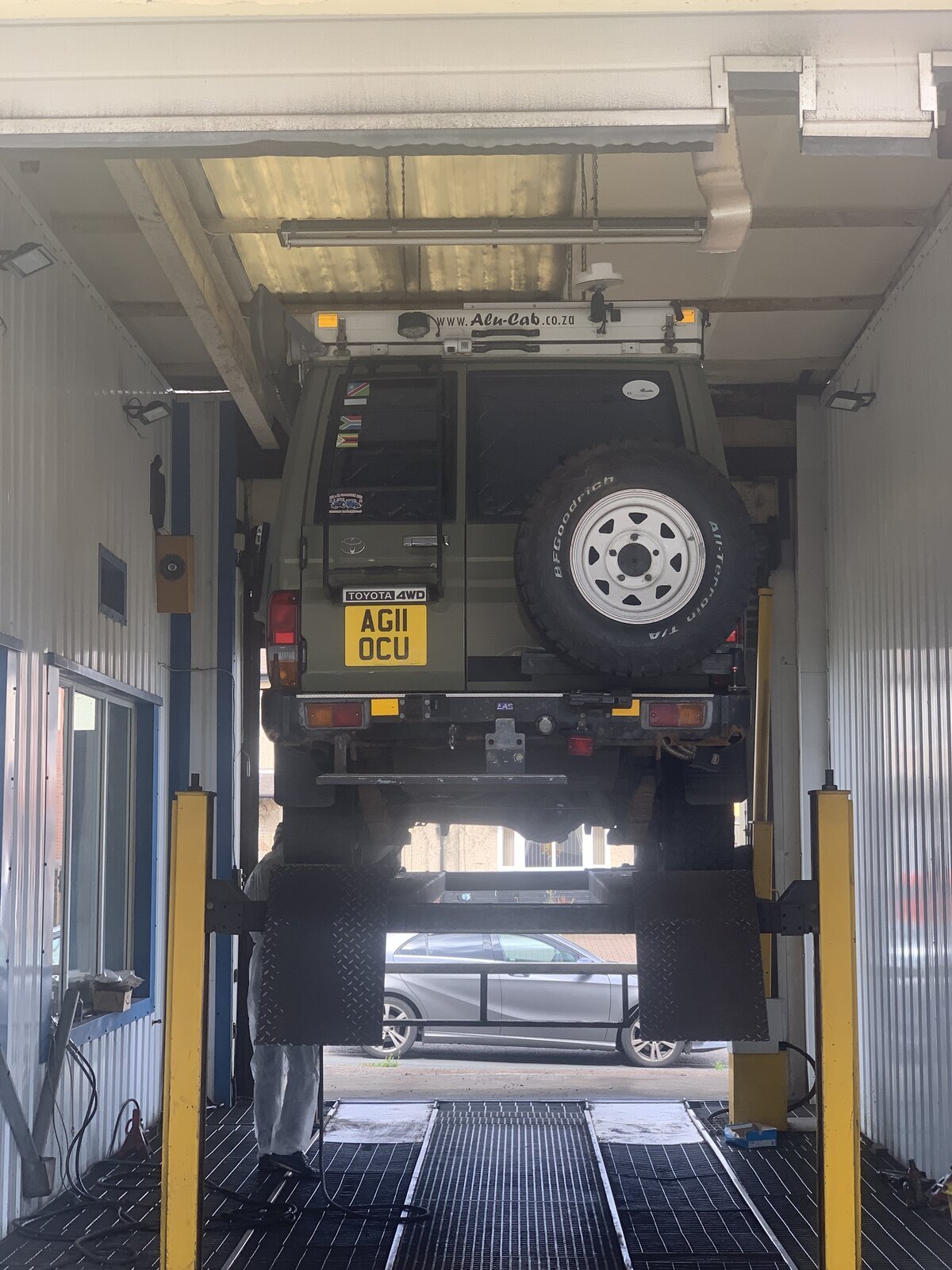

Mine at Krown a few weeks ago having a touch spray last done in 2018, on the whole I'm pretty pleased with it but the truck had zero rust when 1st applied

That’s a lot of work you did to maintain. I gave the car at Krown n it’s a 3 hr wait. As mentioned if it’s stopping rust at its current position, it seem to be good alternative with a recoat every 2 years
I know lots of people recommend Krown but I'm a bit sceptical that they can do a really through treatment in just 3hours, especially on an older vehicle. Also their own description of their preparation seems like it's intended for fairly rust-free vehicles.

It took a lot longer than three hours when I went to Krown. We had a full day at Dudley Zoo and Rob was still hard at work when we got back.
Realistically, there couldn't have been much prep in that amount of time, yet alone the treatment ?
