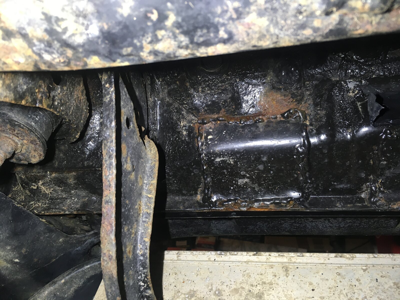

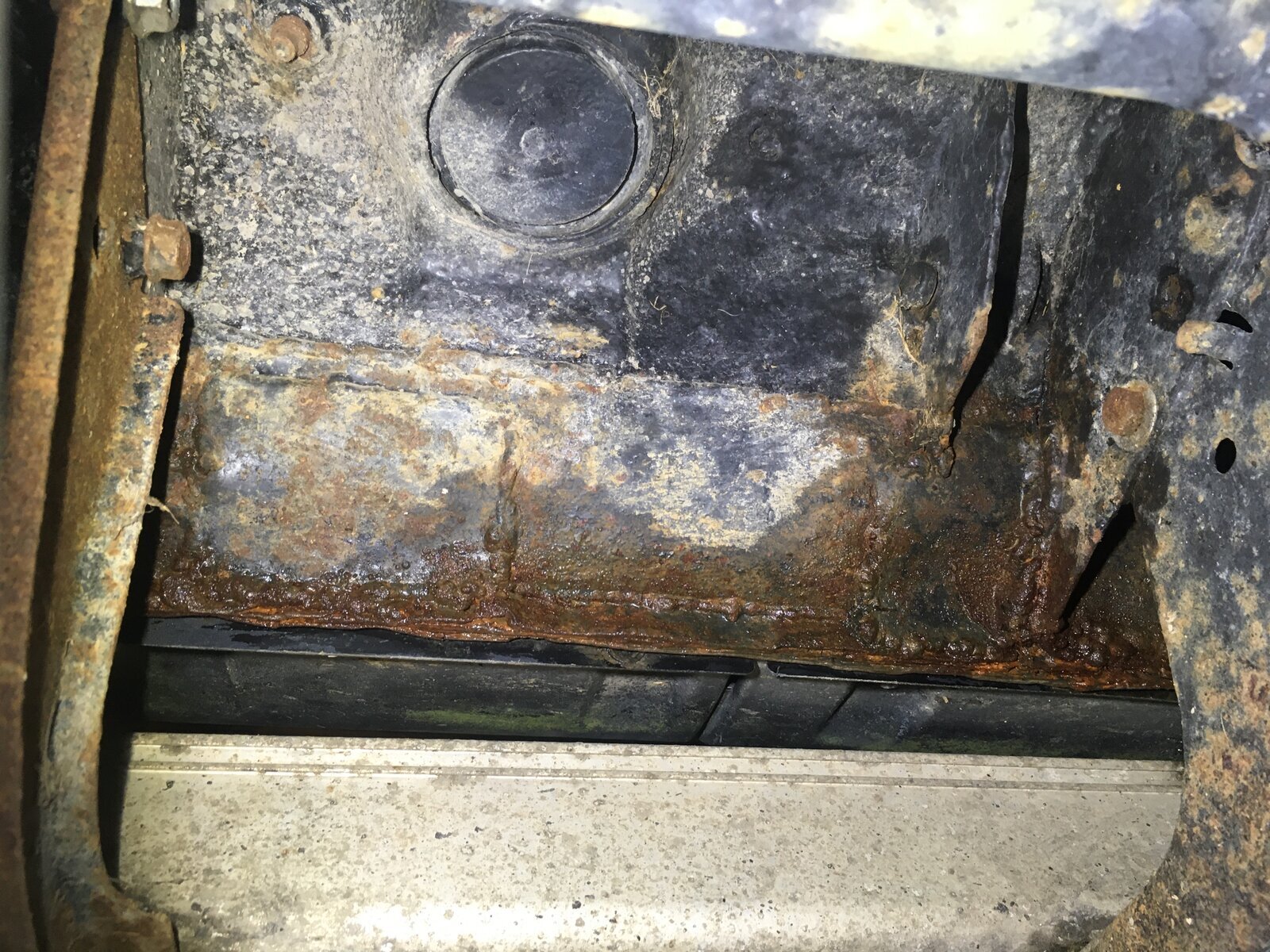

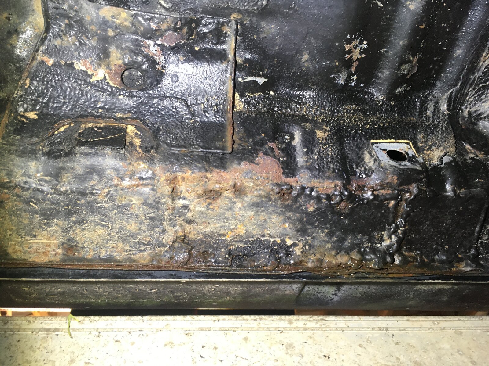

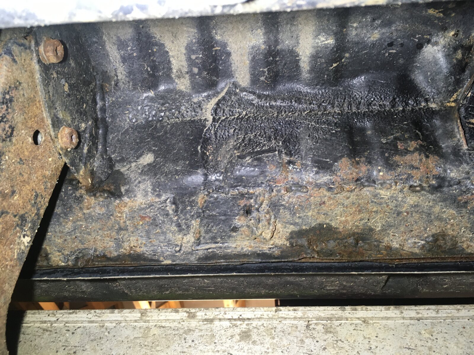

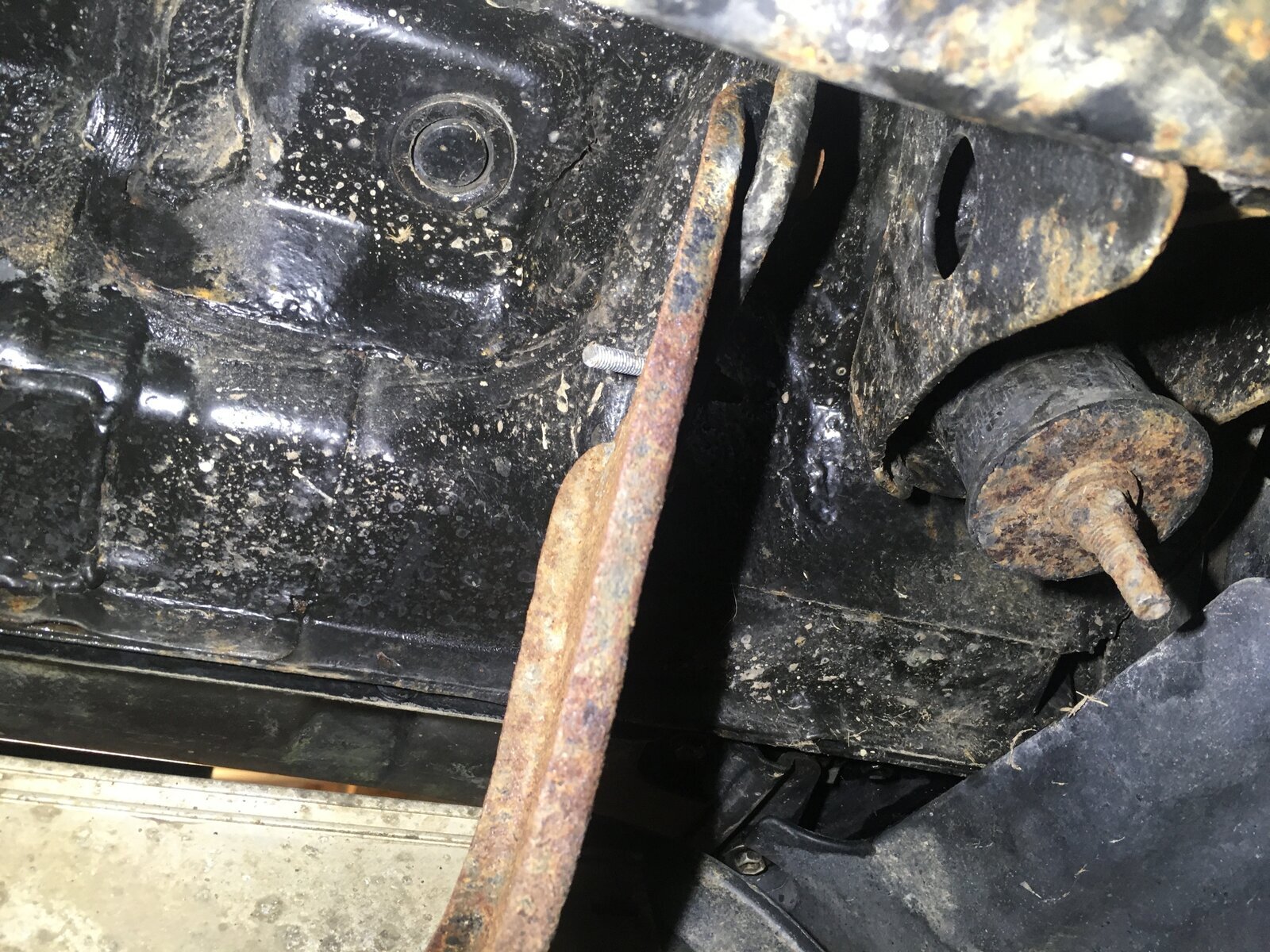

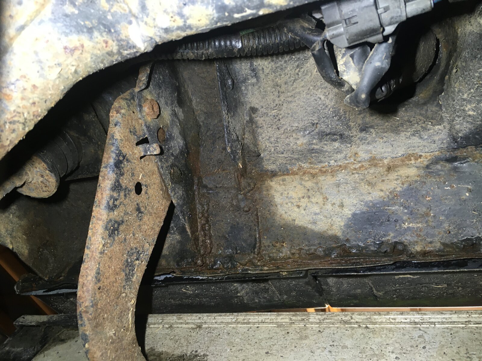

I got my underneath washed down today; So here's what my cills look like a year and a half after being fully cleaned down, patches welded in, and then treated with Owatrol rust preventative liquid and then painted with a couple of coats of Owatrol black paint. I think it's holding up fairly good, a lot of the paint is still there, it's gone in some places but the main thing is there's no new rust holes, it just seems to be surface rust to me. The bottom lip that's rusty in the pics isn't as bad as it looks I don't think, I can't poke a hole in it, I'll wire brush it down and see properly but I think it's ok. Do you folks think it's faired well in that time, or have you gotten better results with the other products mentioned in this thread?
I'm going to clean them down again now and give them another coat of Owatrol rust preventative followed by another coat of paint now for the Winter. The chasis, and rest of the underneath that was also down a yr and half ago is looking well imo and is good enough until next yr or such I think.
Unfortunately, my rear axle mount didn't survive and has succumbed to rust (see my other thread) I don't think I can blame Owatrol for this though.

Prep is everything. Poor or no prep, I.e. removing shite, loose or flaking rust before any treatment, and thoroughly drying out, will have it fester, burst out, and very quickly look like it was never done.
Depending on what materials used, a few hundred sovs might cover that cost, without any labour which if properly done, is intensive.
As a very basic example, what happens to all the shite thats in the chassis box sections? Surely that has to come out before spraying anything else into it? I dont see Krown or anything else working very well over 20 years of soil
