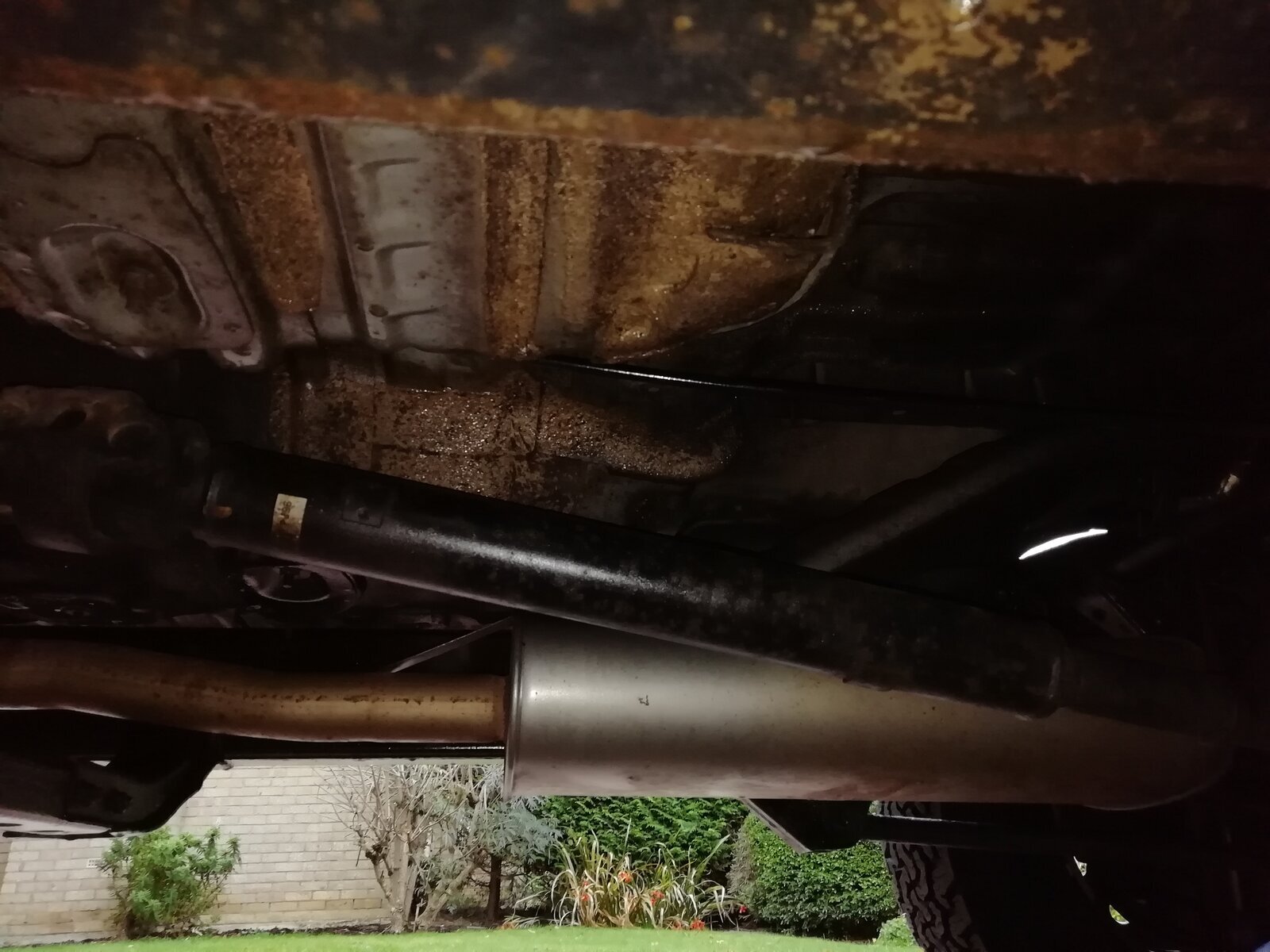

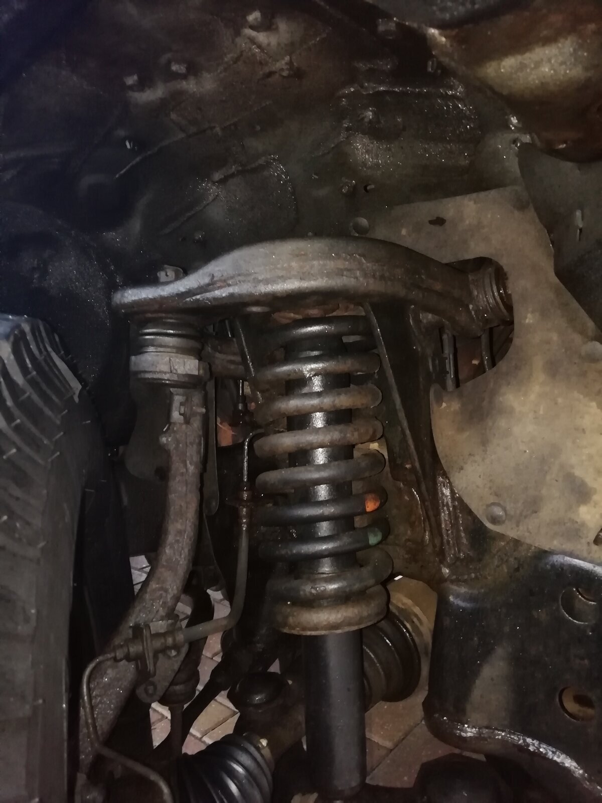

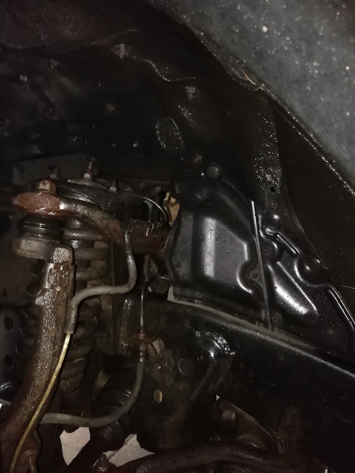

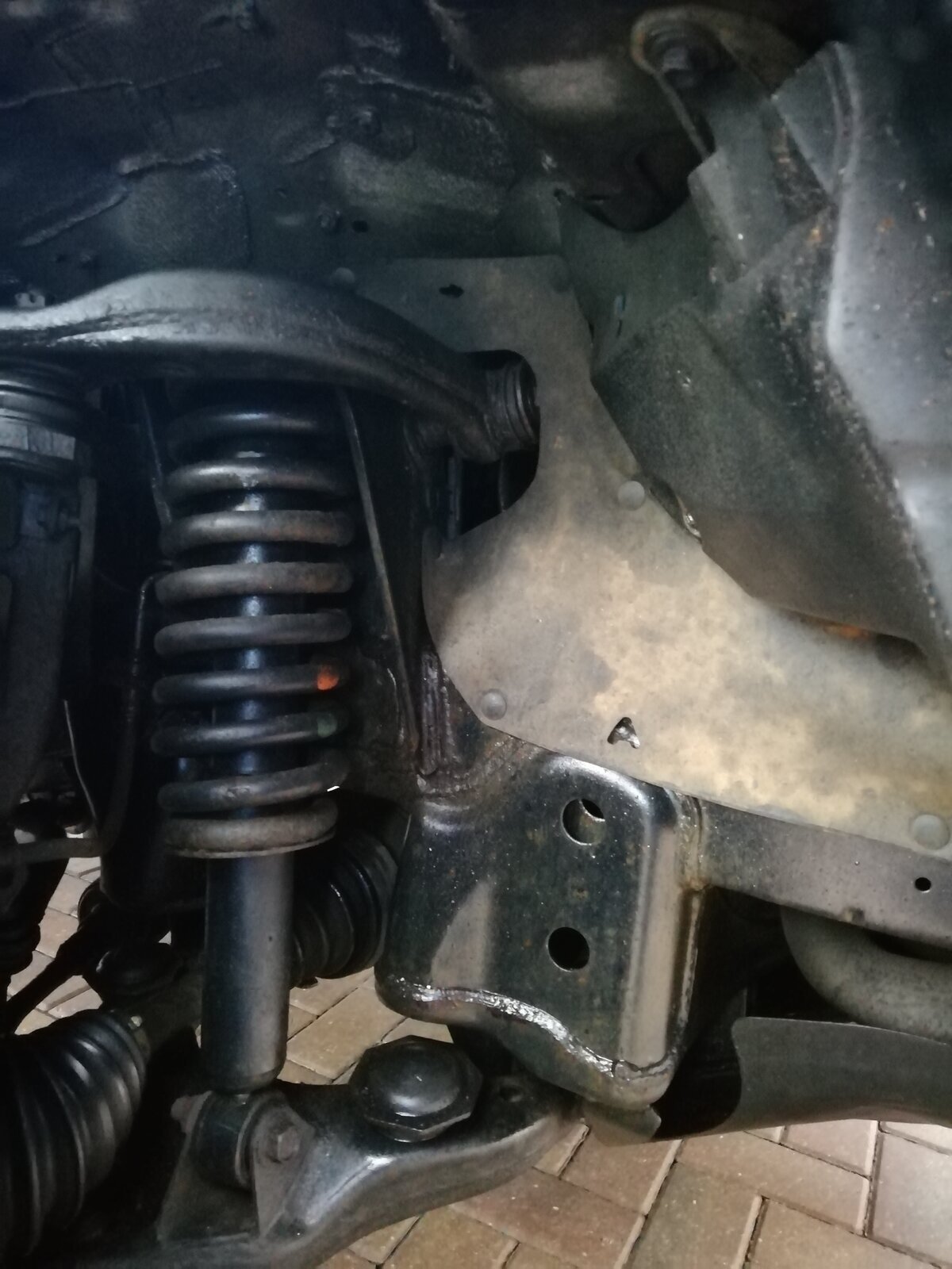

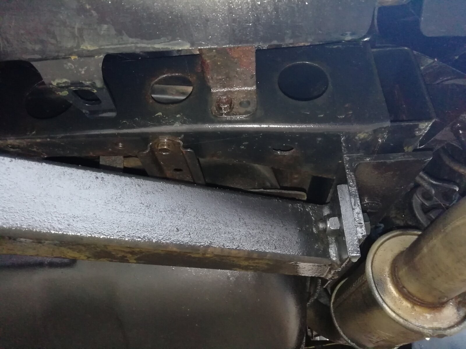

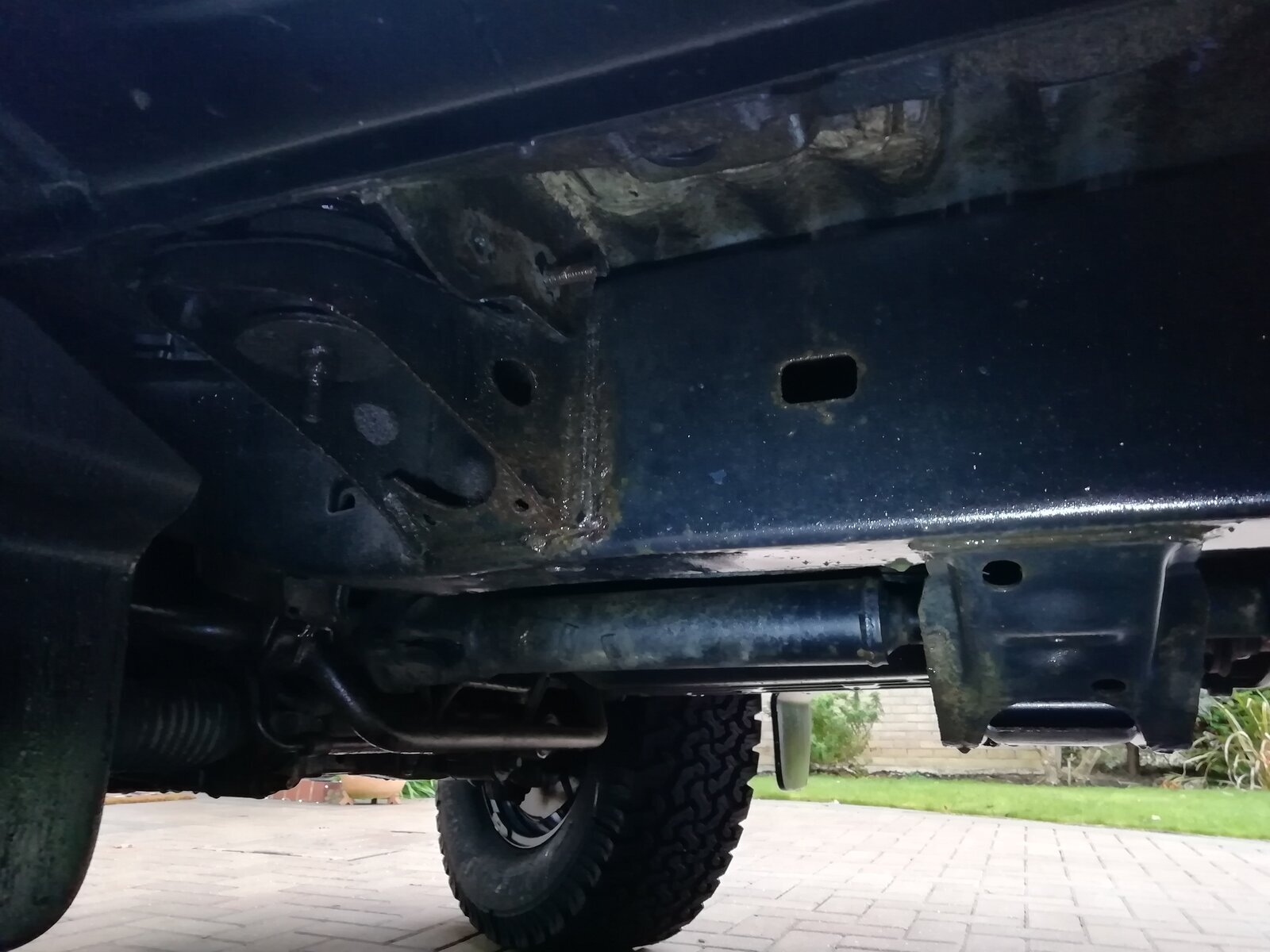

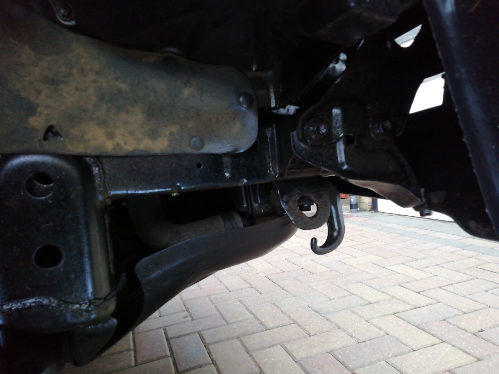

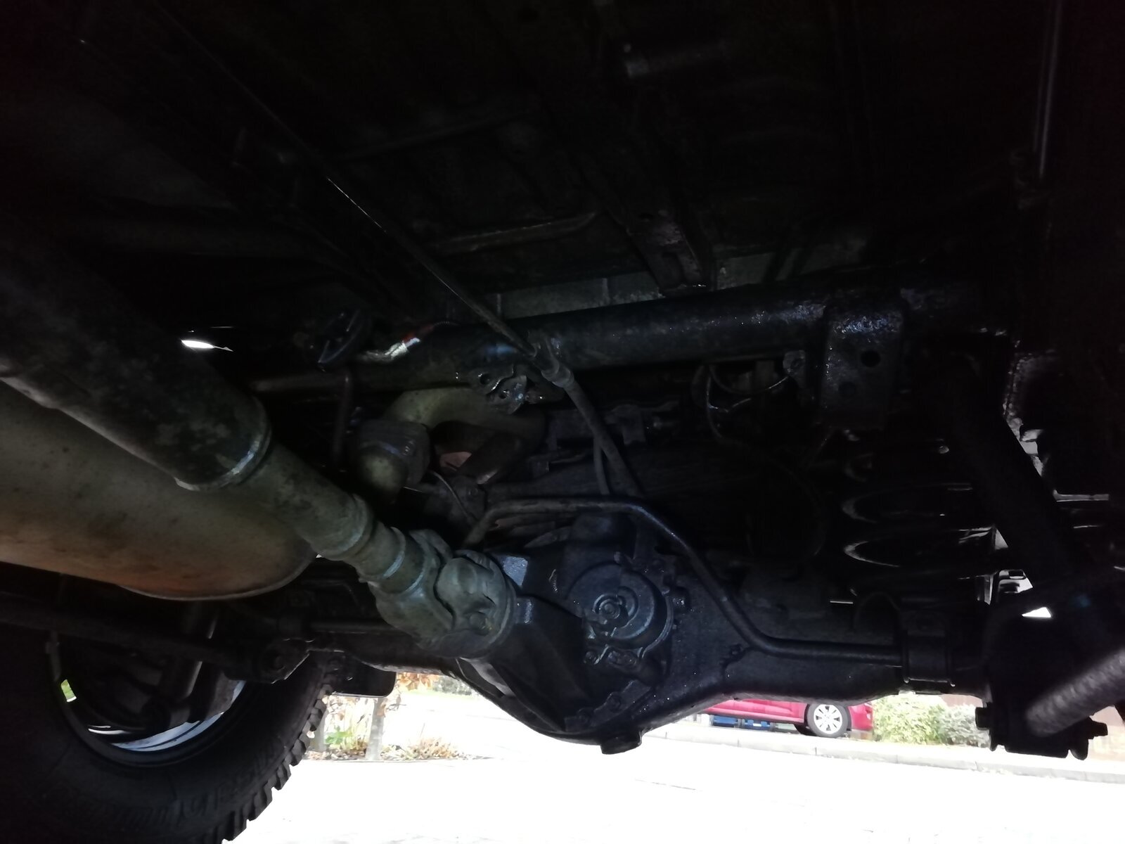

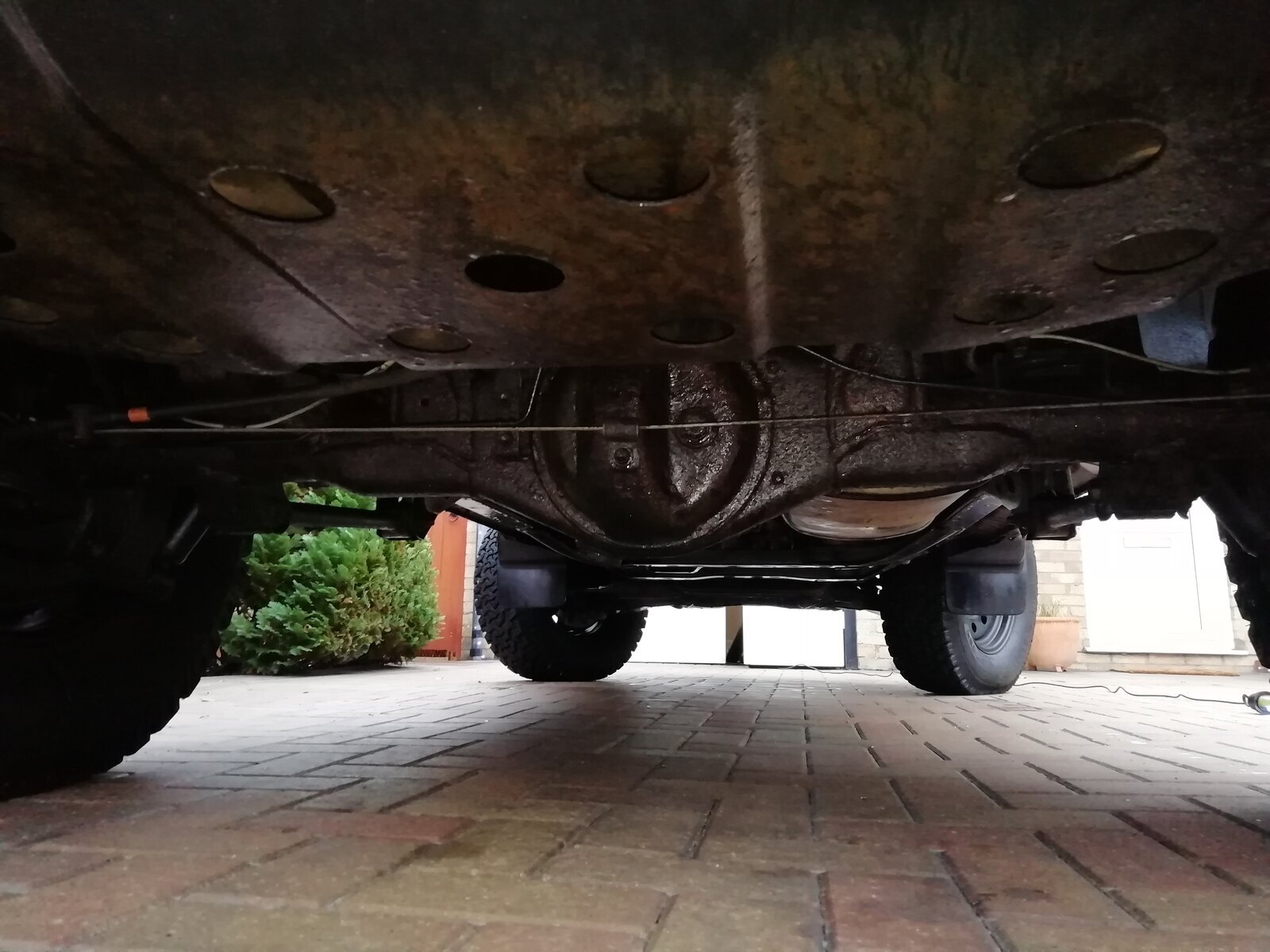

So I got over to Rob at Krown yesterday. Took just under 4 hours to do all the cavities and underside removing all access panels, lights etc. The rust is scored from 0-3 (0 being like new and 3 being severe rust). My Collie is a 99 FX so am happy to have received a score of 1.3 it would have been 1 except for the rear axle had flaking rust and a 30mm hole inside my front wheel arch under the headlight, not a failure but one to watch. I have a 6-month free check and Rob will respray the rear axle if required. He did ask what type of driving I did i.e. Normal, Off-Road etc. as more frequent application is required when off-roading because the mud when falling off can peel off the T40 solution (think that's what he meant). No apparent vapor inside the vehicle afterwards but the drive home was a little hairy for a while as the spray/mist can get onto the brake discs (Rob did warn of this). A few pics attached, not the best but I feel a lot happier this winter having spotted plenty of gritters out on the roads back from Birmingham. Stay safe everyone.
